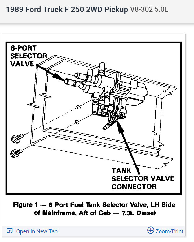

Does this truck have dual tanks? I have seen the fuel tank switching valve go bad and cause this problem. Also, I would load test the battery because if it is weak, it will cause the starter to stay engaged, this guide can help:
Here is the location of the valve and what it looks like.
On LH Side Of Frame Member Behind Cab
Note: OE does not provide an image location of the fuel tank selector valve for the gasoline models.
