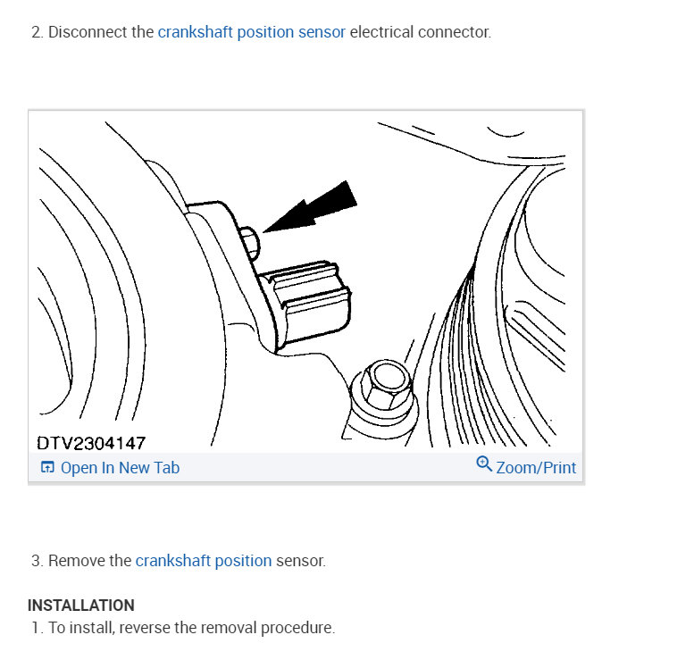

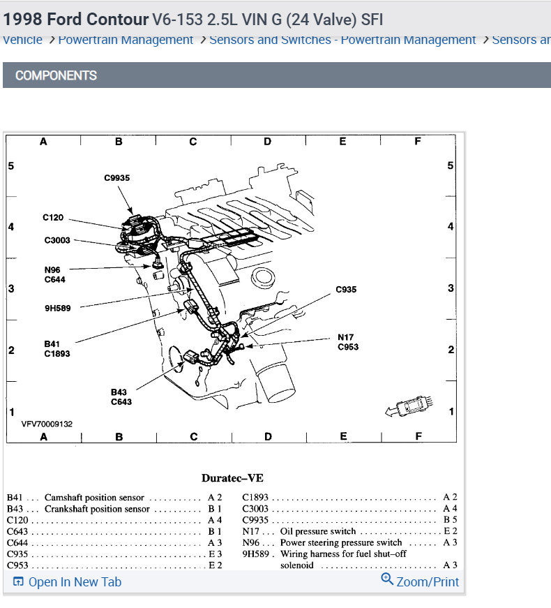

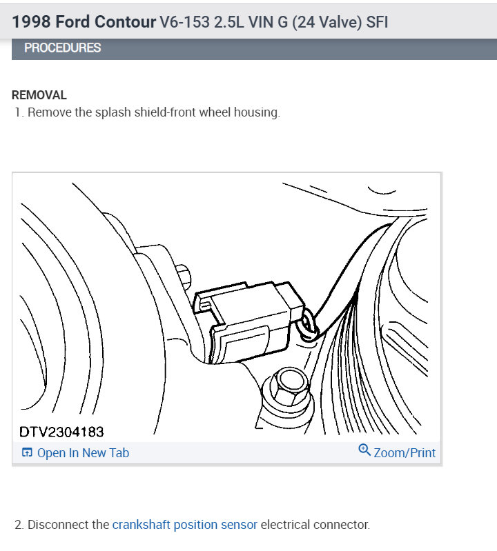

Where is the crankshaft position sensor located please?
150,000 MILES • 2.6L • 6 CYL • 2WD • MANUAL
BRIAN MIKKELSEN
Need to find the where the crankshaft position sensor location please?
Jul 22, 2022 at 11:16 PM
  • 55,691 POSTS
The crankshaft position sensor is down in front of the engine near the front balancer. Below is the location and the replacement instructions in the diagrams. Check out the diagrams (below). Please let us know if you need anything else to get the problem fixed.
