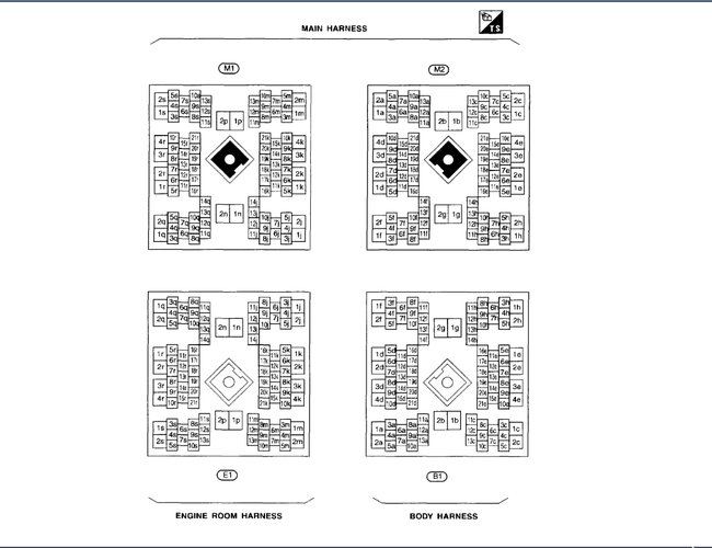

Crank shaft sensor location, code po335
2001 NISSAN PATHFINDER
200 MILES • 3.1L • 4 CYL • 2WD • AUTOMATIC
LILBOT6969

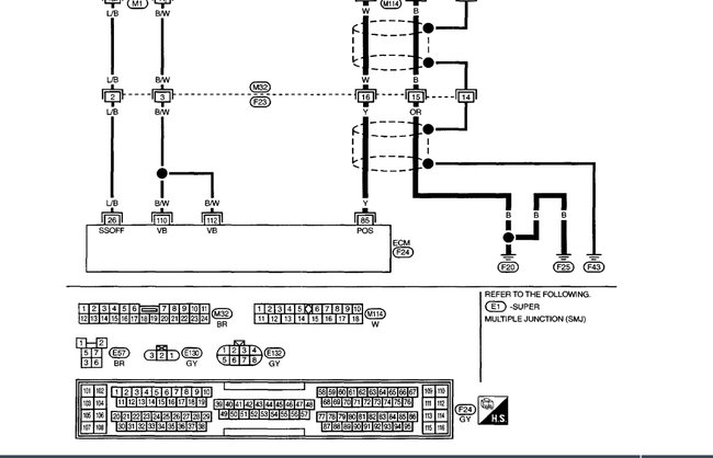

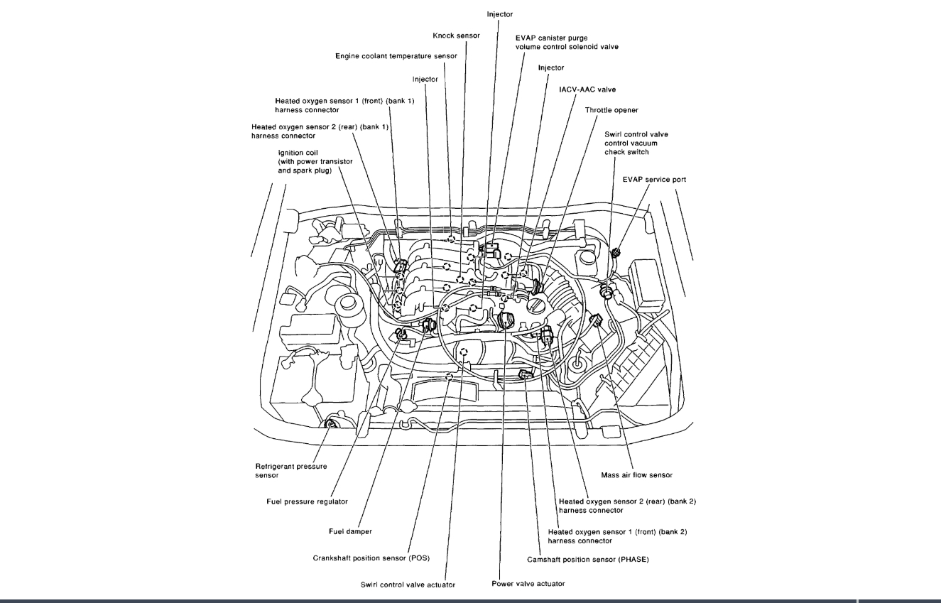

Can't find the crankshaft position sensor on position sensor on this car. Code po335 was the code that popped up was the problem.
Dec 8, 2019 at 6:50 AM
SCGRANTURISMO
  • 4,897 POSTS

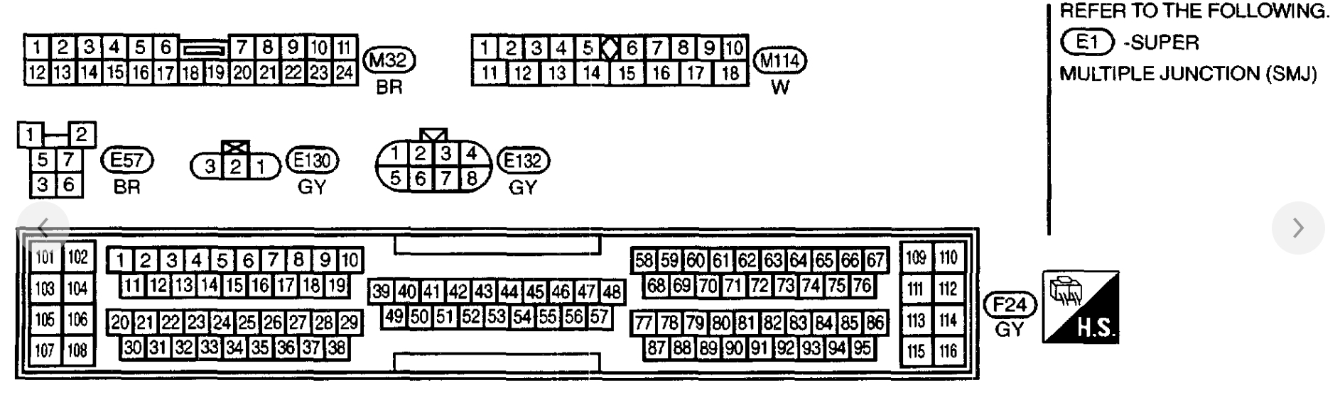

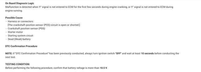

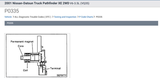

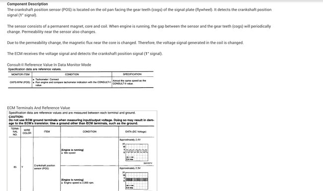

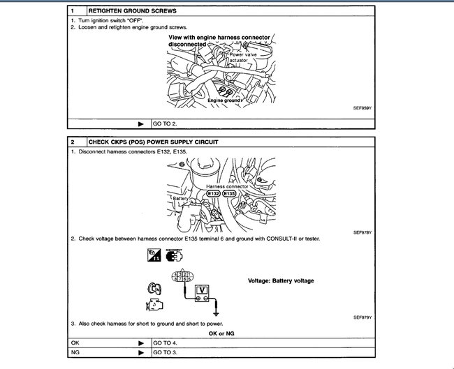

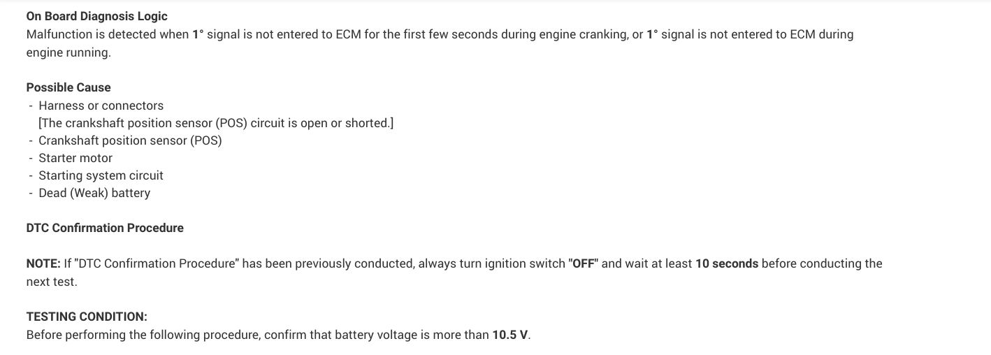

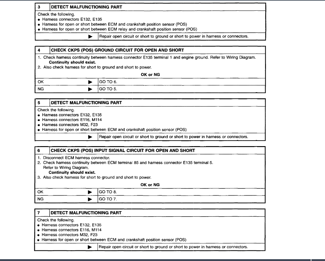

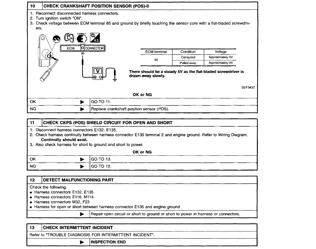

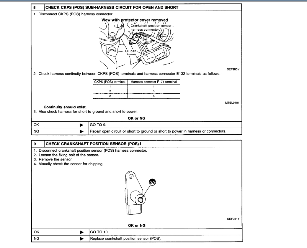

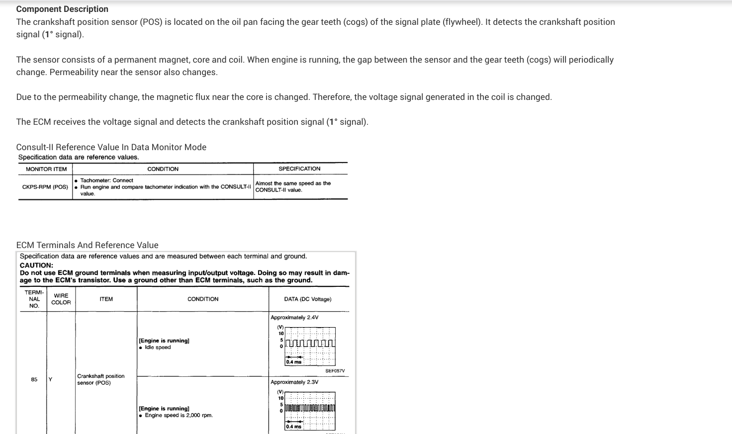

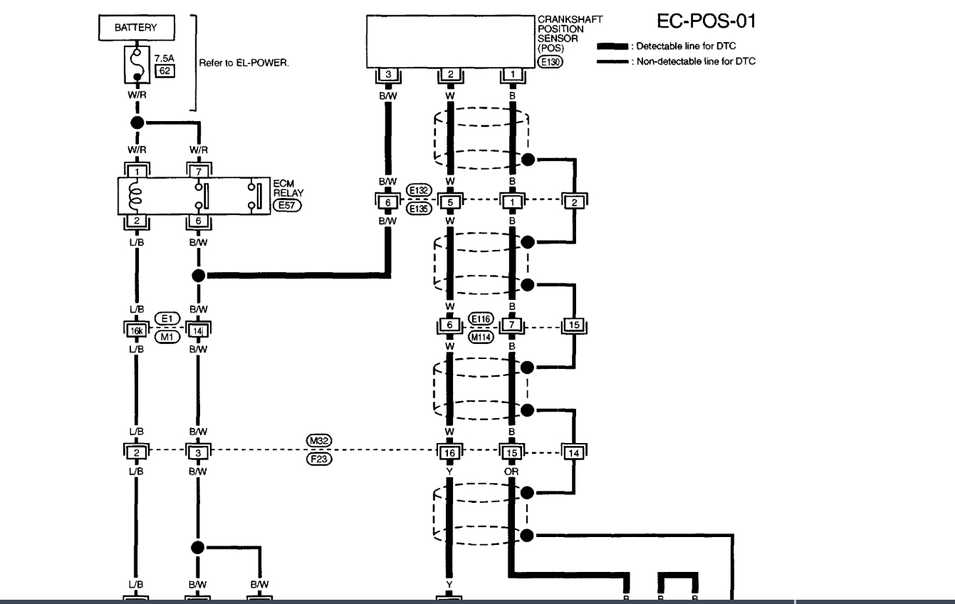

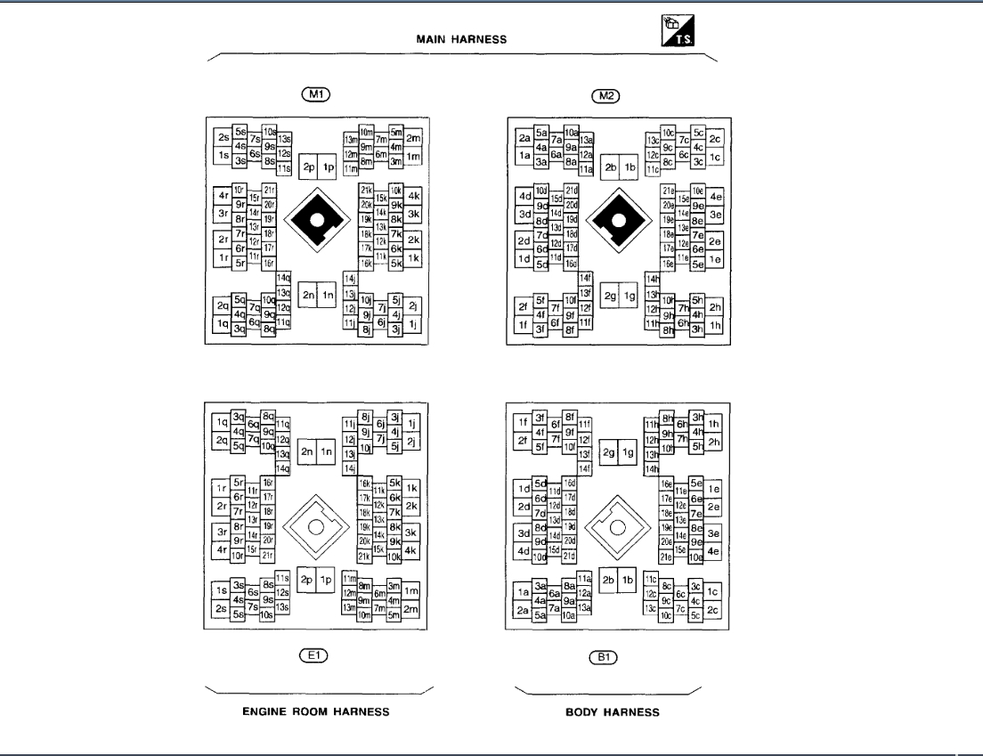

In the diagrams down below I have included a diagram with all of the OBDII sensor locations in your vehicle's engine bay. I have also included the diagnostic troubleshooting guide for your vehicle for Direct Trouble Code [DTC] P0335 for your vehicle from the manufacturer. Please go through this guide and get back to us with what you are able to find out.
Thanks,
Alex
2CarPros
