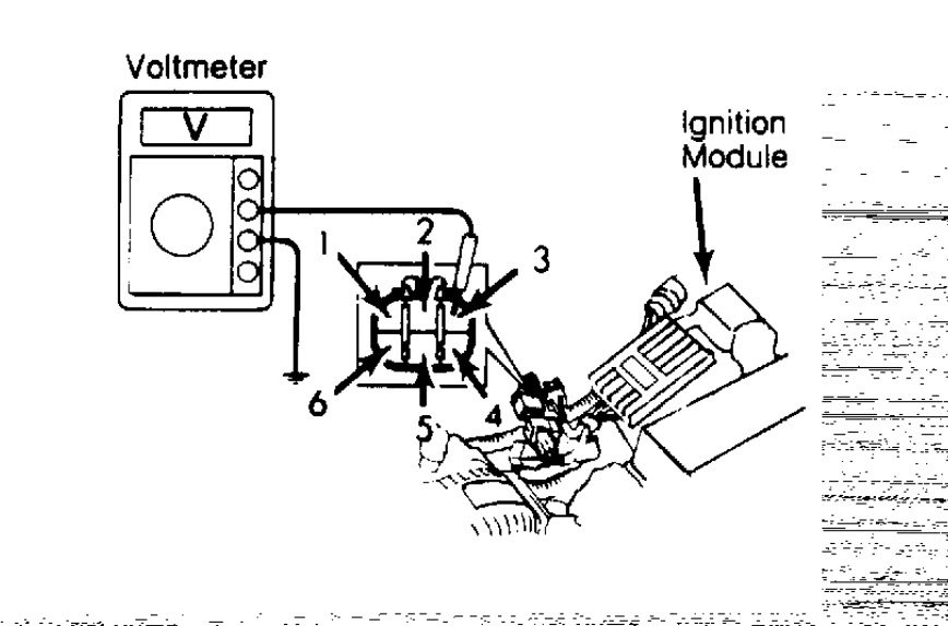

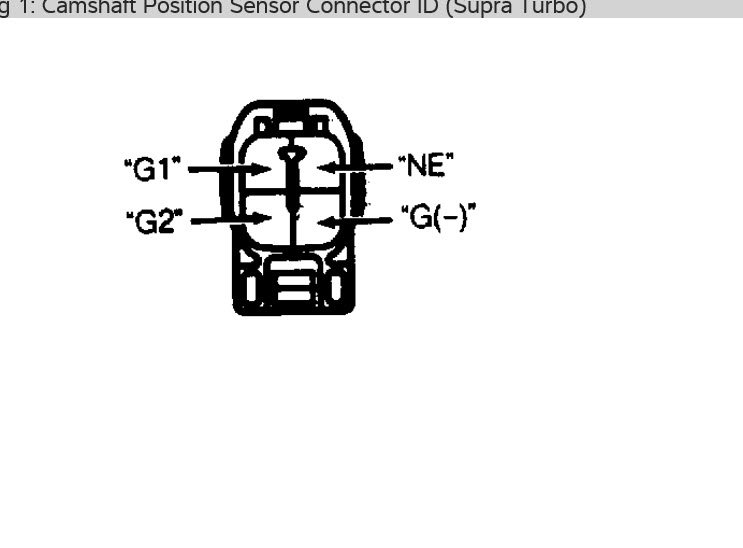

Where is the crank shaft sensor located?
Jul 15, 2016 at 2:41 AM
HMAC300
  • 48,601 POSTS

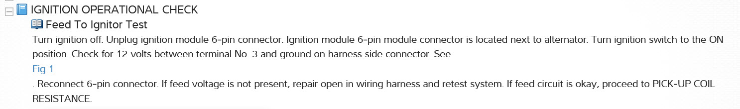

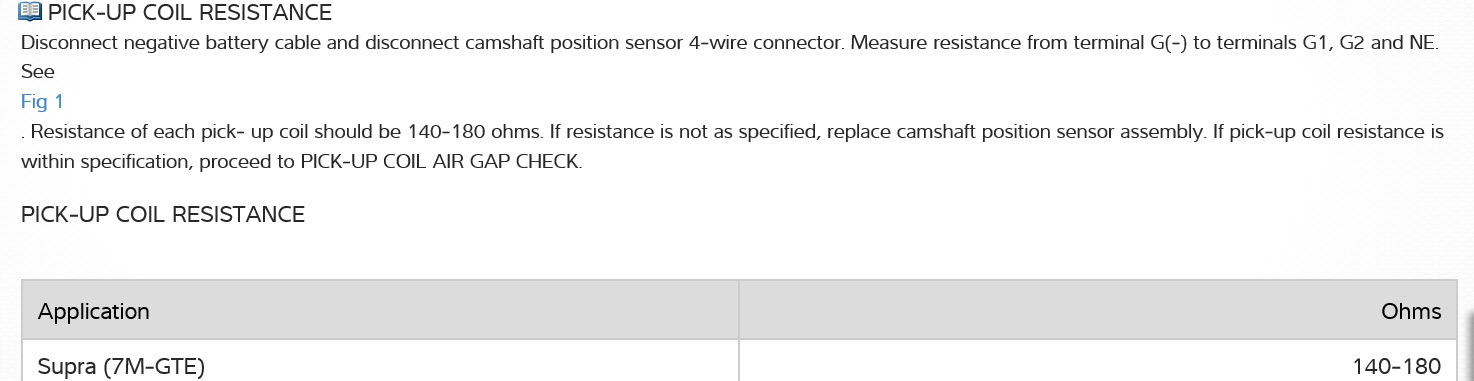

Your car does not have one. see pictures to diagnose. pick up coil should have air gap of .008-,016" it can also be the igniter there is a separate test for that.
