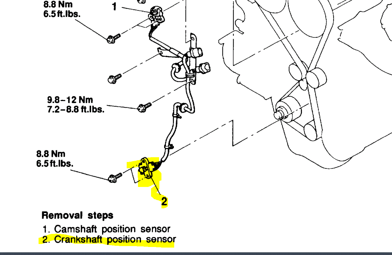

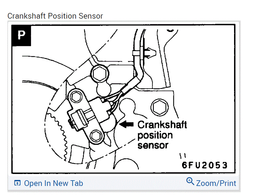

How can I get to my crank shaft sensor? Where can I locate my crank shaft sensor?
Oct 27, 2021 at 10:05 AM
  • 110,244 POSTS

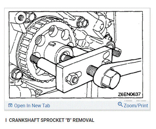

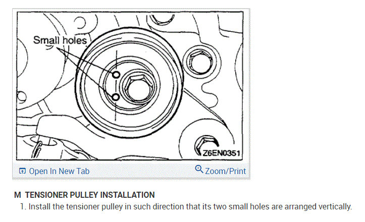

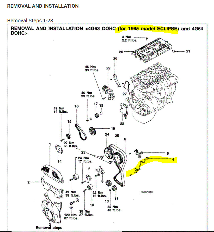

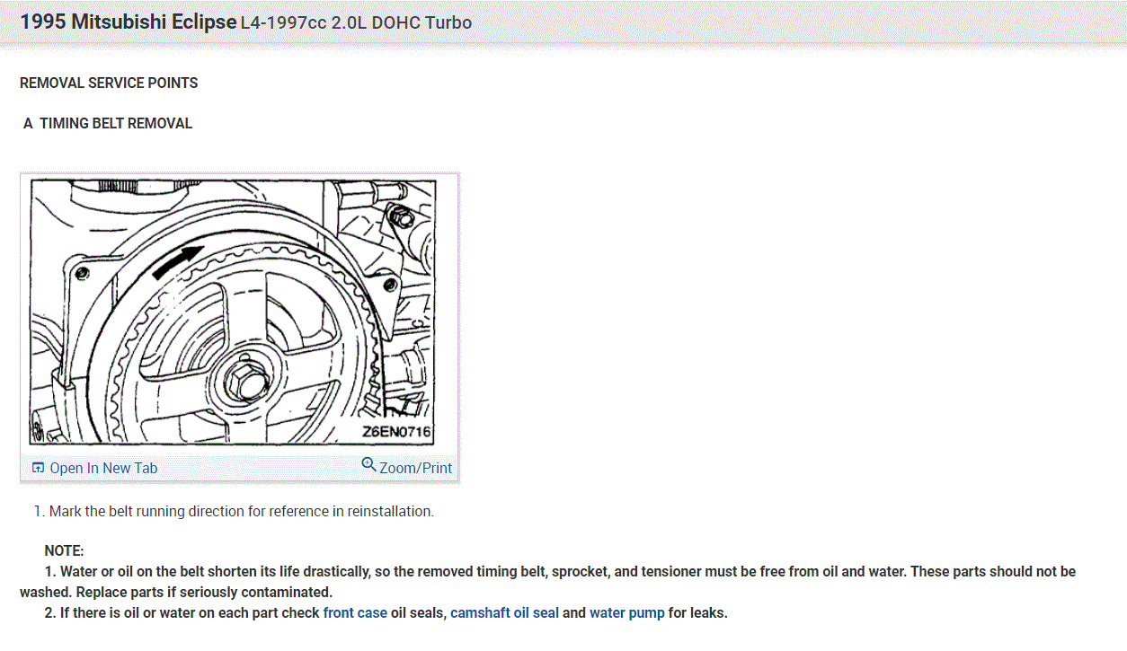

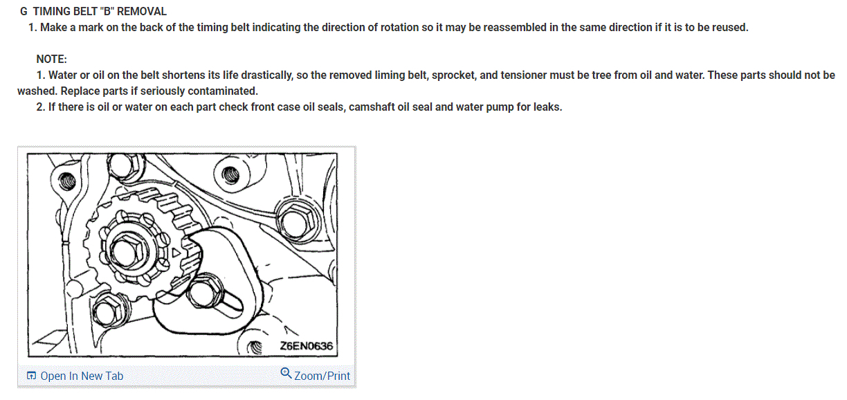

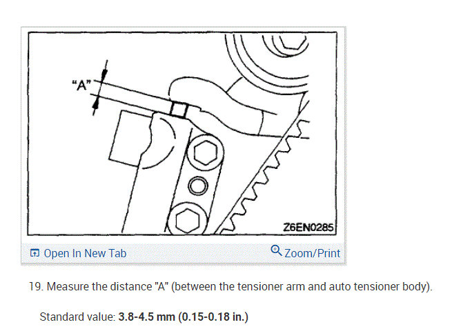

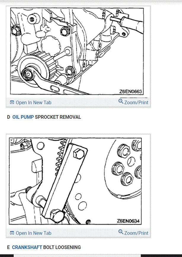

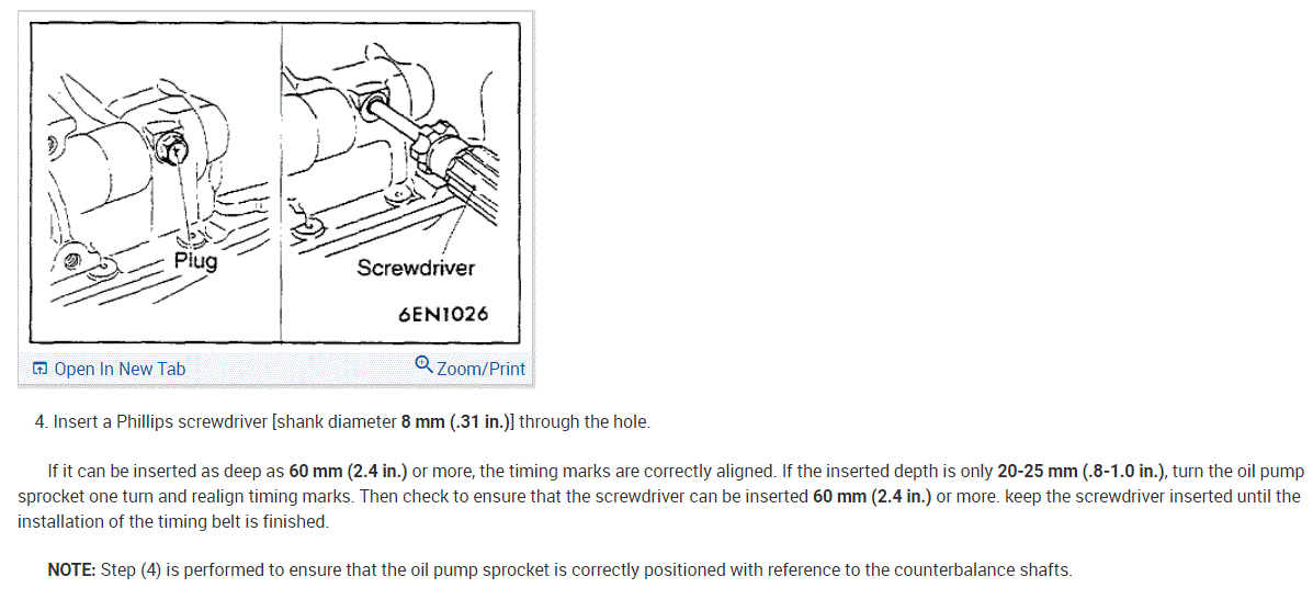

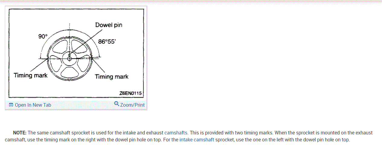

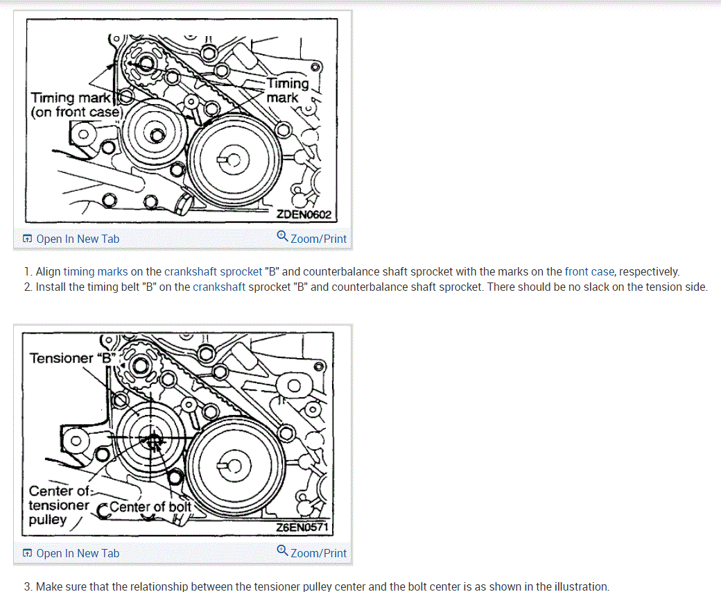

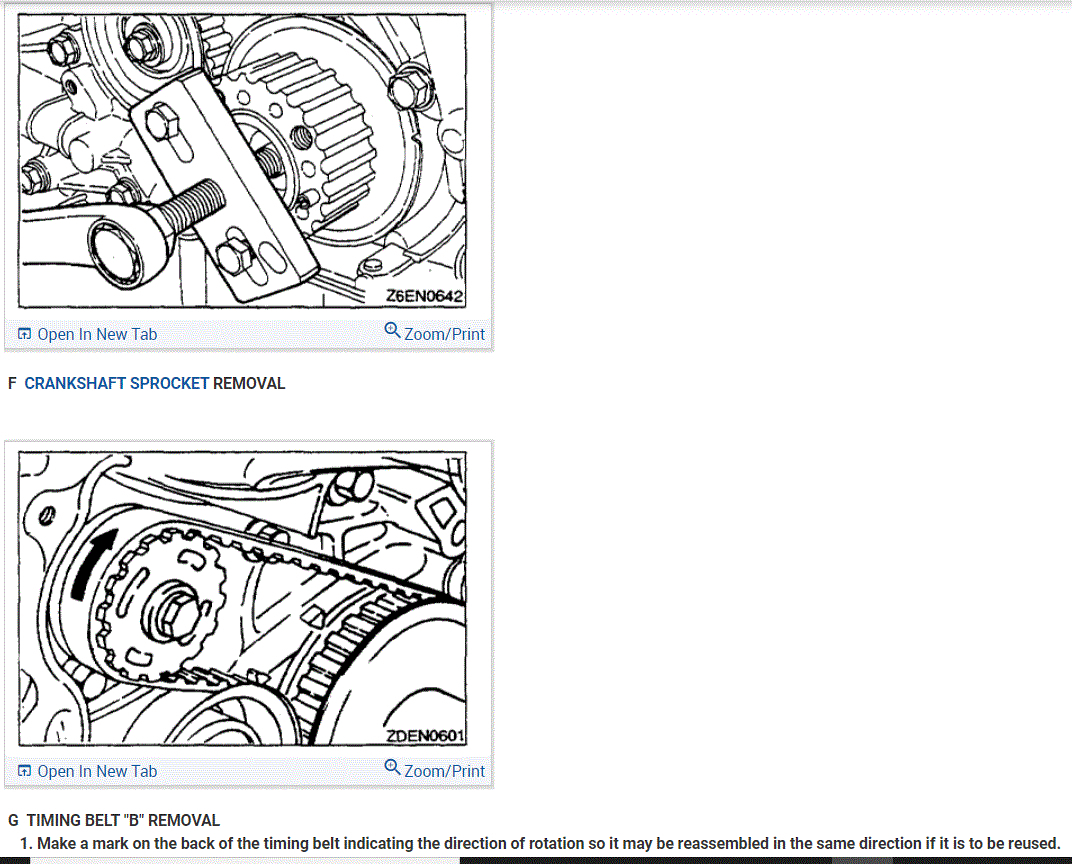

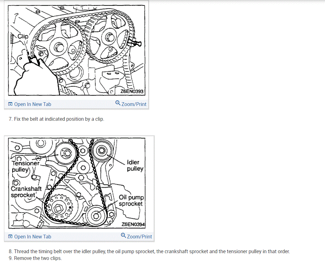

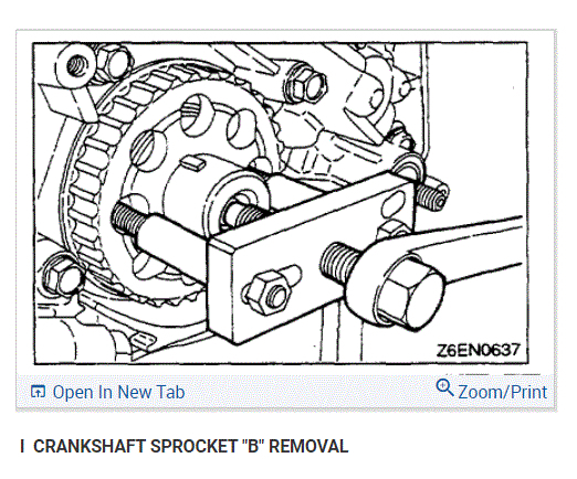

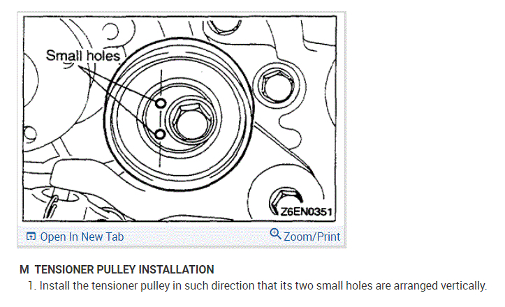

The crankshaft position sensor is located in the front of the engine and behind the timing belt. See pics 1and 2 below.

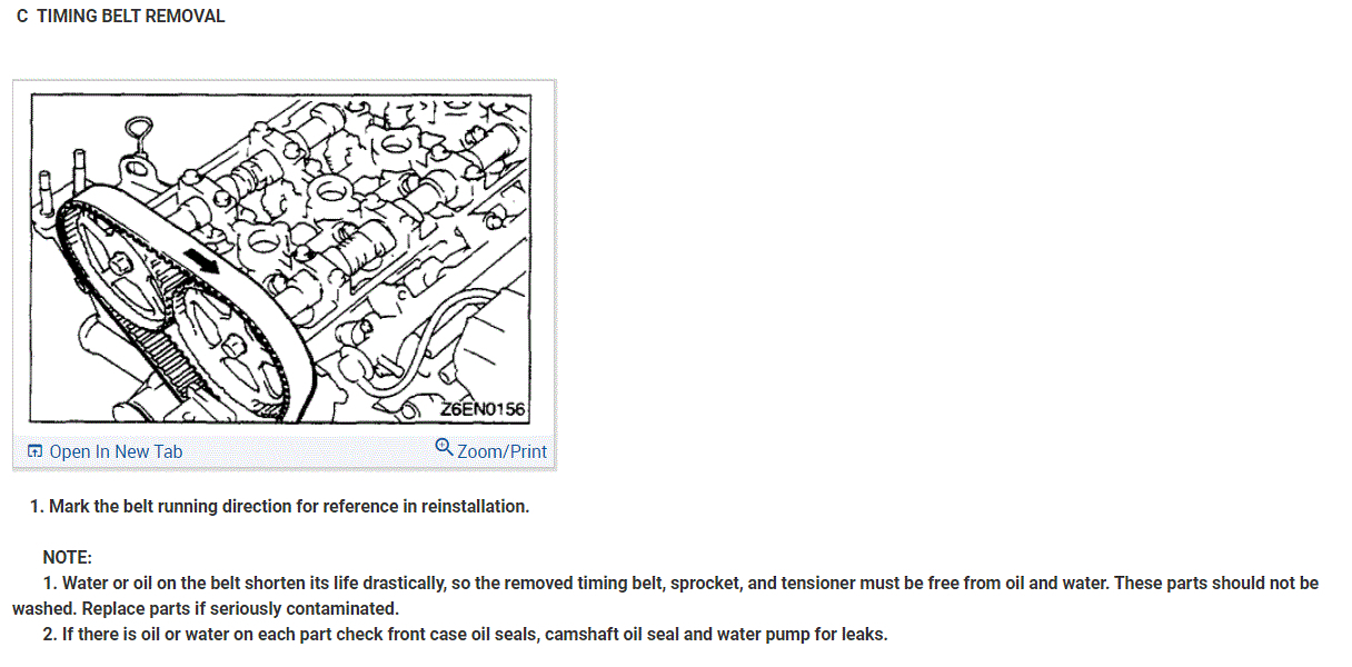

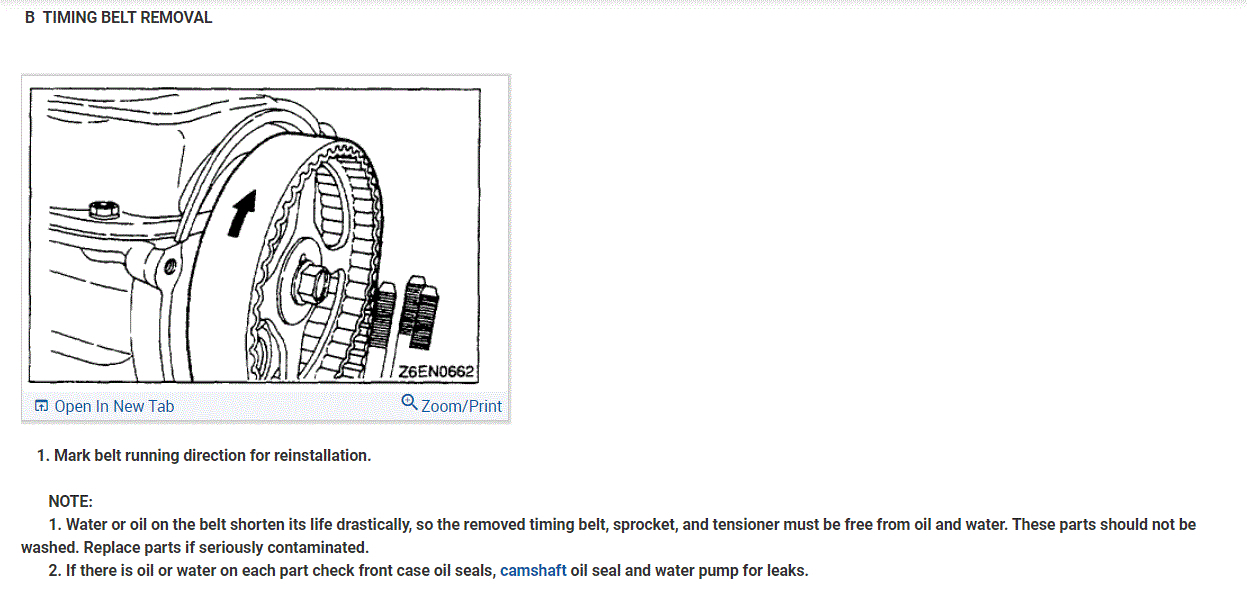

To replace the sensor requires the removal of the timing belt cover and belt. It is a somewhat involved procedure, so it's important to confirm it's bad before replacing it.
What has been done so far to determine it is bad? Have you checked for ignition spark to the plugs? Is there an RPM signal?
If you haven't confirmed, try this. If the vehicle has a tachometer, see if it moves slightly when cranking the engine. Or you can check to see if there is spark to the plugs. Here is a link showing how that is done:

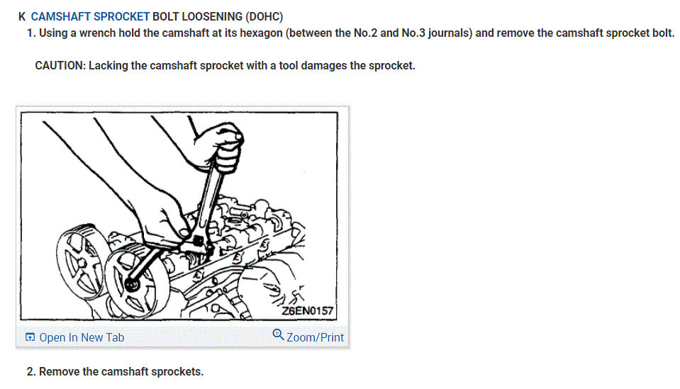

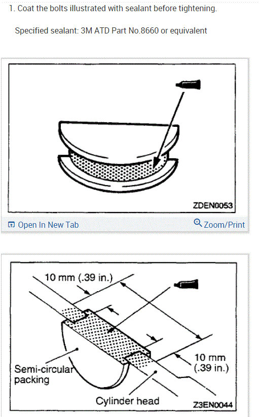

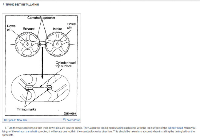

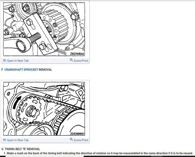

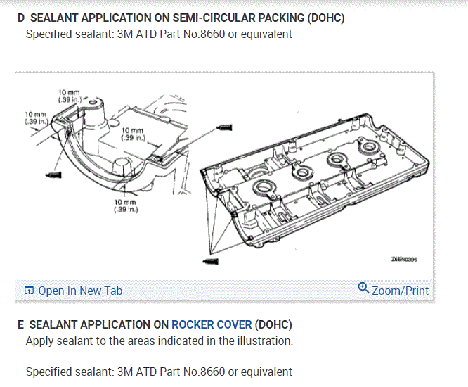

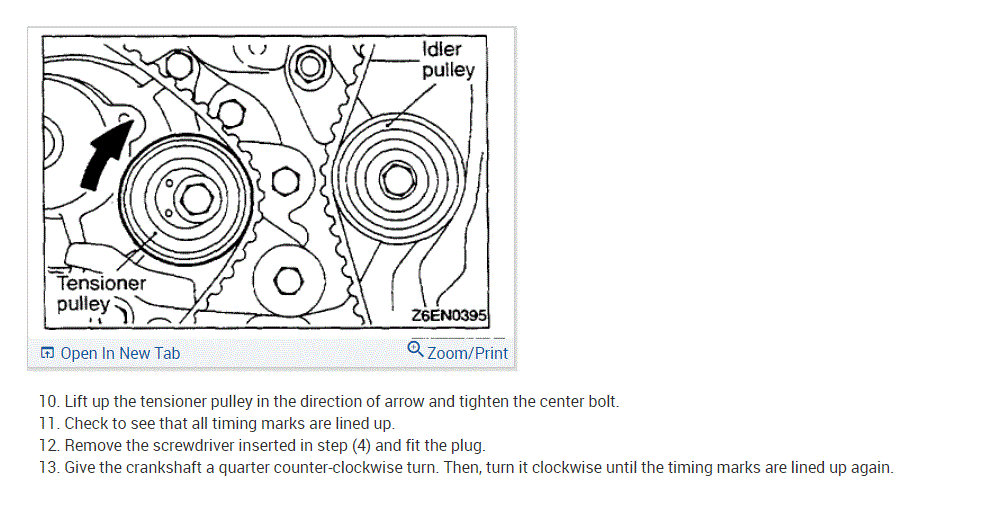

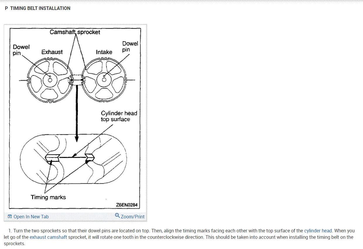

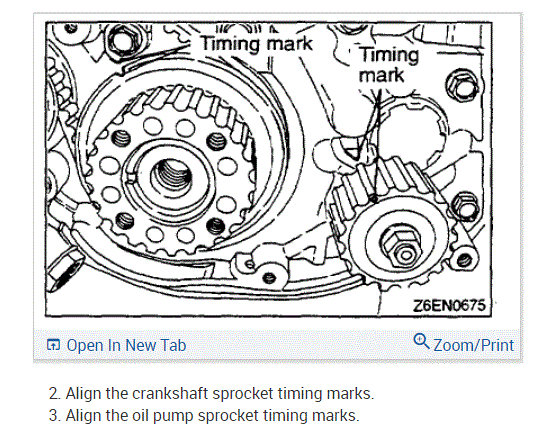

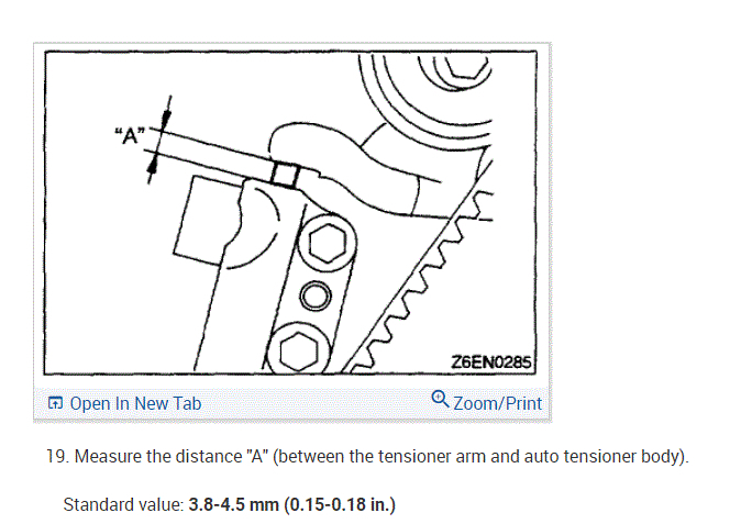

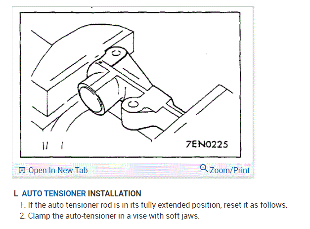

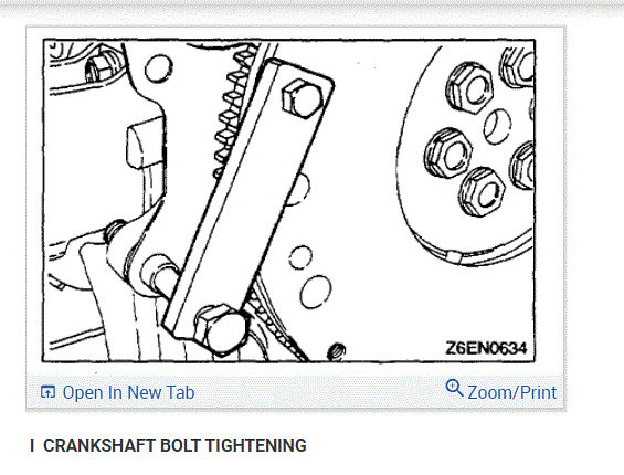

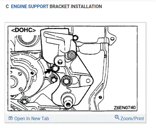

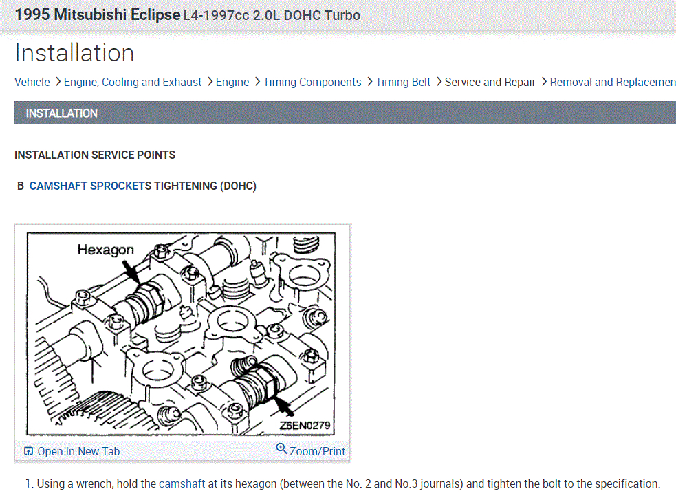

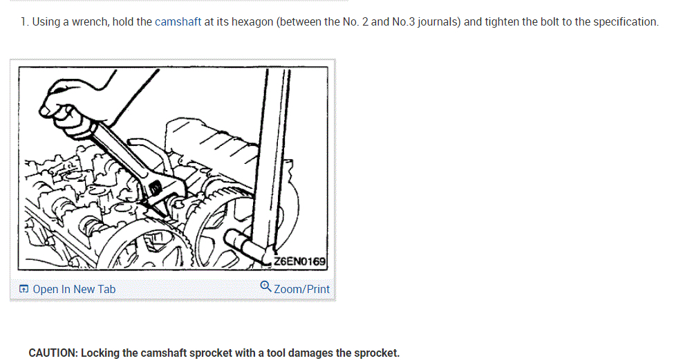

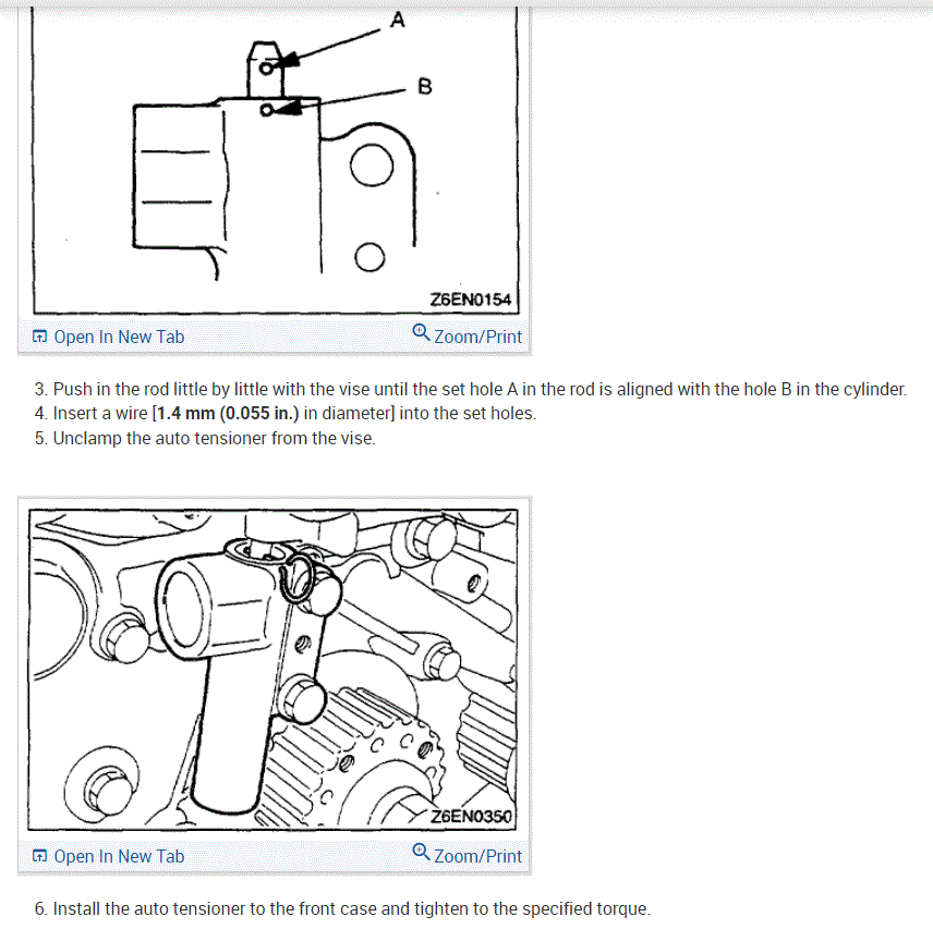

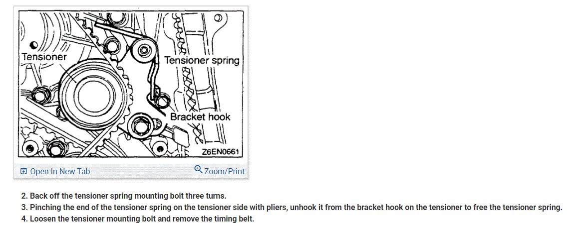

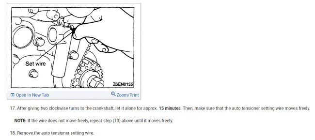

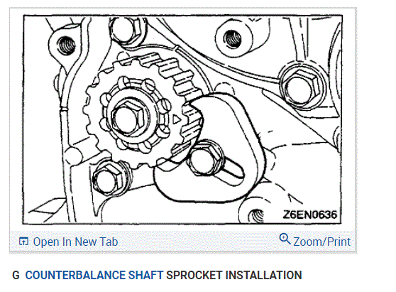

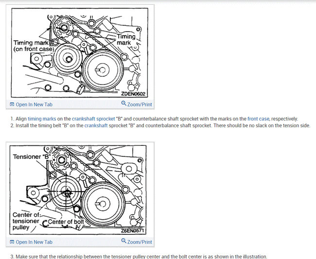

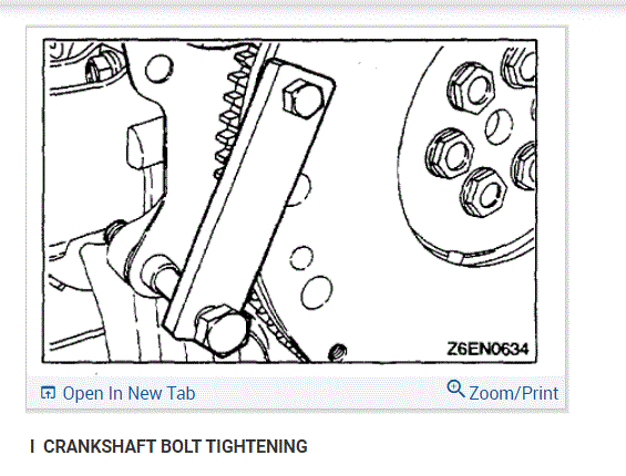

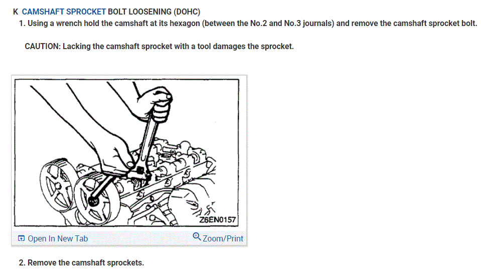

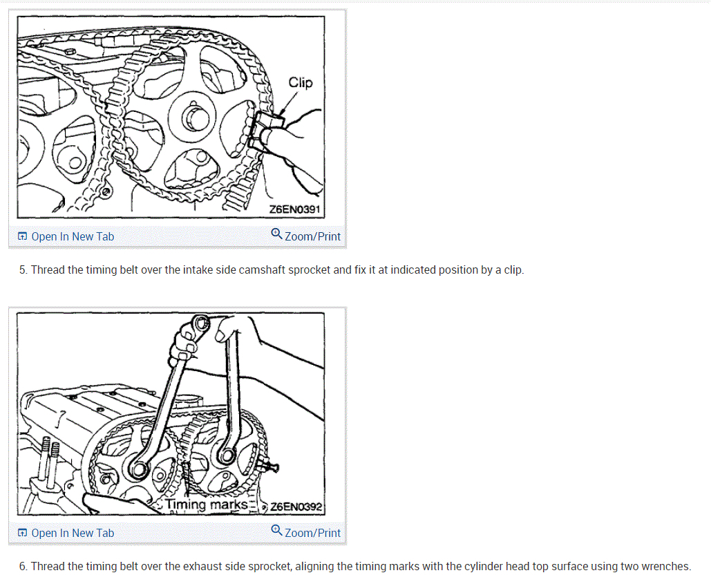

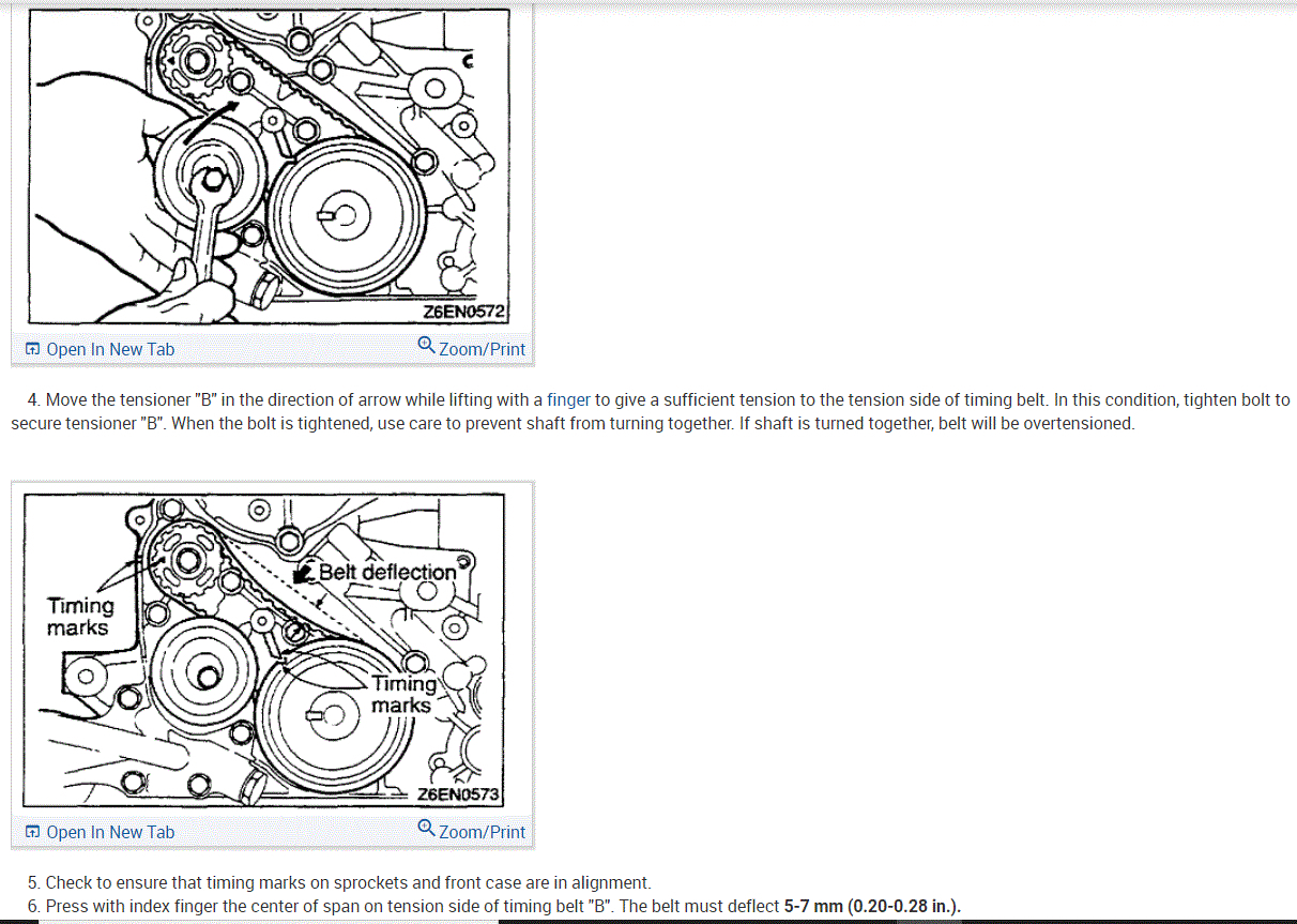

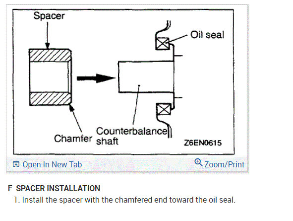

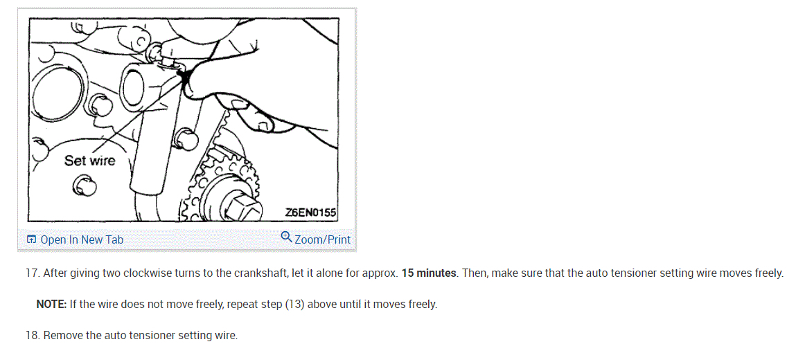

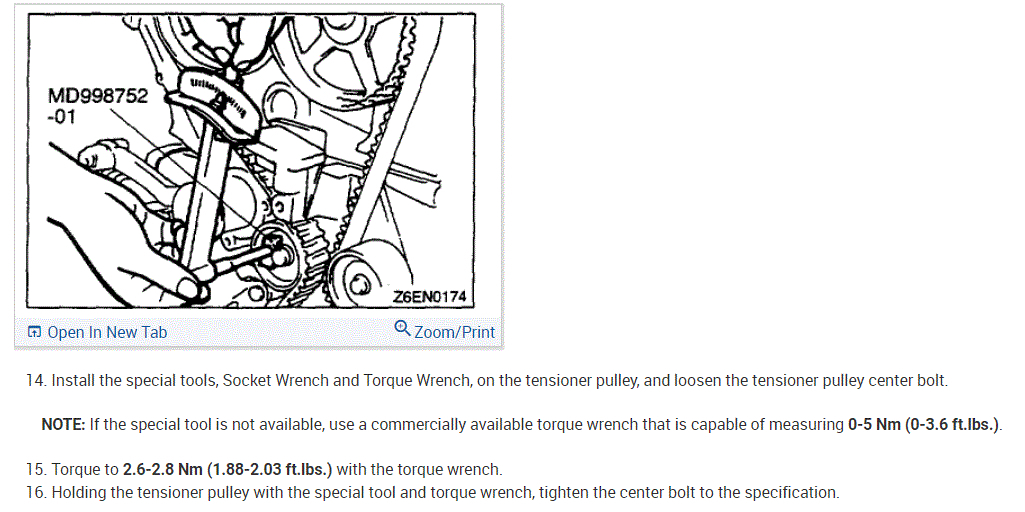

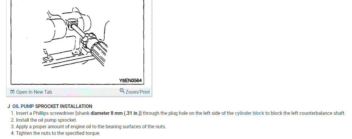

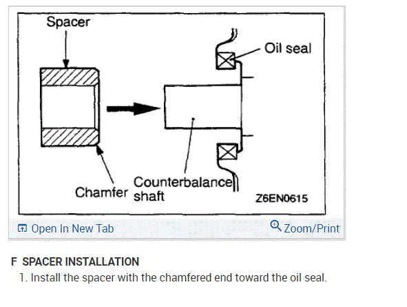

If you have confirmed it is bad, starting with pic 3 below, I included the directions for the removal and replacement of the timing belt. Note: This is an interference engine. You must be certain the timing is done correctly. Otherwise, internal engine damage can result.
I hope this helps. Please let me know if you have other questions or if there is anything I can do to help.
