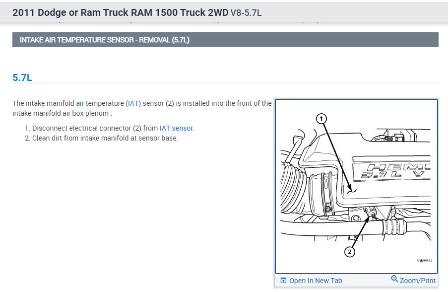

The crankshaft position sensor will usually cause issues when the engine is at operating temperature or all the time.

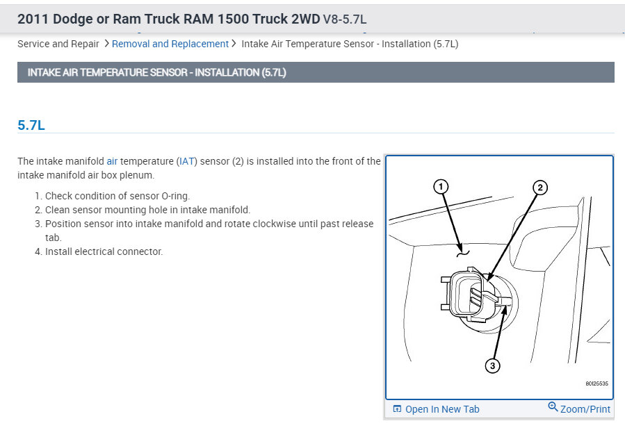

The one that has my attention is the IAT sensor. The PCM uses info from this sensor to control Injector pulse-width and to adjust spark timing.
However, I want you to try something before anything. When you say it takes 7-8 to start every time, do you mean that many attempts or it cranks for 7 to 8 seconds? If you meant attempts, try this, and let me know what happens.
1) With the key off, turn it to the run position (engine off) and count to 5.
2) Turn the key off and repeat step 1 a total of 5 times.
3) On the sixth cycle, see if it starts normally.

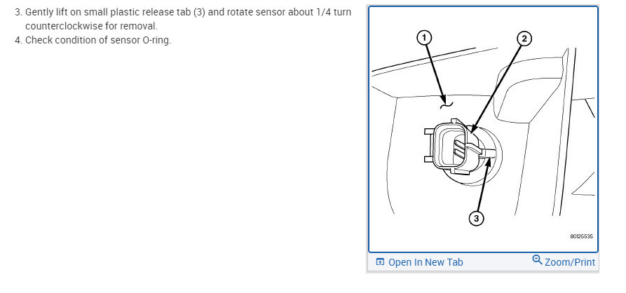

If that makes no difference, I would move to the IAT sensor. I attached the directions for the removal and replacement of the component below
Let me know the results.

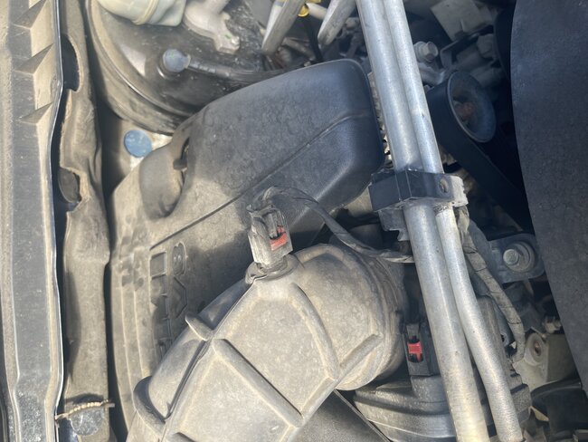

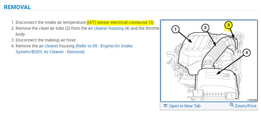

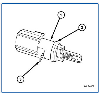

Is it not this one?
Nov 2, 2022 at 12:39 AM
BHAMDOC1973
  • 2,007 POSTS
I tried that method and made no difference.
Nov 2, 2022 at 12:53 AM
  • 110,248 POSTS
Then it isn't a fuel pressure drop-off issue. The pic you attached above shows the intake air temperature sensor (IAT).
See pic below.
Nov 2, 2022 at 6:34 AM
BHAMDOC1973
  • 2,007 POSTS
I replaced the CPS and it did nothing. Also, code still is deleted and comes back as soon as i start it. I may have gotten confused. So, you are saying it could be the IAT, because if it did work after 5 trials of on and off it could have been related to something like a fuel pump, correct?

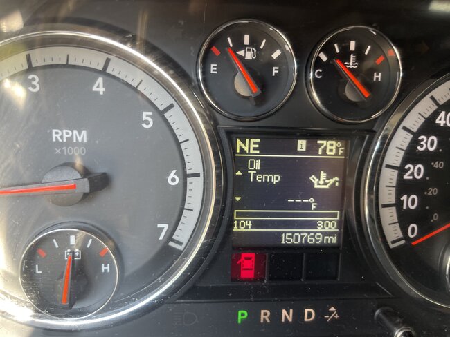

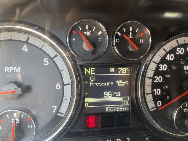

Measured with test light and one of the wires has power on with engine off key on. Also is it possible the pressure sensors, am guessing teo here, one for temperature and one for pressure are causing this? Both I am sure are bad.
Nov 4, 2022 at 4:46 AM
BHAMDOC1973
  • 2,007 POSTS
Here.
Nov 4, 2022 at 4:47 AM
  • 110,248 POSTS

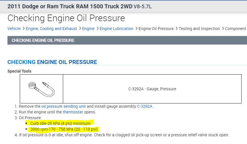

The oil temperature sensor isn't even providing a signal. Also, 96 psi for pressure is extreme. Was the engine at idle?
Nov 4, 2022 at 1:12 PM
BHAMDOC1973
  • 2,007 POSTS
Yes, engine at idle, but i saw couple of forums that said if you see it at 96, which is the limit for it, and it doesn't change, then its bad.
Nov 4, 2022 at 1:42 PM
  • 110,248 POSTS
Is it constantly at 96? I attached specs below for you to review. It indicates between 25 PSI and 110 PSI at 3,000 RPMs. If you are at 96 PSI at idle, either we have a resistance issue in the wiring, or the sensor is bad.

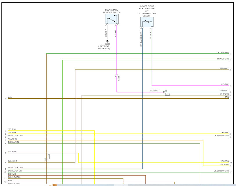

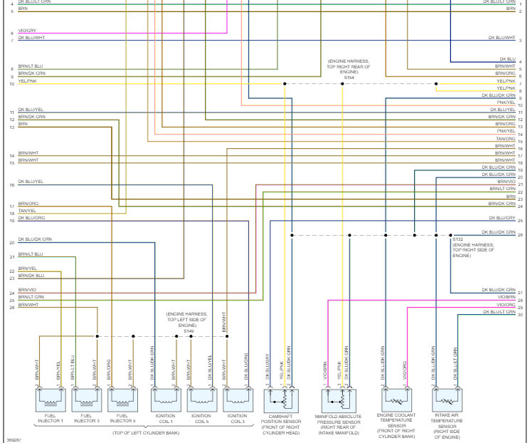

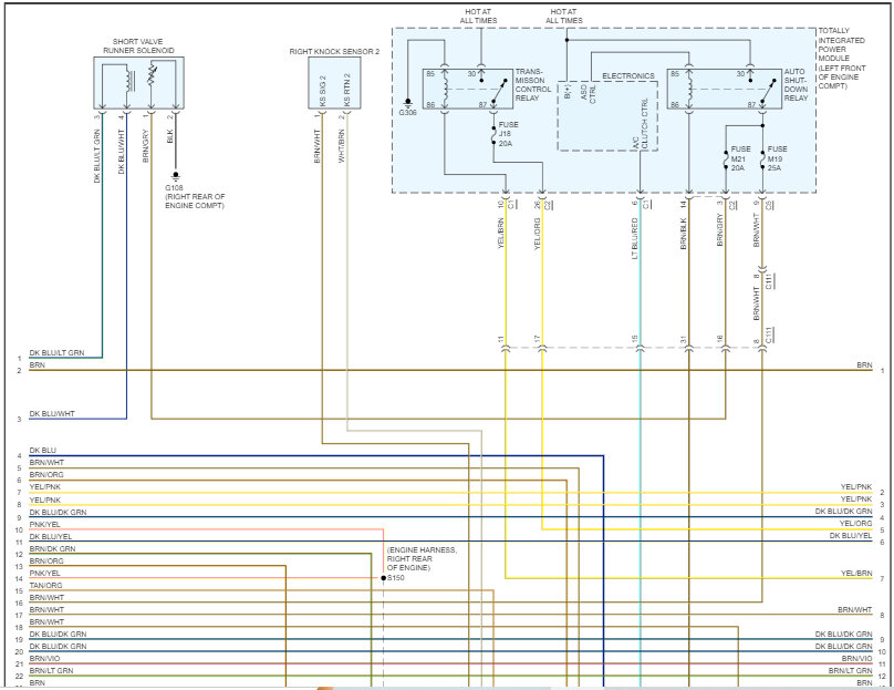

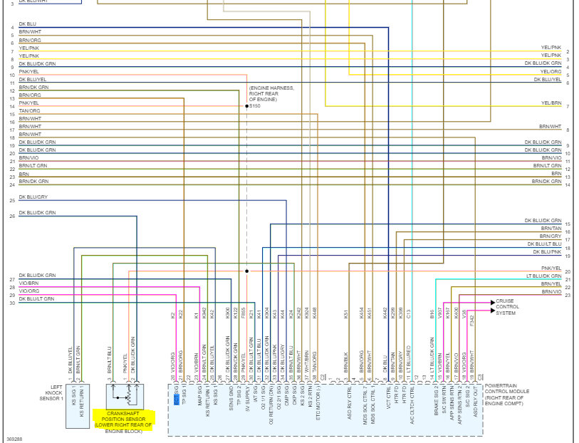

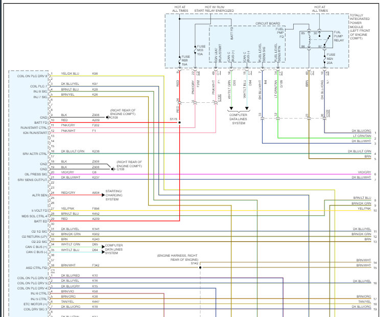

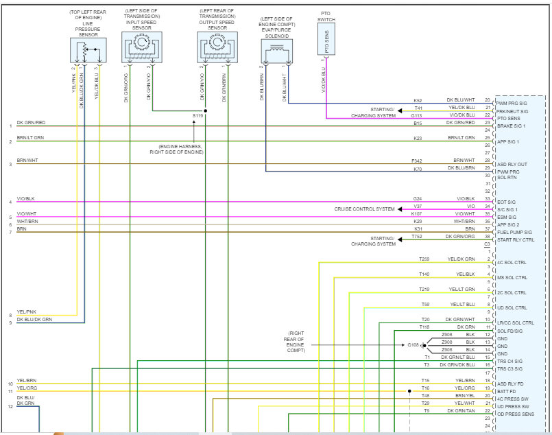

I found out what the problem is, the harness is damaged at the intersection that goes to all three sensors, oil pressure, temperature and cps. I am having difficulty with the colors as there are so many blue-looking colors. I ordered the pigtail for the oil pressure sensor as the wires are damaged to the end of the clip. Can you send me a diagram of that part of the harness going to these sensors? Trying to figure out what connects where and how it distributes to the knock and cps once it leaves the oil temperature and pressure sensors.
Nov 9, 2022 at 1:29 AM
  • 110,248 POSTS

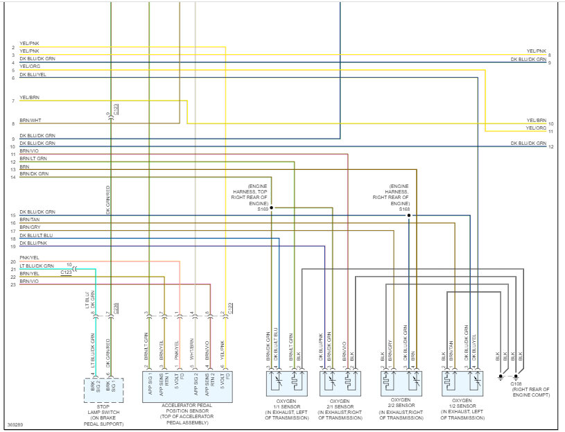

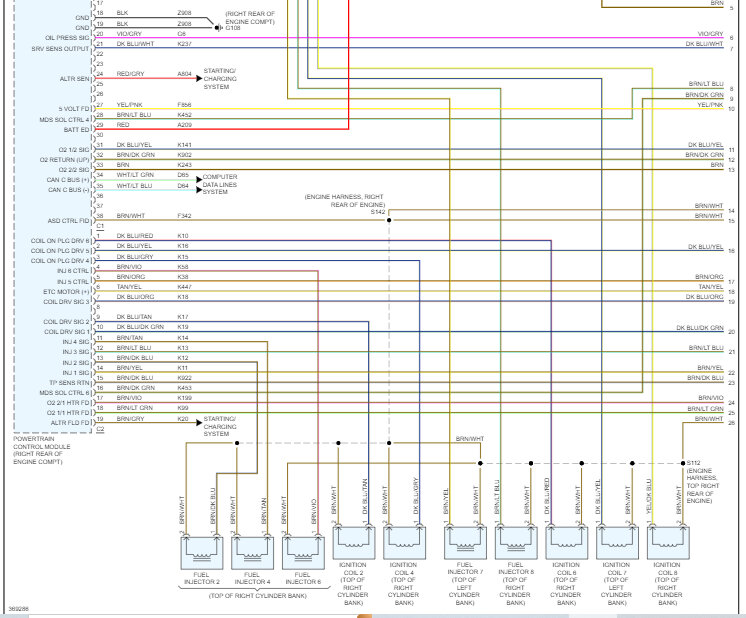

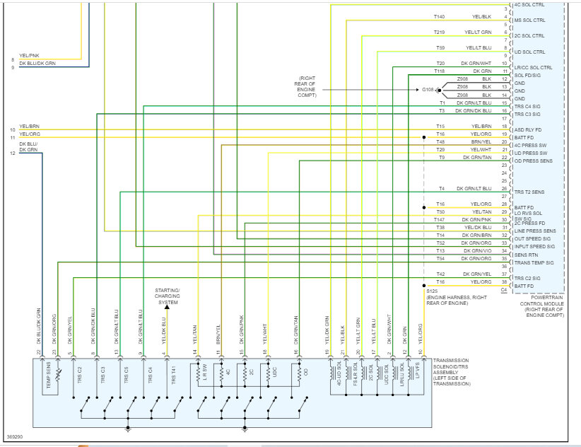

I attached the entire powertrain management circuit, but that may be worse or more confusing for you. The way the manuals are set up, I can't pull one separate harness.
I highlighted each of the three components you mentioned.
The schematic is five pages long, but I had to cut each pin in half to make them readable. I did overlap them for you.
Let me know if this helps.
Nov 9, 2022 at 8:52 AM
BHAMDOC1973
  • 2,007 POSTS
Thanks, that helps. Those blue wires are hard to distinguish. I don't see the oil temperature sensor.
Nov 9, 2022 at 9:14 AM

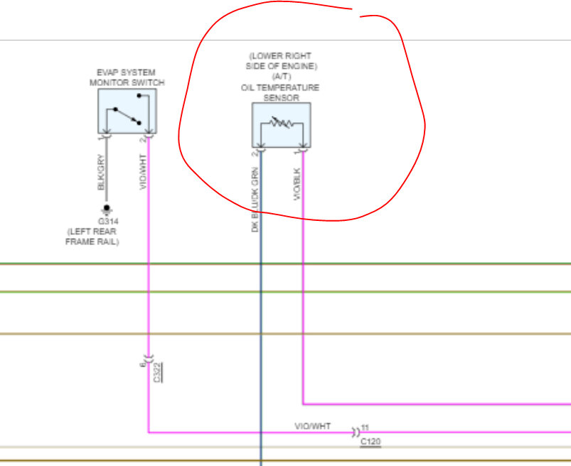

  • 110,248 POSTS
Are you referring to the trans oil temperature sensor? It's in pic 7. I copied it and attached it below.
Nov 9, 2022 at 11:23 AM
BHAMDOC1973
  • 2,007 POSTS

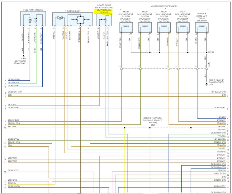

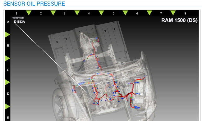

No engine oil temperature, the one above the oil filter. This whole circuit extends from the same harness: temperature sensor, pressure sensor, knock sensor and CPS.
Nov 9, 2022 at 11:30 AM
  • 110,248 POSTS
There is nothing in the schematic indicating an engine oil temperature sensor. The sensor above the filter is the oil pressure sensor. See the pic below.
See pic below.
Nov 9, 2022 at 12:55 PM

  • 110,248 POSTS
No problem whatsoever. As far as the blue wire is concerned, it will be a dark blue wire with a dark green tracer. Let me know if that is what you needed.
Nov 10, 2022 at 10:51 AM
BHAMDOC1973
  • 2,007 POSTS
Yes, i think i found it, it's the thinnest blue, the other two wires are confusing. Hoping they both give same signal; one goes to the main harness of the CPS the other to the oil pressure sensor.
