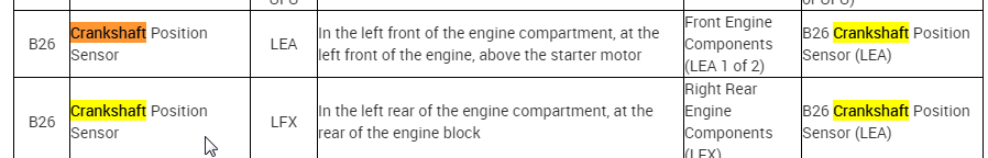

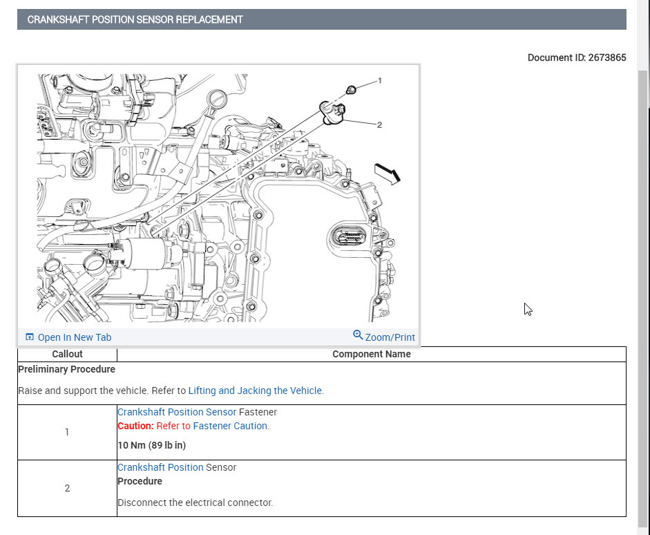

Where to find the location of the crank shaft position sensor? Thank you

Could you also include pictures or a video if you have one? Thank you

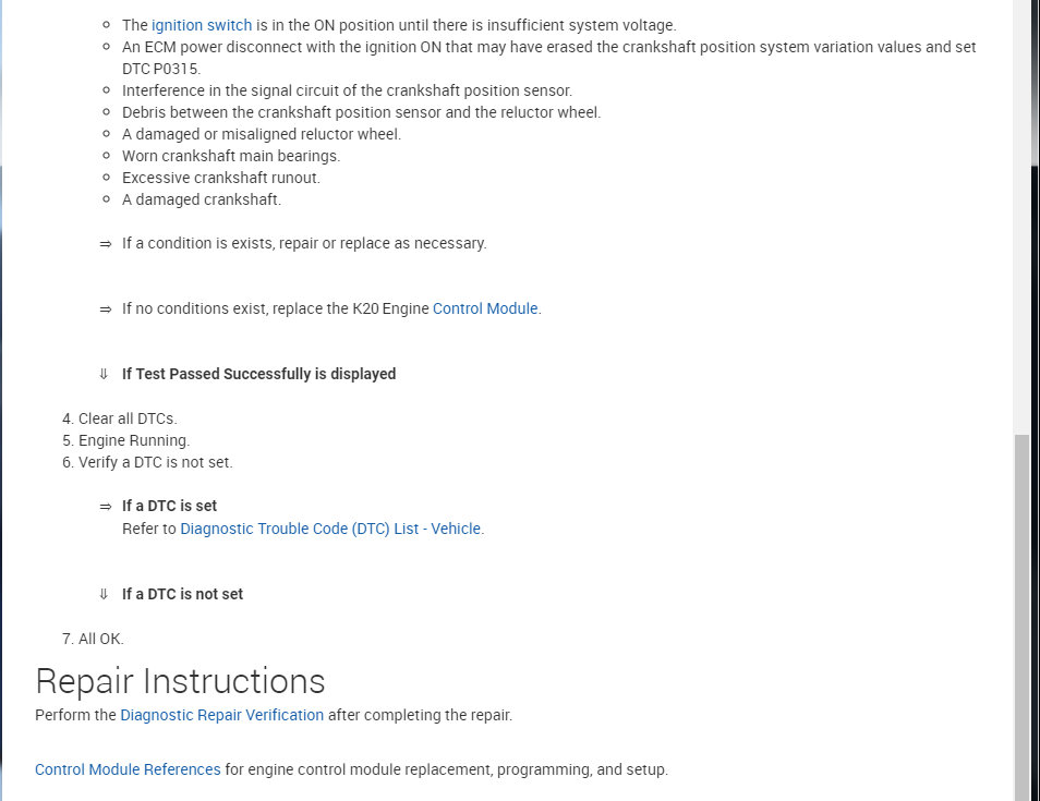

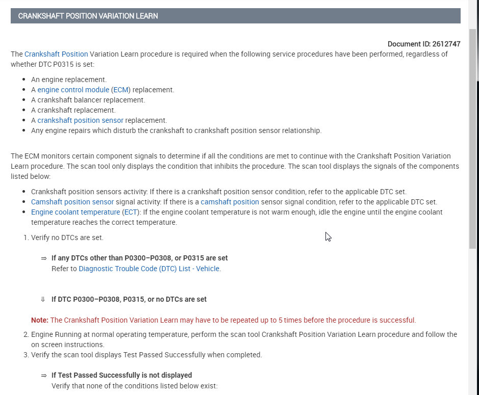

I attached the procedure which includes a picture of a location. Unfortunately, we don't have a video of this vehicle.
Please let me know if you have more questions and we can go from there. Thanks
