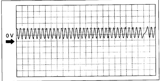

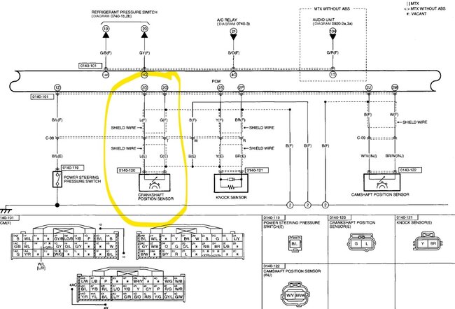

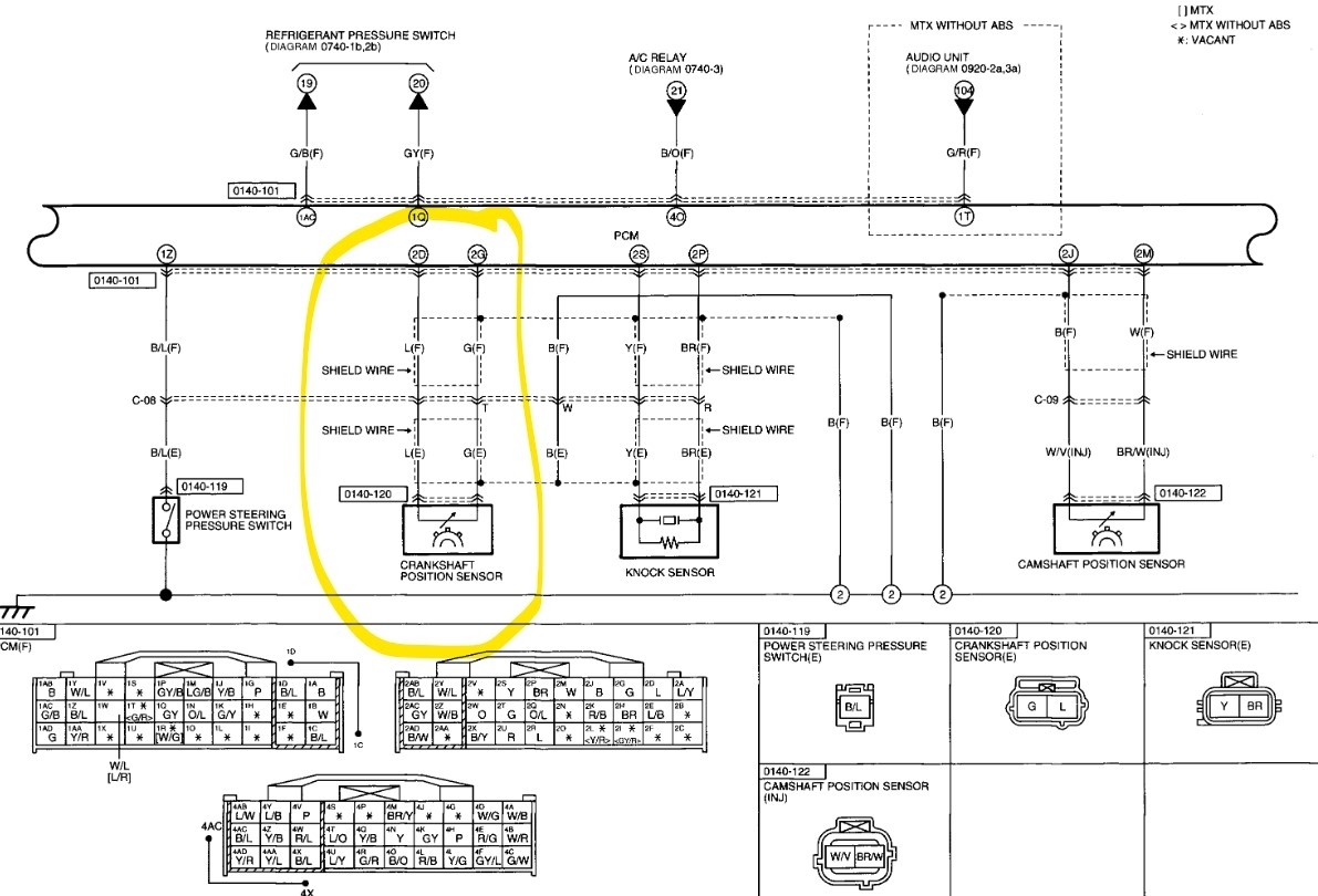

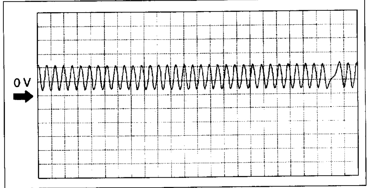

Either I am not getting power to the sensor, or I need help testing the power to it.
It reads .345 volts.
Jun 9, 2023 at 5:38 AM
STEVE W.
  • 15,413 POSTS
That sensor doesn't get power, it is just a coil that generates a sine wave from the teeth on the reluctor passing the coil's tip. If you have an oscilloscope, you could watch the signal, but a common meter won't tell you much because it doesn't sample fast enough.
