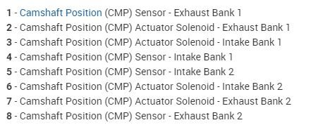

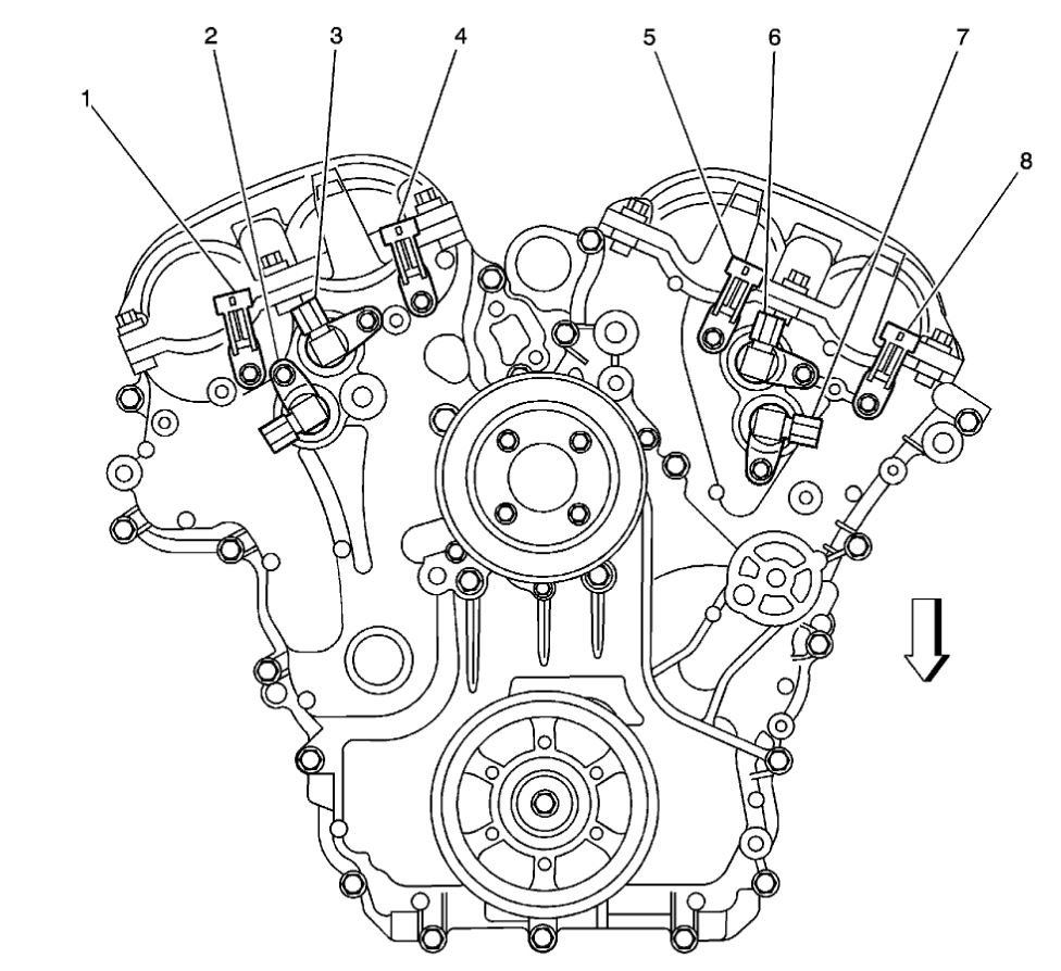

I had diagnostic code and said on the left bank side.When i start the car it might start on the first time. If not,when i engage the ignition i'll will start on the third time. changed the cam sensor which is located on the drivers side I am not sure on the passenger side if i am looking at the right sensors two of the sensors have 3 wire connect and 2 have 2 wires connect. the sensors that i see on line have 2 lug terminal connection.
Dec 14, 2019 at 5:12 AM
STEVE W.
  • 15,414 POSTS

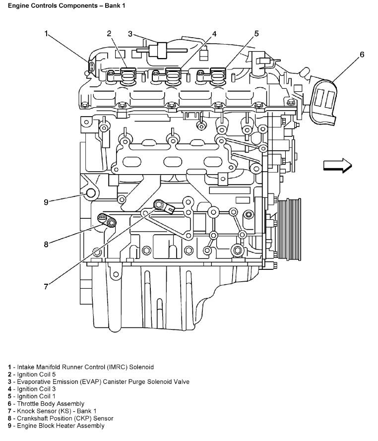

The crank sensor is bolted into the side of the engine block low and to the rear on the right side of the engine not anywhere near the cam position sensors. Item 8 in the image. What is the code you have?

The crankshaft sensor is on the lower portion of the engine block, RH side. The camshaft sensors(4) are in the front of the cylinder heads. There are four sensors, and four actuator solenoids for the camshaft timing actuators. I am assuming that your query comes from first a check engine light, and a trouble code that relates to the correlation. Most often times it is a result of camshaft drive chains having some stretch. I believe there is a bulletin out also that involves the reluctor on the crankshaft rotating some and causing timing faults. Seen a couple crankshaft issues, and have heard of some sensor issues. Most often it is chains that are needed. Let me know if you want some more info.

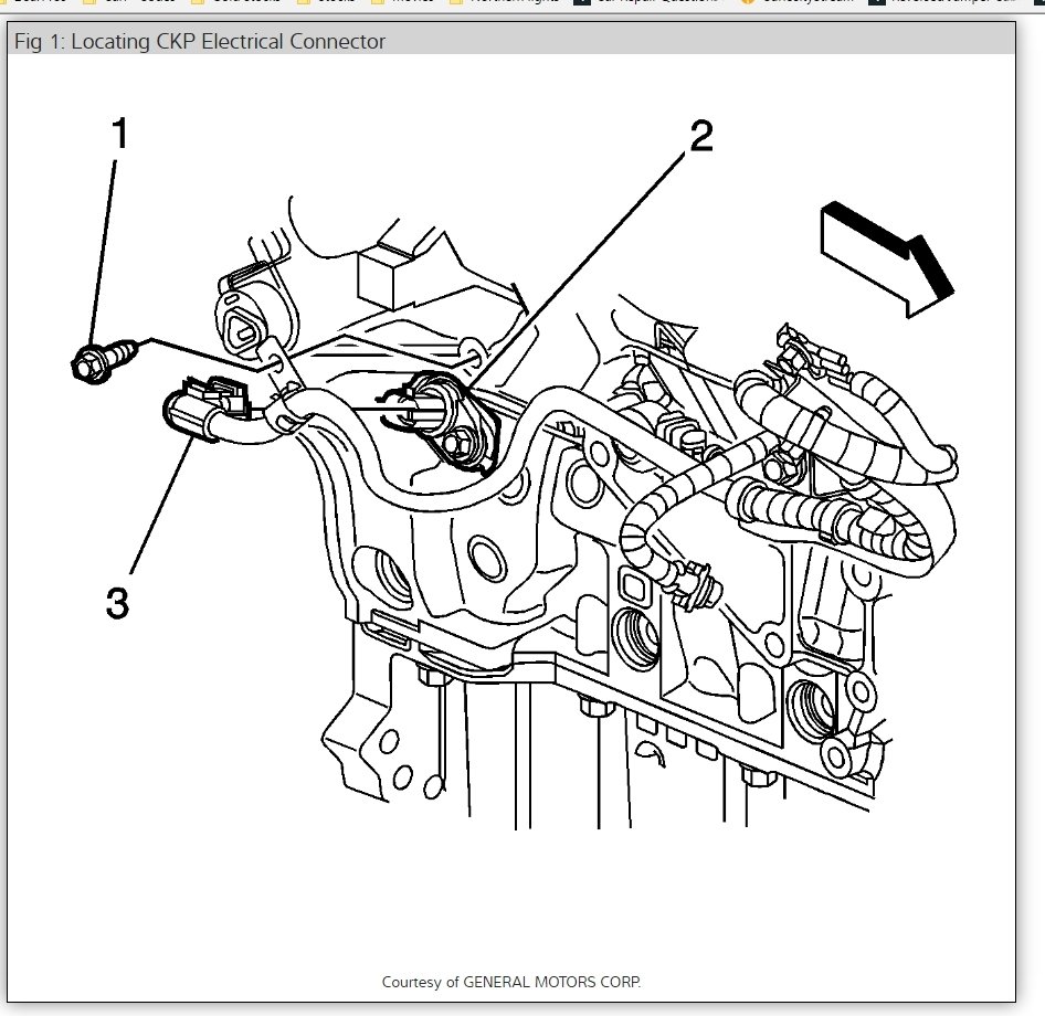

What is the cost for a crankshaft position sensor part? Also I am wondering if I can replace it myself?
Dec 16, 2019 at 5:04 AM (Merged)
  • 55,732 POSTS
Hey Sespinoza
Yes the price for the sensor is about $52.00 bucks from Amazon. It is not too bad replacing the sensor yourself but you will need to get under the car.
Next the sensor is in the block here is a diagram of where it is.

Good day , Is there more than 2 cam shaft positions sensors on my 2007 srx. Do you recomend replacing the upper manifold gasket when replacing the ignition coils & spark plugs.
Jan 15, 2020 at 3:14 AM
STEVE W.
  • 15,414 POSTS
There are 4 camshaft sensors and 4 camshaft actuator solenoids however what is the issue you have? If it's a cam crank correlation code like the other poster, the code shows the crank and cam sensors are fine, that code is a bad code on the early 3.6 and points to the timing chains being stretched and needing replacement.
