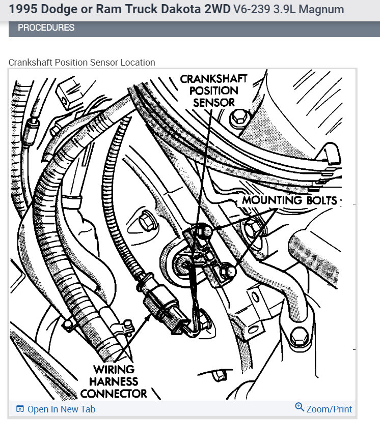

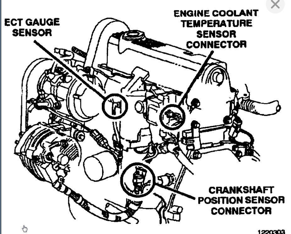

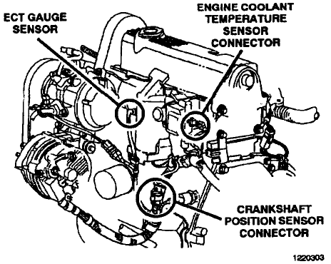

Does a 4cyl 2.5 L with a 5 speed have a Crankshaft Sensor the truck does have a distributor and if it does were is it because I can not find it
Thursday, December 20th, 2012 AT 12:20 AM
18 Replies
  • 52,797 POSTS

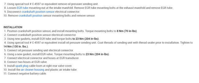

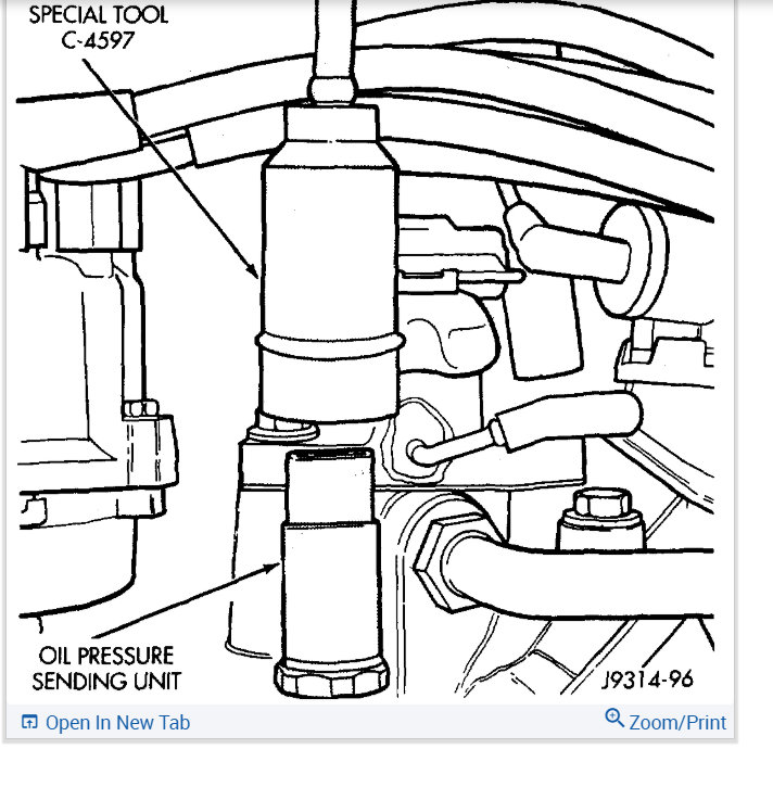

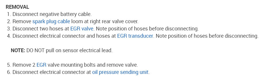

You car has a crankshaft position sensor on the lower side of the block. Check out the diagrams (Below) for the location. There are both engine in the diagrams below just in case someone needs it. Please let us know what happens.

I have a 91 dakota 3.9 automatic put a motor from a 90 d150 3.9 that had a manuel trans. I know the motor runs but I can't get any fire from the coil. Is there a crank position senser on it or not? I can't find it if it does. I know were it is on a 92 any thougts would be helpfull!
Sunday, January 10th, 2021 AT 11:56 AM (Merged)
  • 75,992 POSTS
A 3.9 liter for a 1990 Dodge D150 has the CPS on the transmission bellhousing
https://www.2carpros.com/forum/automotive_pictures/12900_cps_43.jpg
