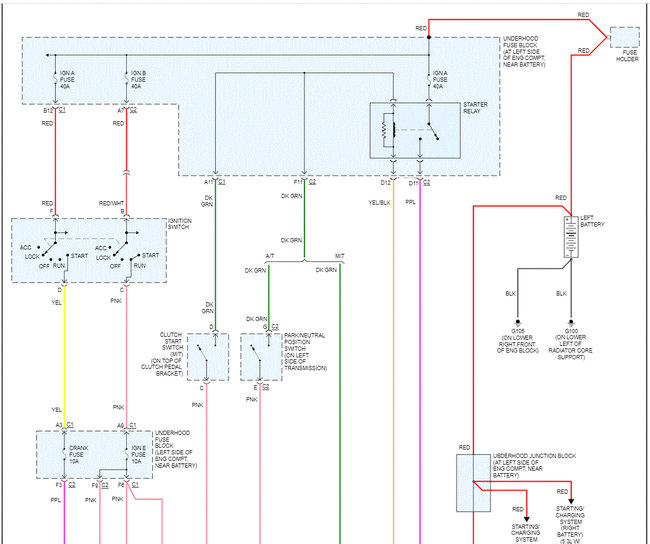

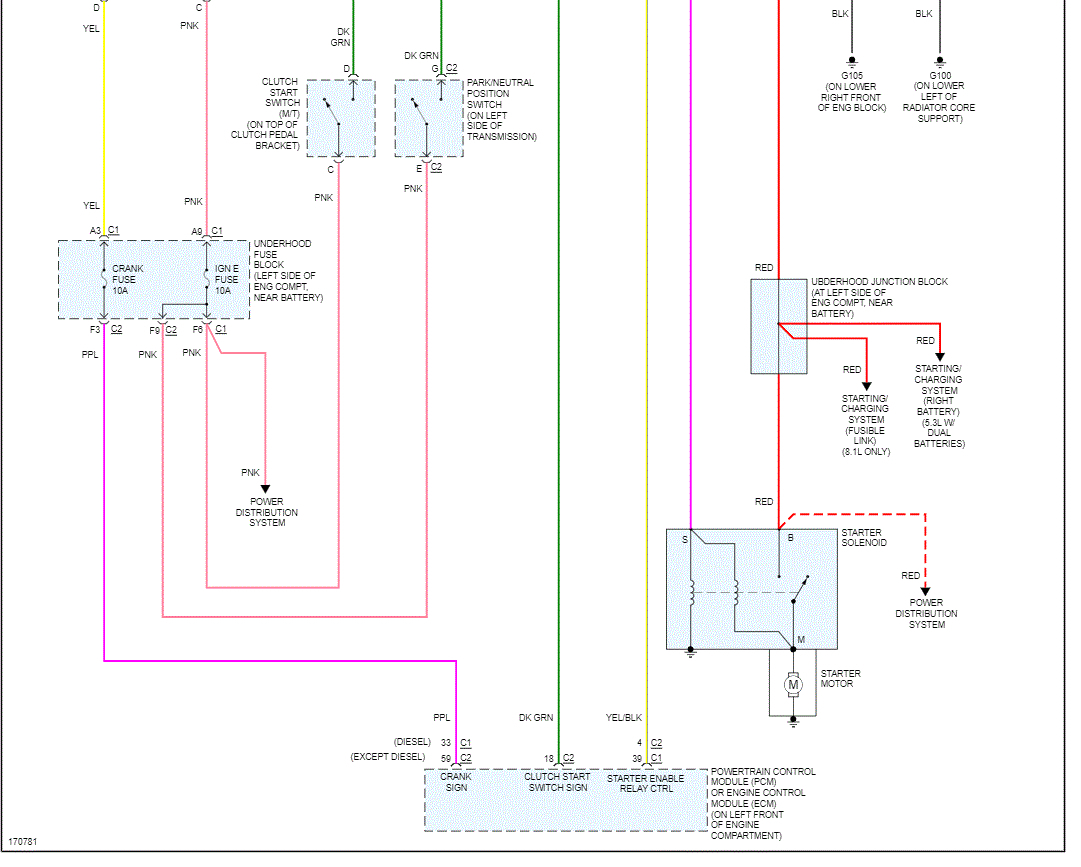

My truck listed above is a 1500. It had a short somewhere on engine harness. I changed my computer and engine harness. I did an anti-theft key relearn procedure and all get is click from starter. I ran code and had p0315 crank sensor not learned. Do you think I need to change the crank sensor? Or how should I proceed to get it running?

The idea that you only get a click (the starter doesn't turn the engine) sounds like a connection issue. This is not related to the relearn procedure for the new CKP.
Is the battery fully charged? Are the battery terminals clean and tight?
Do me a favor. Try this very basic load test on the battery and let me know the results:
Please keep in mind if you have a click which indicates the system is sending power to the smaller wire on the starter as it should. At that point, a circuit is completed in the starter, and it engages the starter motor which is powered by the heavy gauge wire directly from the battery. So, if you hear the click, either the starter is bad, the engine is locked, or there is a weak connection to the starter motor.
See pics below for the starter circuit wiring schematic. You can use this as a reference. However, check the two things I mentioned, and make sure you didn't leave any connectors (positive or negative) loose.
Additionally, take a look through this link. You may find it helpful.
Let me know what you find.

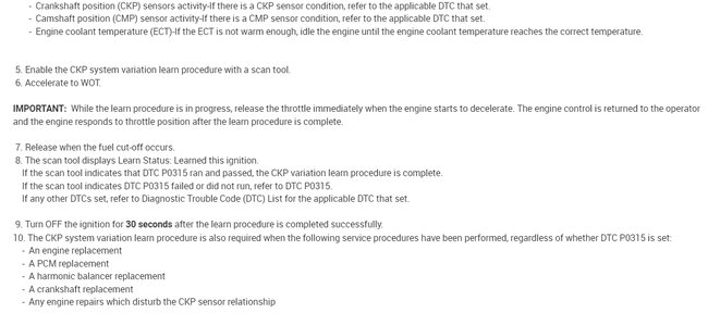

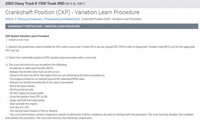

Just to let you know it was a shorted wire to the starter fixed it, got truck running. Running well but have crank sensor not learned. I don’t have a scanner that can do that, but I saw a way to do it by driving it in a certain sequence. Please let me know if you think it would get rid of code.
Thanks
Mar 31, 2022 at 6:55 PM
  • 110,194 POSTS

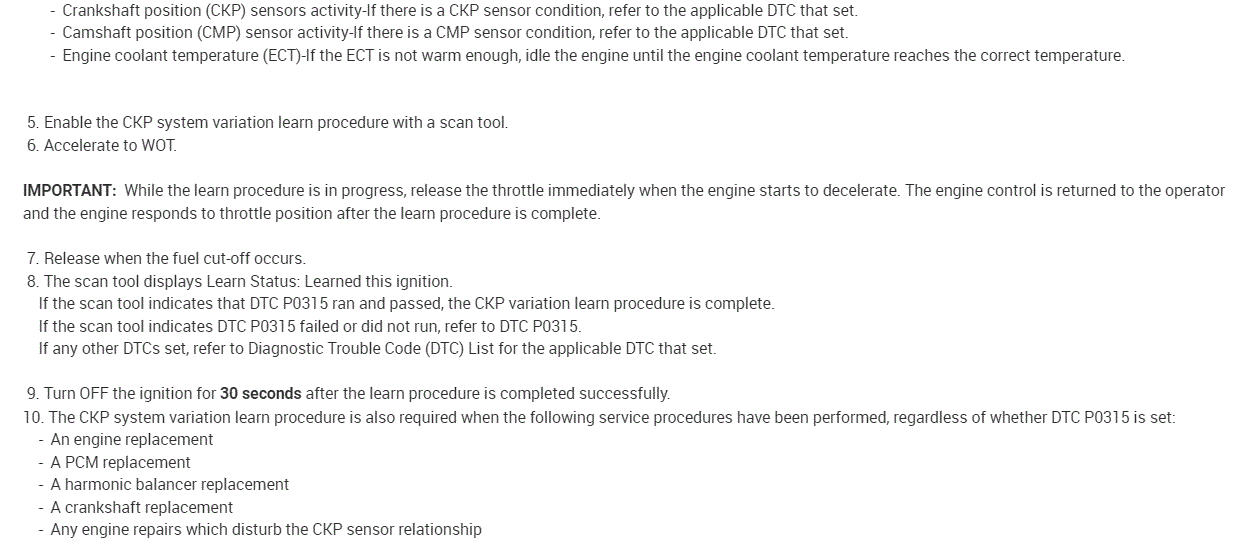

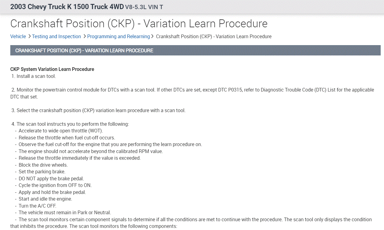

There is what is referred to as a variation relearn. Without this, the vehicle should still run okay but the P0315 may return.
The Variation Relearn for the CKP requires a scan tool that can communicate with the PCM. I am not familiar with any other ways to do it. If what is being suggested is simple, it won't hurt to try.
If you look below, I have attached the directions for the procedure, so you have a reference.
Let me know what the person indicated as an alternative method. I'm interested in knowing.
