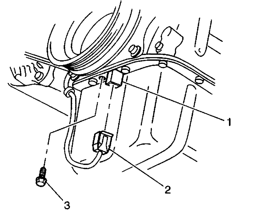

Crank sensor location needed.
Jan 25, 2023 at 7:21 PM
AL514
Experienced Mechanic
5,692 POSTS

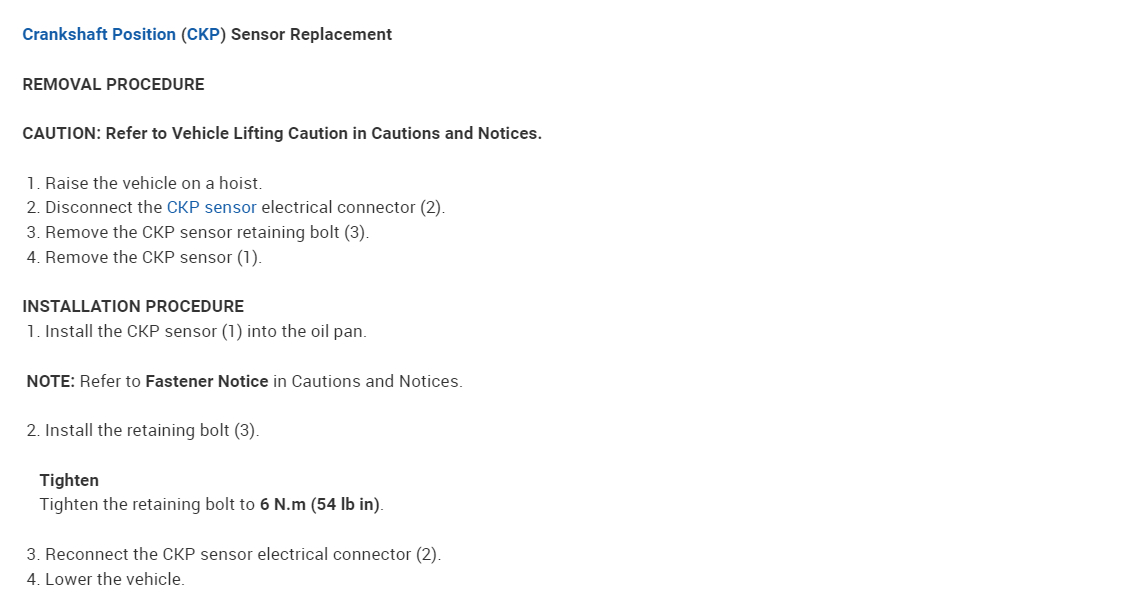

Hello, the crankshaft position sensor is just below the harmonic balancer on the front edge of the oil pan, I'll post a diagram.
Check for oil inside the harness plug for the sensor.
