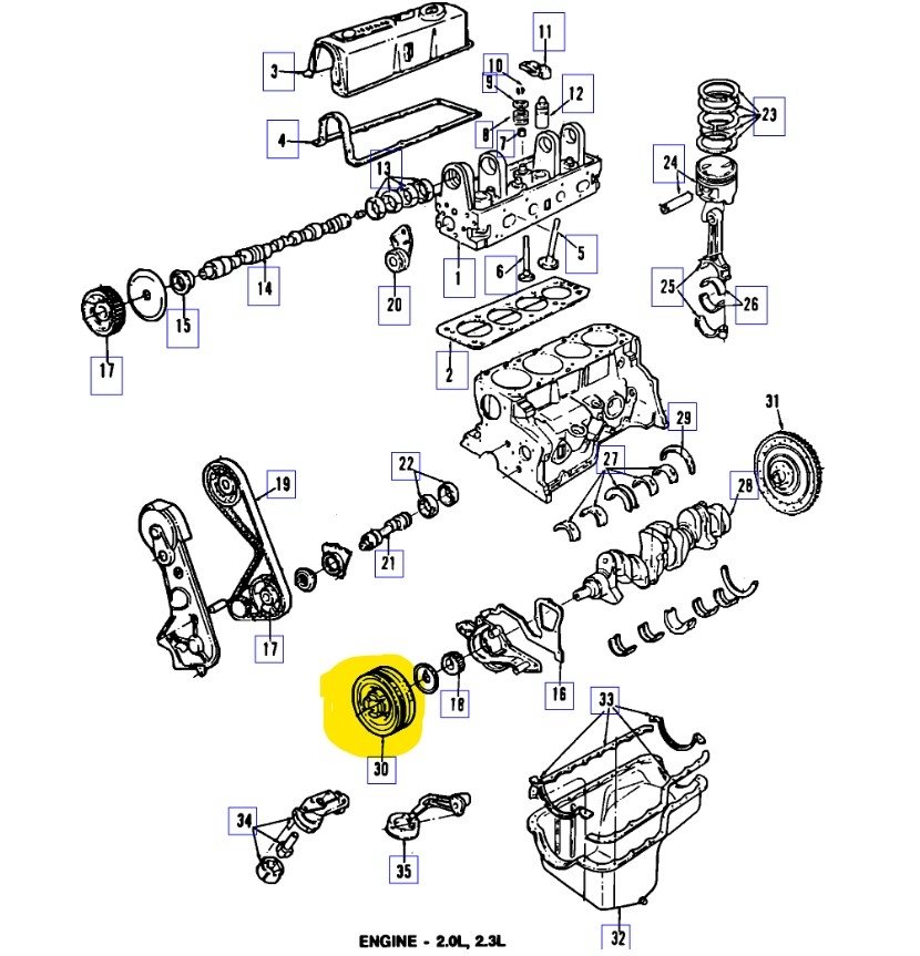

I am trying to get the crank pulley off; do i need a holder tool? Also, what size is the bolt?

If you're referring to the harmonic balancer pulley (highlighted in the diagram below), the vibration dampener bolt should be about 7/8" in size. Using an impact air ratchet is usually helpful in removing that bolt. You will also need a puller tool to remove the harmonic balancer, which you may be able to rent from your local automotive parts store.
