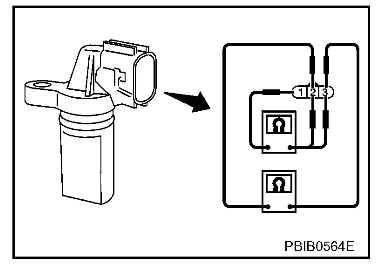

The vehicle seems to be in some sort of limp mode. a code popped up p0335 for the crank positioning sensor, but when I replaced it it's still there and still doing the same thing. Please help.
Nov 17, 2022 at 4:10 AM
  • 110,248 POSTS
Is this the only code present? Also, did you delete it and then it came back or wasn't it deleted at all?

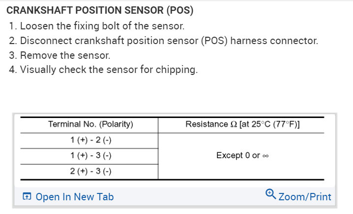

Do me a favor. I attached the directions and specifications below related to the sensor and checking it. Do this and let me know the results. Do it on the original sensor you removed. If it checks good, then I know you have a wiring issue.
Let me know what you find.
