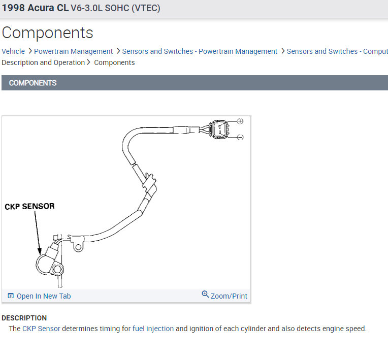

Where are the crank position sensor and CAM position sensor located?
SHADOWENELI
  • 1998 ACURA CL
  • 3.0L
  • 6 CYL
  • 150,000 MILES

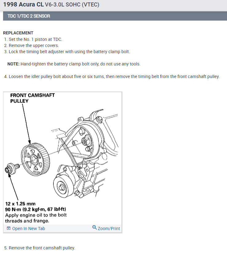

Needing the location of the crank position sensor and cam position sensor in my buddy's car (listed above).
Friday, July 30th, 2021 AT 11:42 AM
SQM
  • 6,383 POSTS

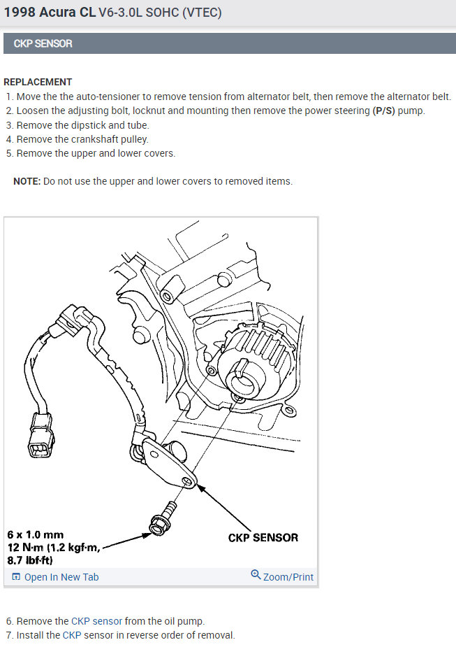

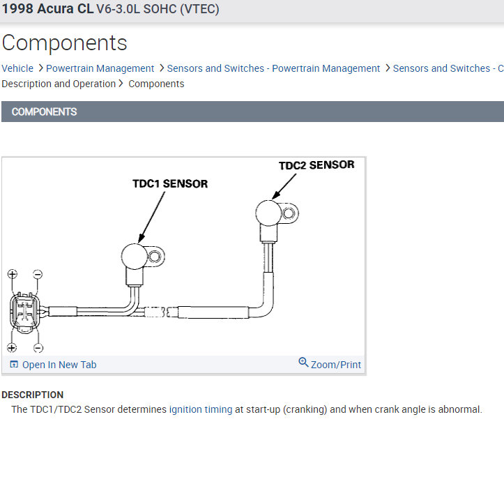

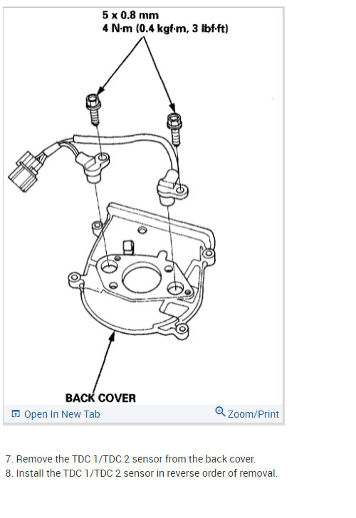

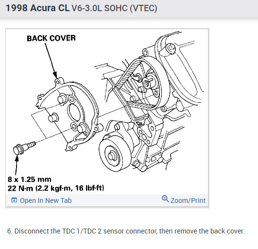

Acura calls the cam sensor as TDC sensor and the crank sensor CKP sensor.
Please see attached diagrams for the location and replacement procedure.
Are you getting trouble codes related to those sensors?
