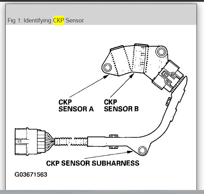

I'm getting no fire on two coils. I had it put on the computer a few weeks ago and 300 through 306 popped up on the computer telling me that all cylinders was misfiring, but the code for the crank position sensor did not come up. could it still be the crank position sensor?
Apr 30, 2019 at 8:36 AM
SCGRANTURISMO
  • 4,897 POSTS

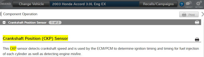

Yes, it probably is. The Crankshaft Position Sensor is responsible for the ignition timing as well as misfire monitor on your vehicle. I have included a description of it in the diagrams below. I have also included a few links for you to go to down below:
https://www.2carpros.com/articles/how-a-crank-shaft-angle-sensor-works
Please go through these guides and get back to us with what you find out.

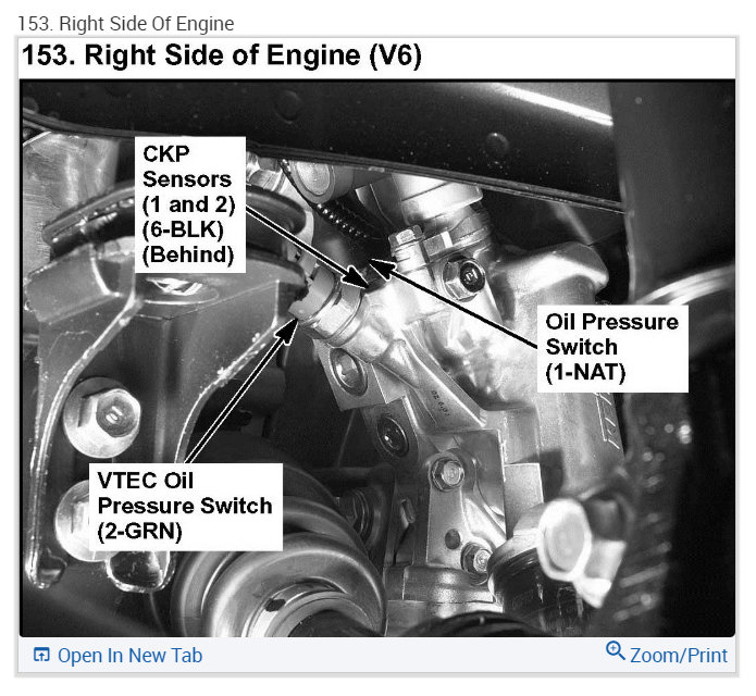

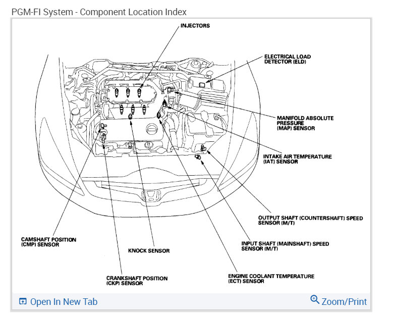

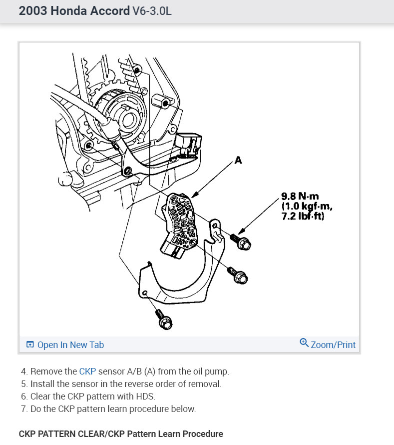

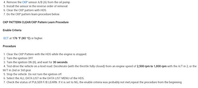

Here is the diagrams and instructions on how to replace the crankshaft sensor on your car. Check out the diagrams (below). Please let us know if you need anything else to get the problem fixed.
