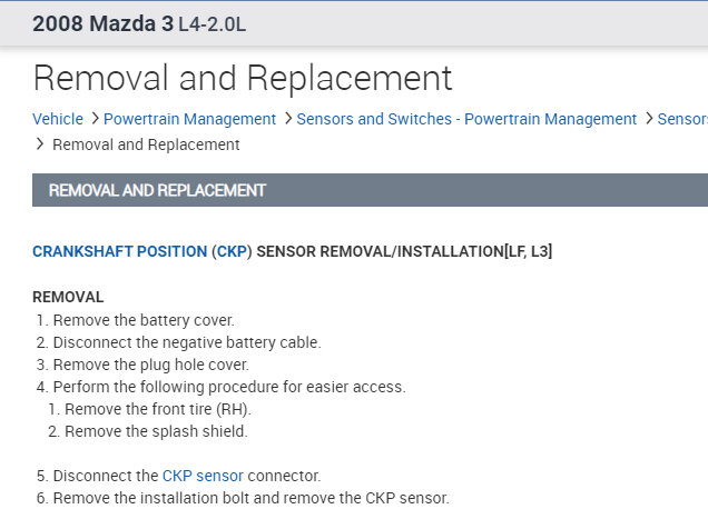

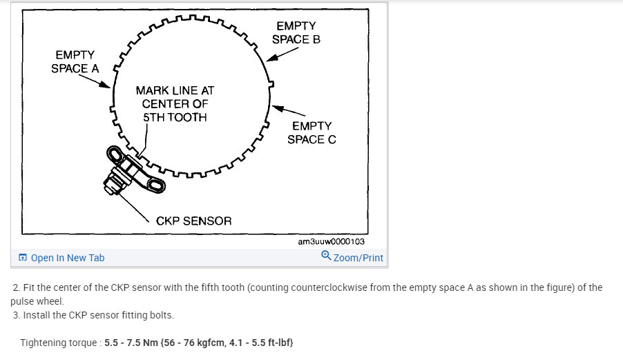

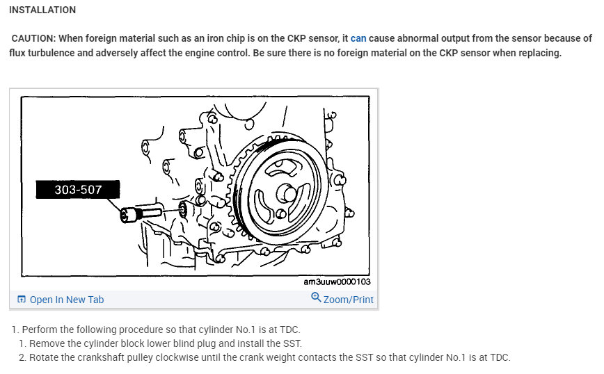

Replaced the head gasket and all necessary gaskets cranks strong acts like it's wants to start but doesn't start. I need to know how to place the harmonic balancer in what exact position and also the CPS exact position or on what tooth to set it on.
Jan 2, 2023 at 7:32 AM
  • 110,241 POSTS

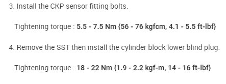

I attached the directions below for alignment and removing and replacing the sensor.
I'm not sure what you're experiencing, but if the crankshaft sensor is bad, in most cases you will not have spark to the plugs.
Take a look through the directions below and let me know if you have questions.
