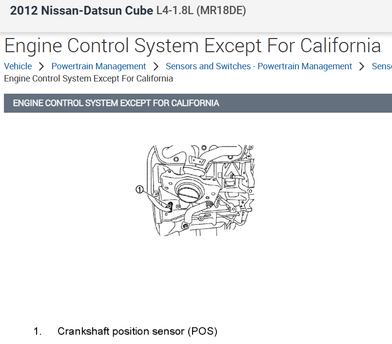

Crank shaft position sensor location needed.
Mar 2, 2025 at 1:34 AM
NOE MAURICIO DELGADO
MEMBER
2 POSTS
I fixed it.
Mar 2, 2025 at 3:06 AM
Experienced Mechanic
55,628 POSTS
The crankshaft sensor is located down low on the block, near the rear, under the exhaust manifold. Check out the images (below). Let us know if you need anything else.
