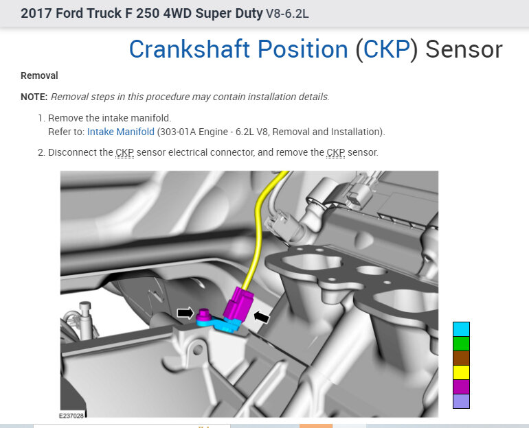

Where is the crank position sensor located?
2017 FORD F-250
58,000 MILES • 6.2L • V8 • 4WD • AUTOMATIC
FXAVIER21

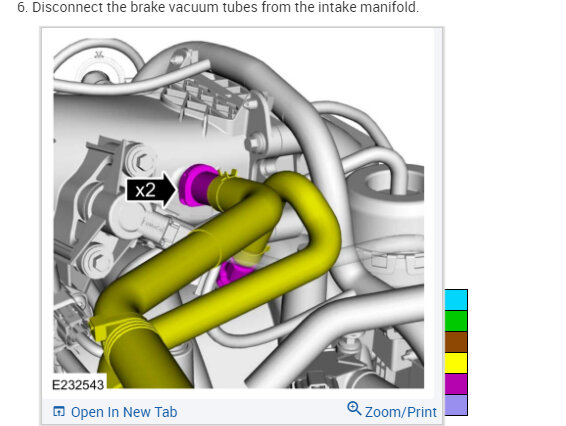

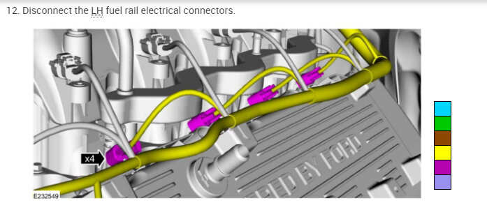

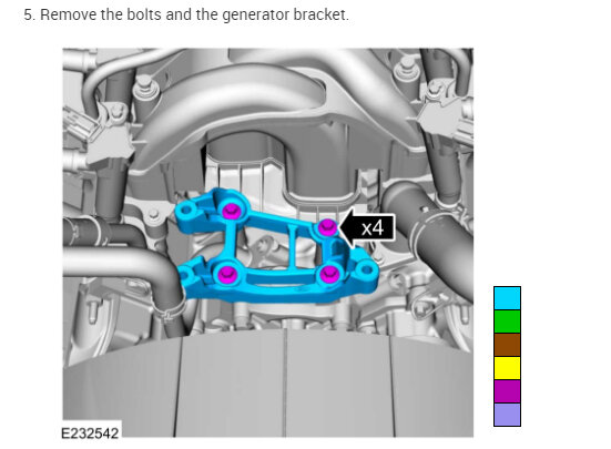

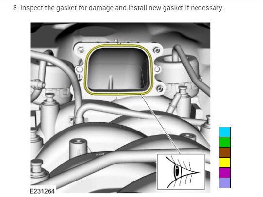

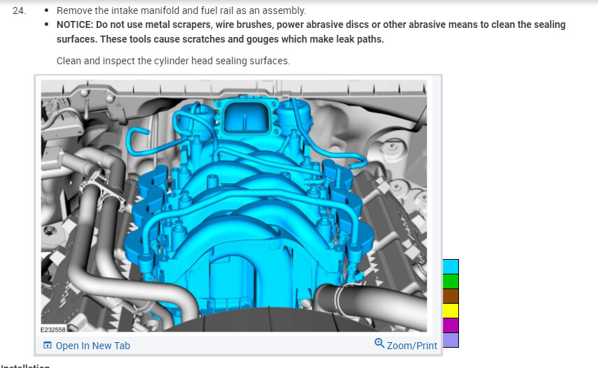

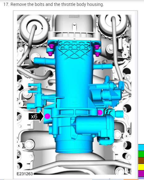

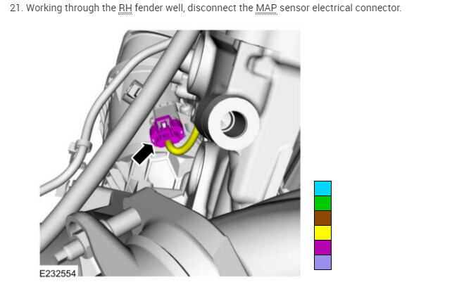

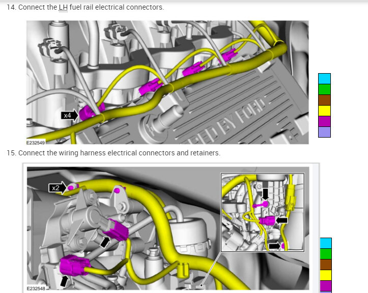

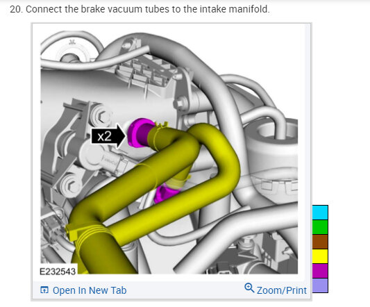

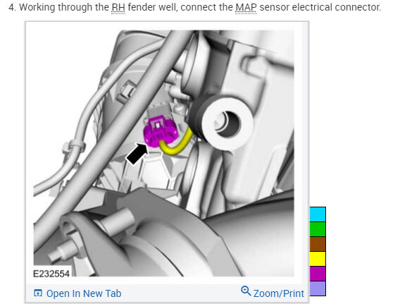

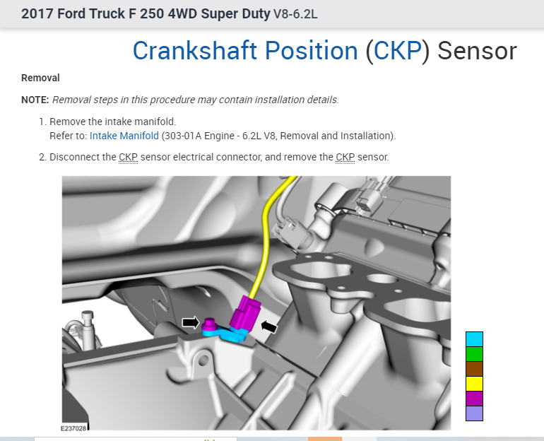

looking for the location of the crank position sensor.
Jun 22, 2023 at 11:34 AM
  • 110,240 POSTS

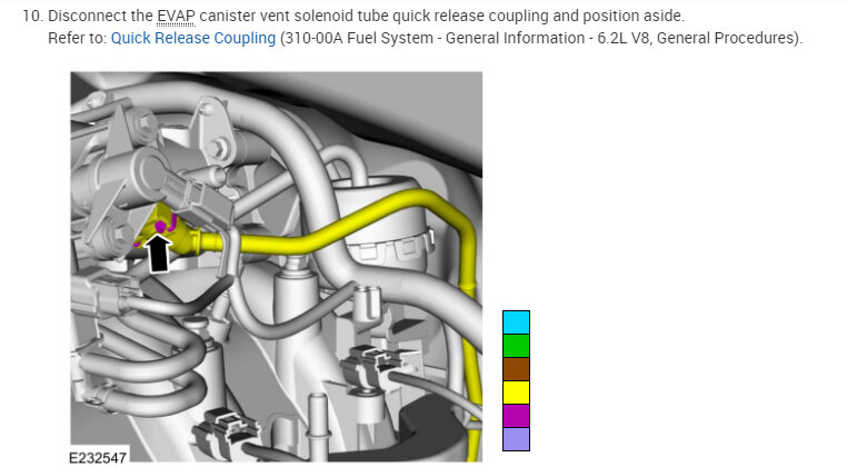

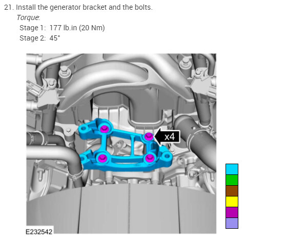

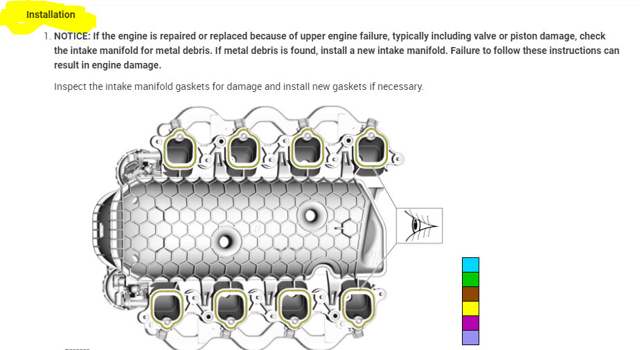

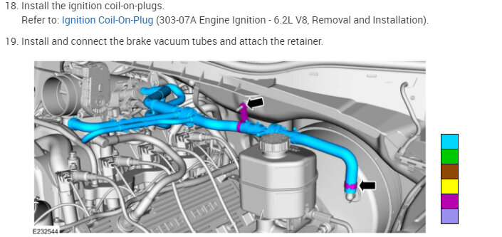

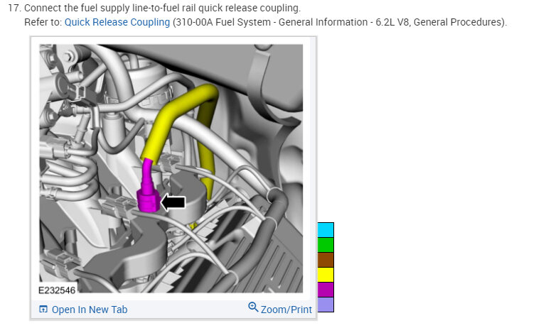

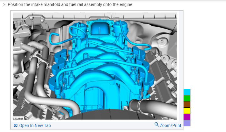

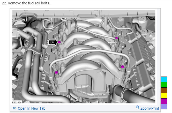

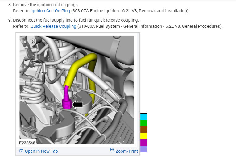

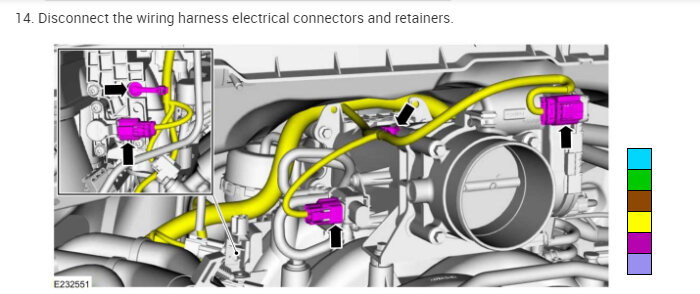

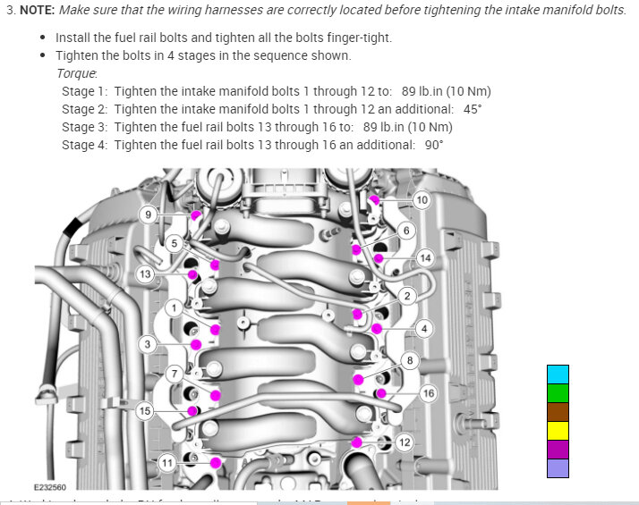

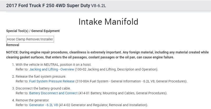

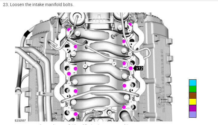

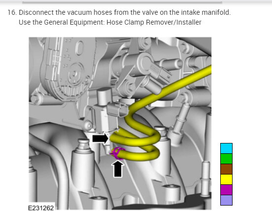

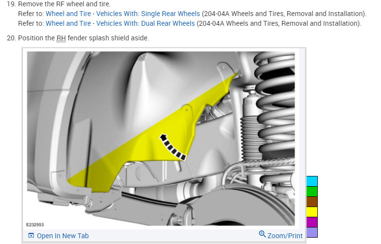

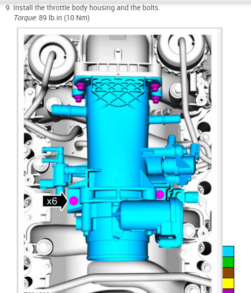

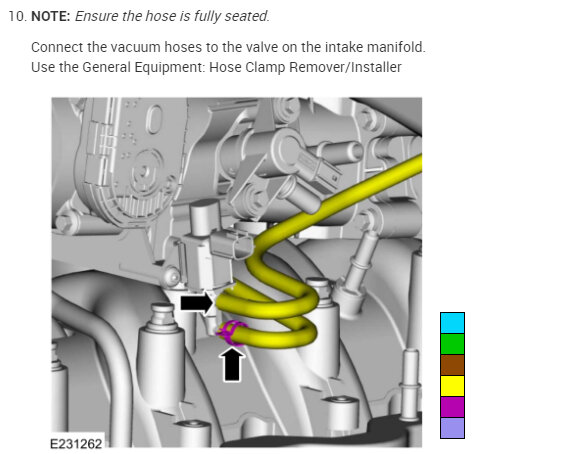

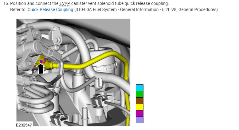

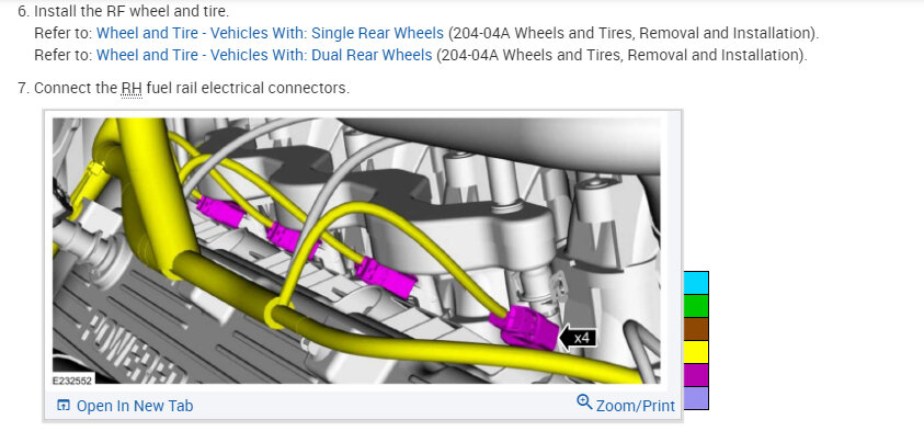

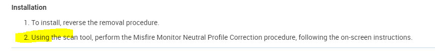

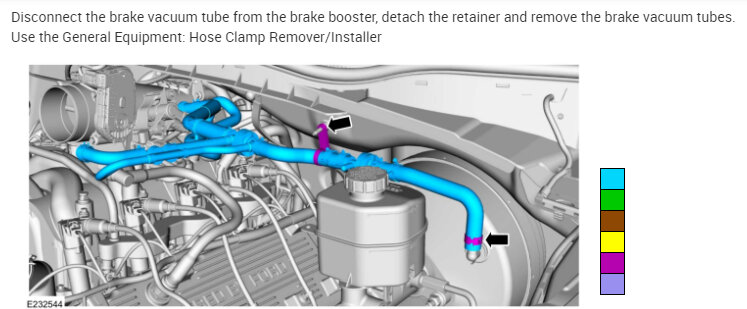

Believe it or not, they put it under the intake manifold. So, the manifold needs removed.

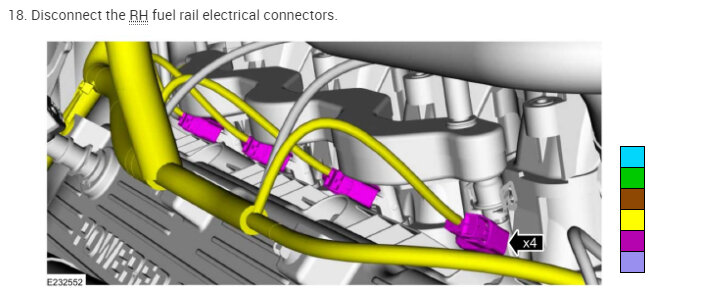

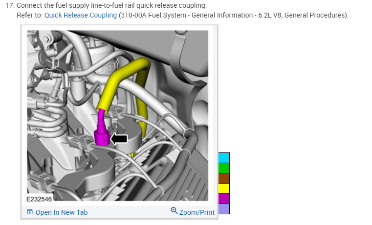

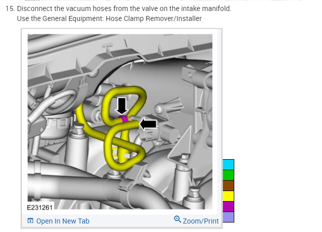

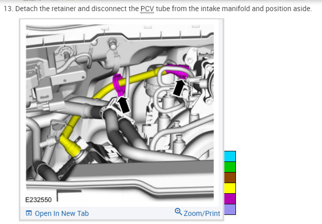

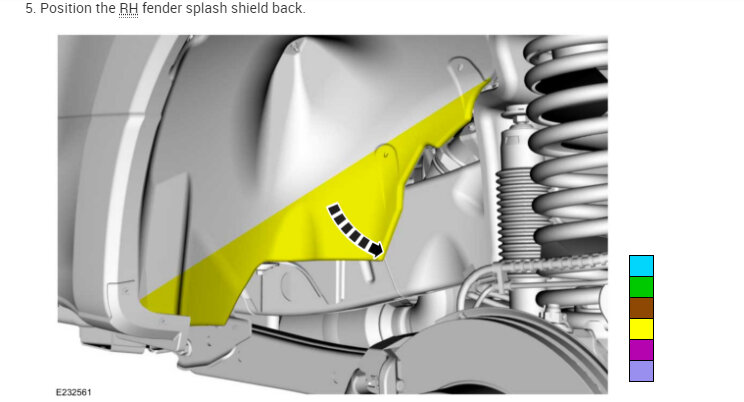

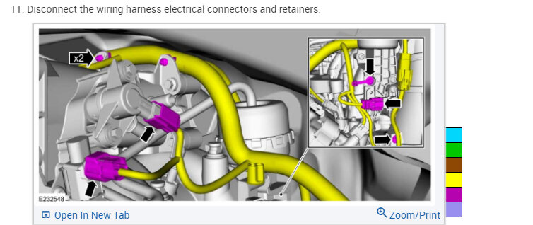

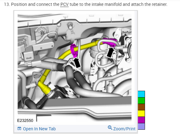

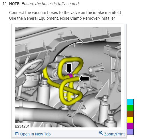

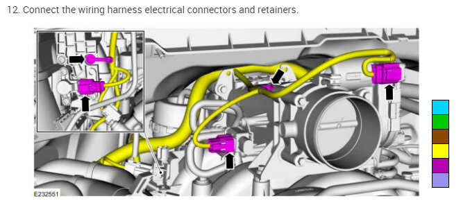

Pics one and two below are the removal and installation of the sensor. The remaining million pics (lol) are for the removal of the intake. I have no idea why they design things this way.
