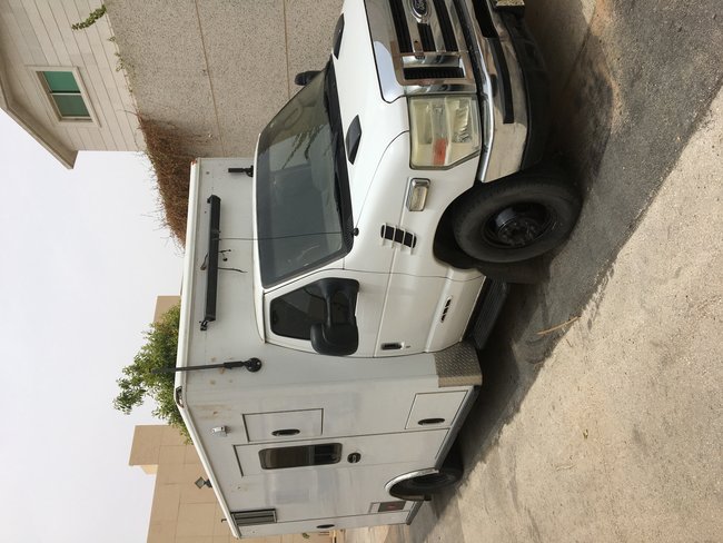

Dear sir, i have a Ford e450 diesel 6.0 year 2010. My problem i crank but wouldn't start but when I sprayed as shown in video start right away. i drive everything is perfect even i stop the car for 3 hours and crank start fine without spree. But my problem if i park overnight and after approximately 10 or 11 hours when crank wouldn't start, so I have to do the spray process again to start and so on. I checked the oil regulator. It seems fine i was wondering if it is a fuse or sensor. where is it located? If this is the problem where can i look to solve this problem? Thank you. Pic for the car and two videos explaining what i did.

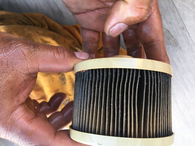

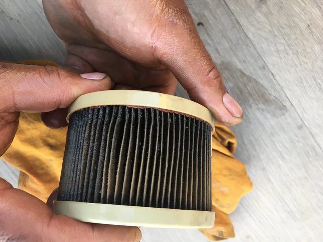

After i sent replay i checked the fuel filter under chase and this is how it looks. i will buy new hopefully this is the problem.
Thanks
Aug 20, 2022 at 1:04 AM
AZZAM12AZZAM
  • 86 POSTS
This is.
Aug 20, 2022 at 1:05 AM
  • 110,240 POSTS
That certainly can be at least part of the cause. If you have a chance, could you let me know if it helps? I'm interested in knowing.

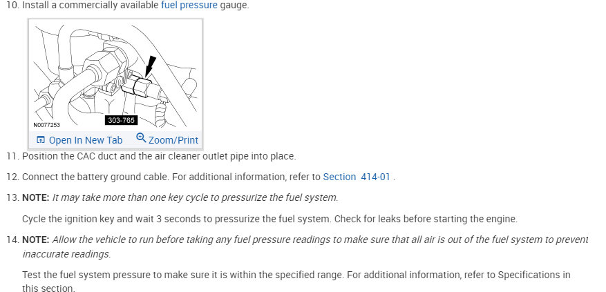

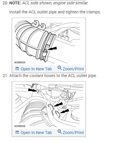

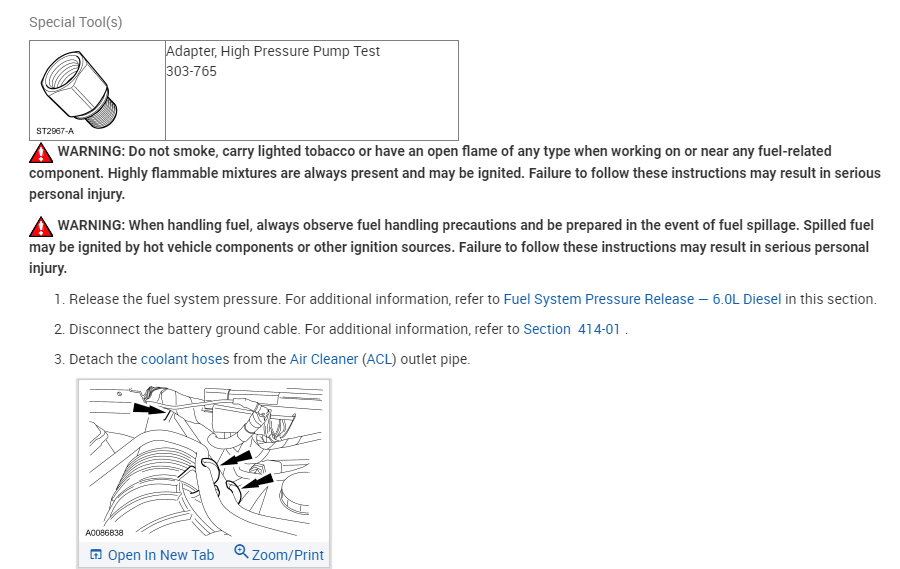

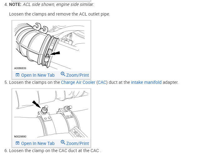

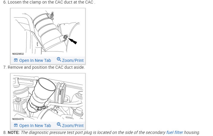

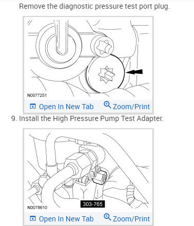

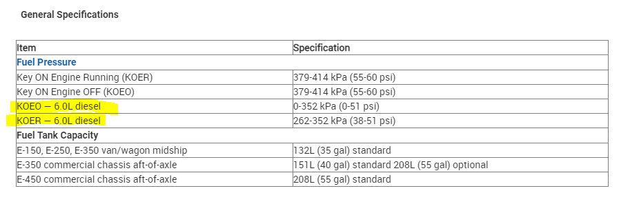

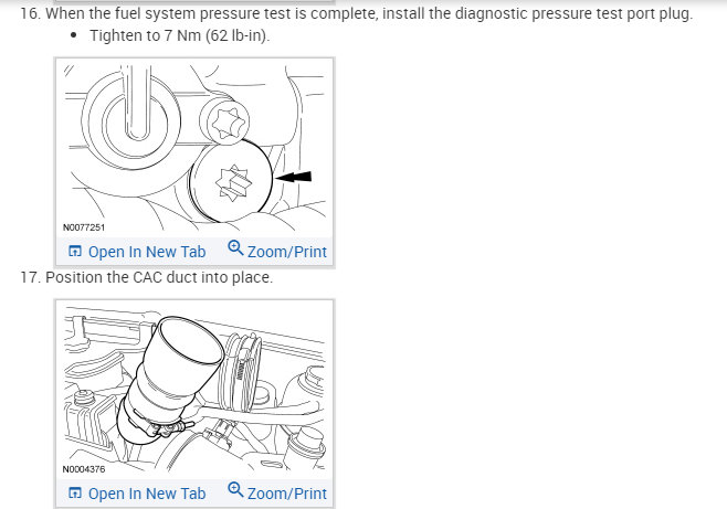

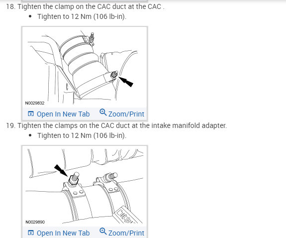

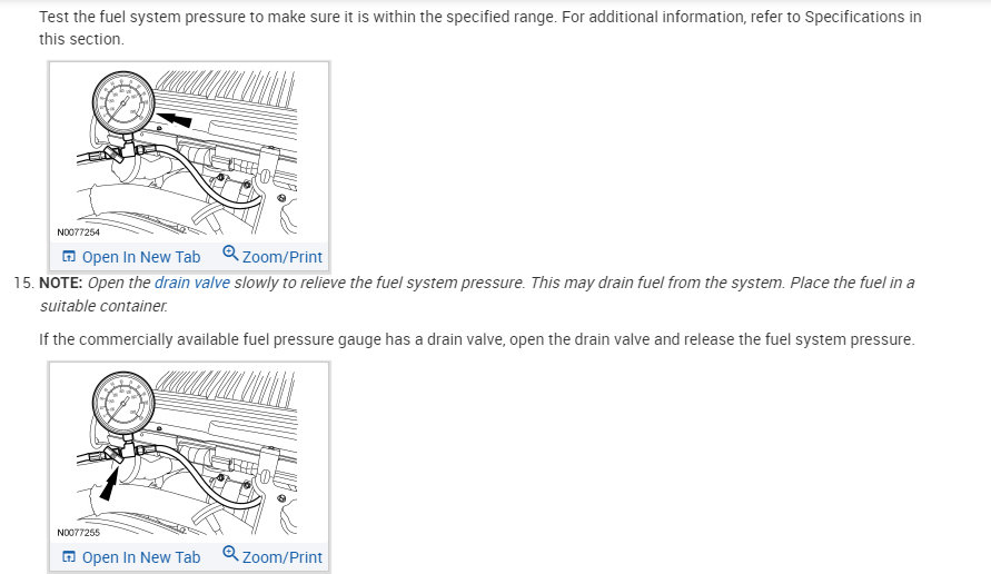

Also, the next step would be to test the fuel pressure to see if it jumps to the manufacturer's specifications.

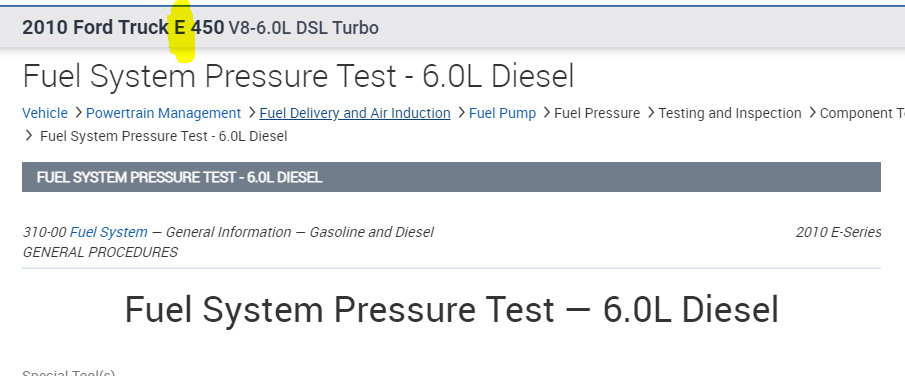

If you look below, I attached the directions. The last pic has the specs. Also, the 6.0L wasn't offered in the F series. It was in the E series. Could you confirm that for me?

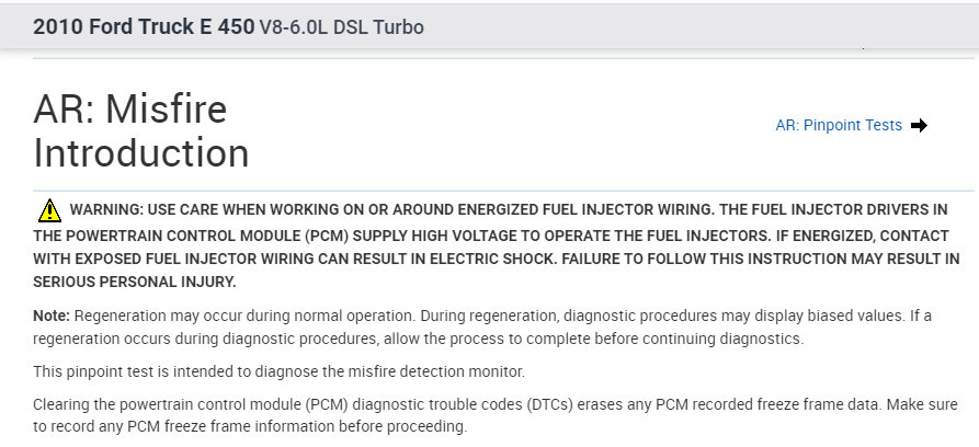

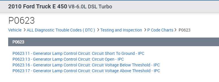

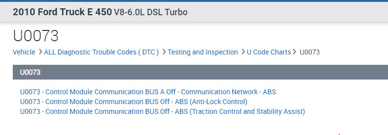

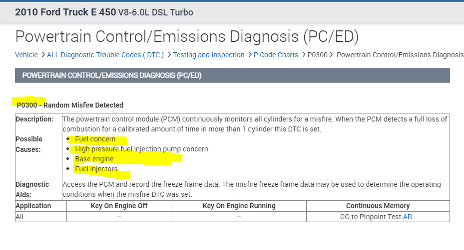

It took some time to for the job, we checked the fuel pressure was in range also no bubbles i have but nre ipr and EGR new oil and filter i still have the same problem sometimes it start after long crank sometimes with spray but i notice when it is hot start right away within 2 second i scan with OBD i got these code:
U0073
P0623
P300a
Even though I am not sure the guy who did this scan professional
I suspect may be sensor i will keep tracking but does the code above mean something that helps.
Thanks Joe.
Sep 15, 2022 at 9:09 AM

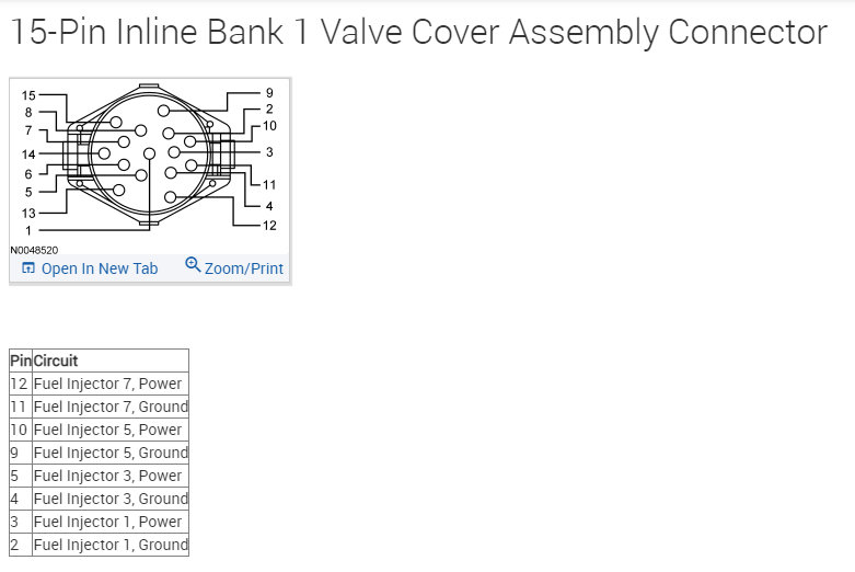

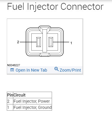

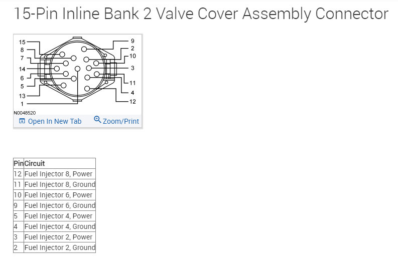

  • 110,240 POSTS
The P0300 is likely related. It indicates a random misfire. The other two codes are not related. One is an issue with the ABS, and one deals with the alternator lamp. If you look at the first three pics, they indicate what each code indicated.
The remaining pics are to check the misfire monitor. Check to make sure there are no wiring issues.

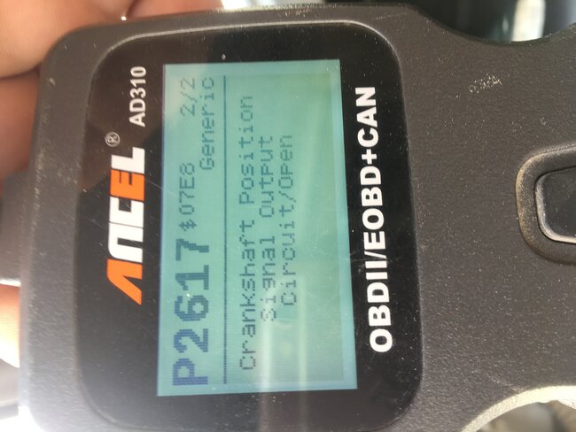

If i may ask, while i was trying to figure out where is the problem i have installed a new camshaft i had these code in OBD but did not come again. may I know what's that and how to fix it in case appears again?

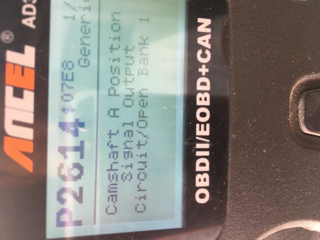

These codes:
P2617
P2614
Oct 5, 2022 at 7:04 PM
  • 110,240 POSTS
Both codes indicate an open circuit. Have you checked for damaged wiring, a faulty connector, or anything that may prevent the circuit to be completed?
