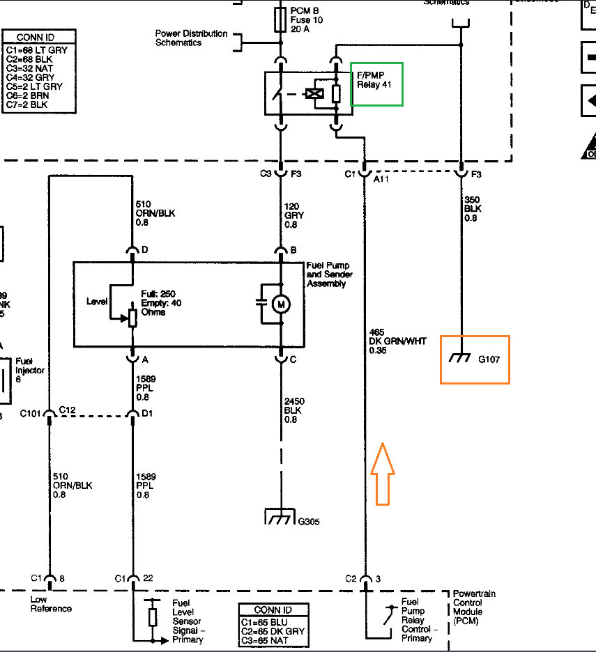

spark plug yes spark, no pressure pump not working. fuel pump relay pin 30 12v, pin 85 from PCM no voltage with test light key on position , pin 86 no ground and if I jump pin 87 with pin 30 the pump works and I can start the truck.
Oct 28, 2023 at 9:18 PM
DANIEL.OFARRELL
I just checked again for the voltages and here is the results pin 30 12 volts, pin 85 from PCM 12 volts with key in on position with a meter and the test light lights up but just for a few seconds and with test light it does not light up with key in off position and with pin 86 there is a ground and pin 87 if jumped with pin 30 pump works .

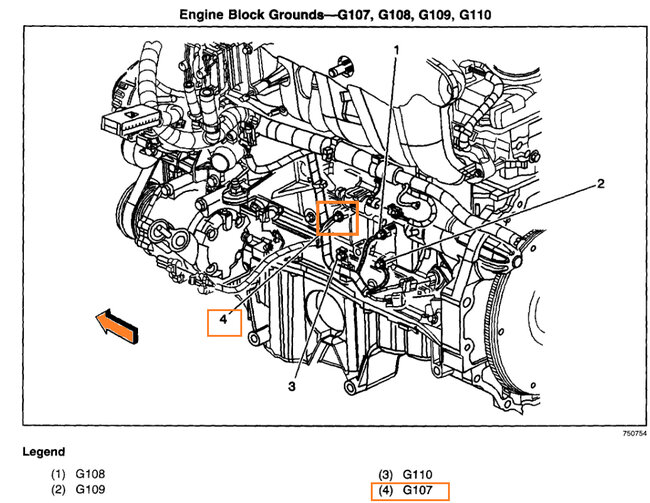

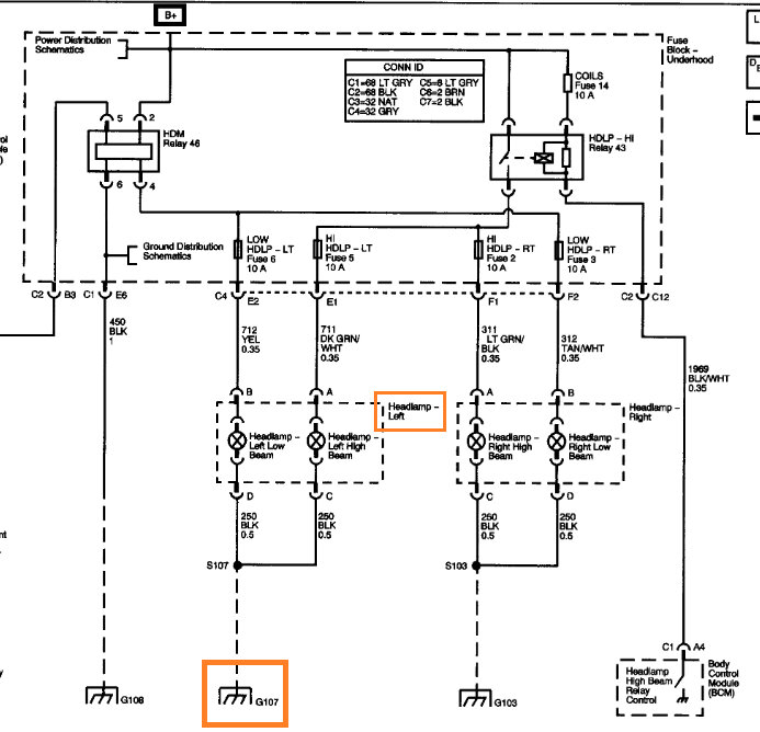

Hello, it looks like the headlamp being dim and the fuel pump relay control are related, Ill post the diagrams for you, but the FP relay and Left side headlamp share a ground (G107).
One other thing to be careful with is testing PCM drivers like the one for the fuel pump relay with a test light, unless it's an LED test light. The drivers for relays are not high current drivers. And an incandescent test light can pull too much current through the PCM since the fuel pump relay is a power side switched relay on this vehicle.
The G107 location might need to be unbolted and cleaned up real well and check the wiring as well.

DANIEL.OFARRELL
That is one that is very hard to get to and work on it.
I saw that but I will try and do my best to clean everything up
and you are saying that is the same ground for the head light
on both sides. will check again the diagram but just the same
I will clean that g107 and that will be done

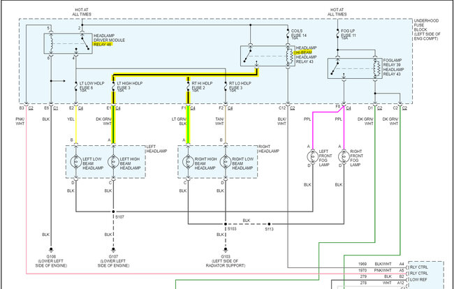

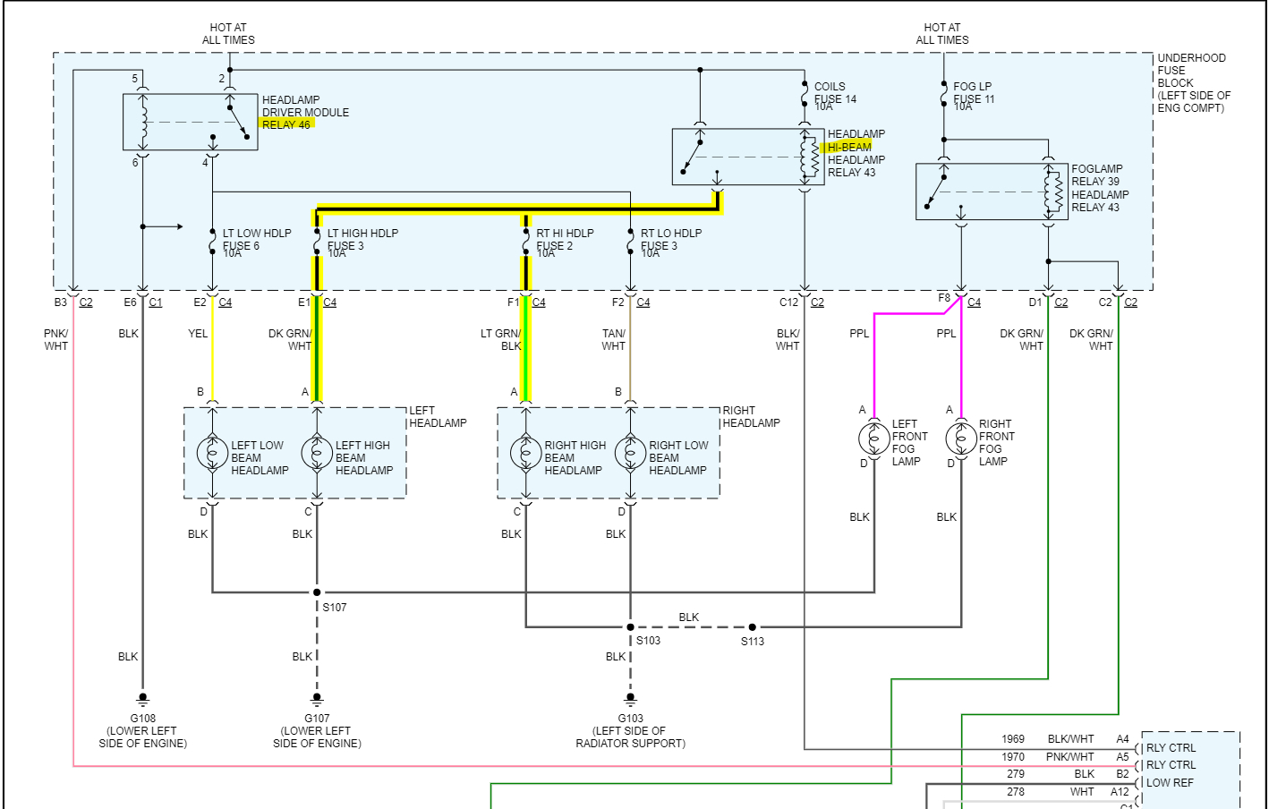

G107 is only for the driver side head lamps. I would check the voltage level at the headlamp connector with the lights on, because the headlights draw quite a bit of current, so if there is any voltage drop on the feed circuit you will see it with it on. You can also check for voltage drop from the headlamp connector feed wire to battery positive. But it depends on if it is dim for both the high beam and low beam, if it's for both then its most likely going to be a ground issue. Both High beams for left and right come from the HDLP HI Relay and same for Low beams, both power feeds come from the HDM Relay 46. So, depending on how the High and Low beams are affected, you can tell if it's a ground or power feed issue.
Here's the aftermarket diagram, it's easier to read and its correct, I verified that.
You can also run a temporary ground with a jumper lead to the battery for a quick check.
