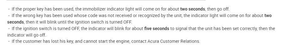

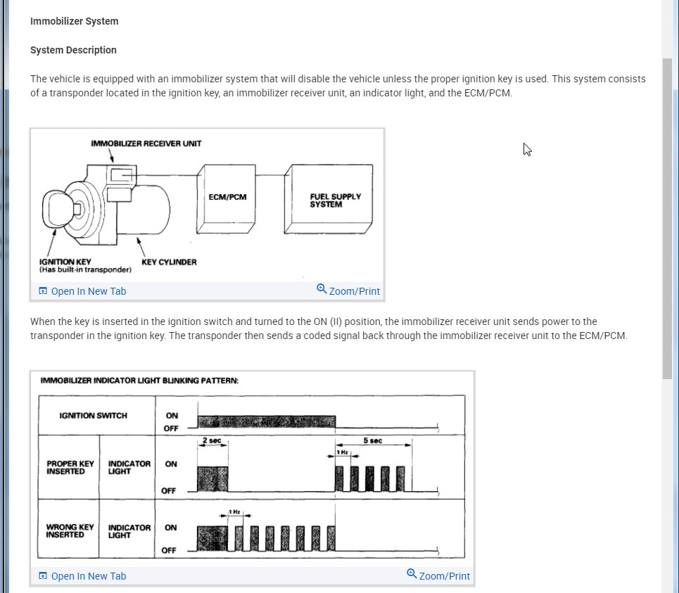

Okay. You have a security issue. The theft light not going off is telling us that there is most likely a key issue. I attached the information explaining how this works.
Do you have another key that we can try to use when this is acting up?

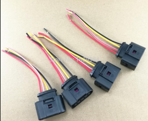

I suspect you have a loose terminal in the connector for the immobilizer.
You can take the connector apart and try to tighten it but the best way is to replace the connector with new terminals. This will require finding a connector kit that is most likely available through the dealer. I attached a picture of a kit just so you understand what it is. This would require cutting the old connector out and soldering in the new wires.
Let's start with contacting the dealer to see if they have then available because I am not finding any online.
