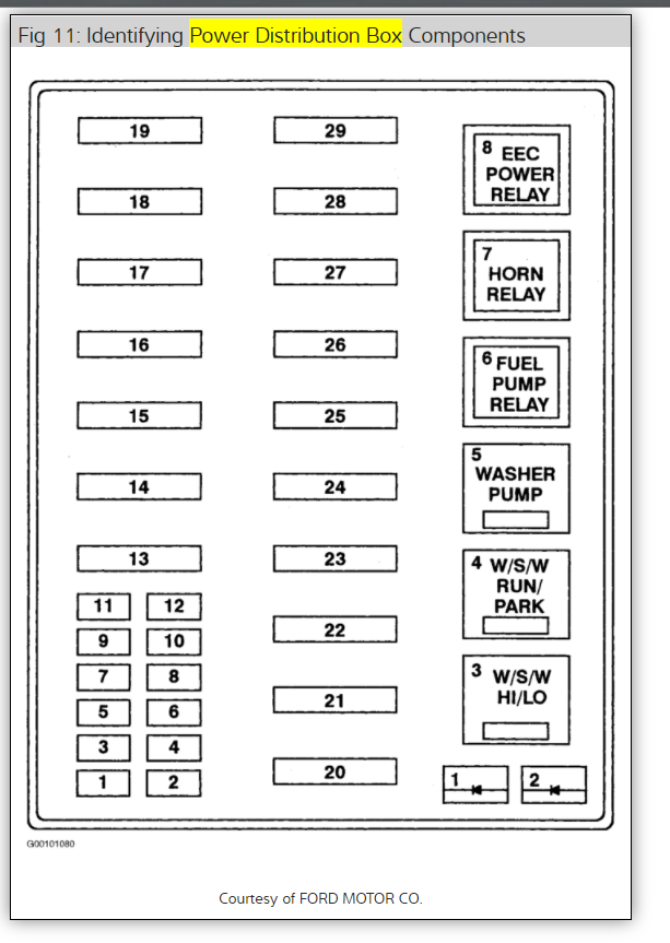

This sounds like a fuel pump or the crankshaft angle sensor has gone out. When you turn the key to the on position without cranking the engine over can you hear the fuel pump run in the tank for 5 seconds?
and
Please run down this guide and report back then we can fix it.

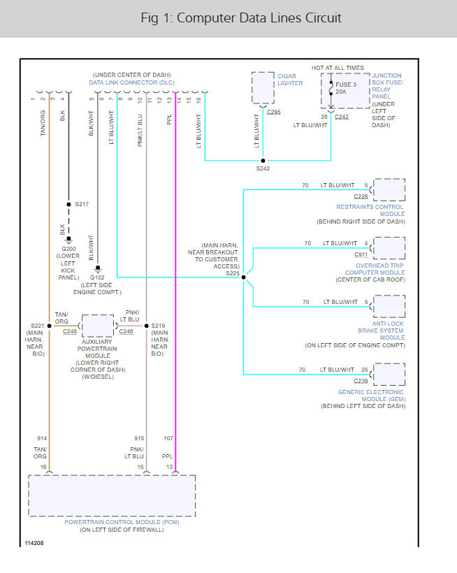

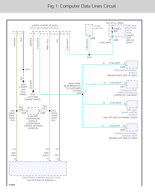

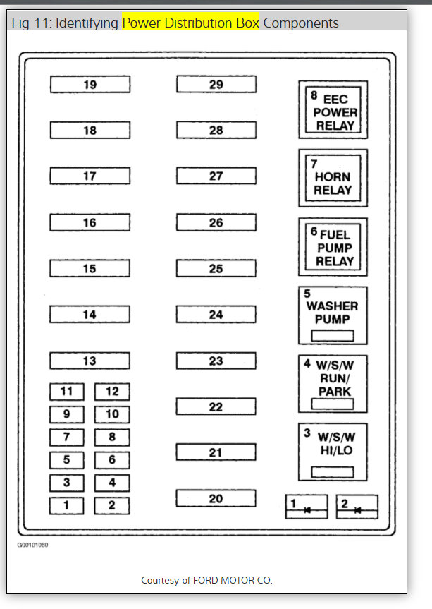

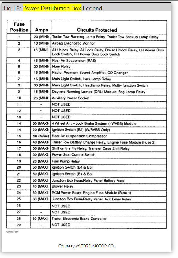

okay, let's start by checking the #3 fuse in the interior fuse panel. here is a guide and the fuse location as well:
Here is the wiring diagrams for the ALDL connector so you can see how the system works.
Check out the diagrams (below). Please let us know what you find.
