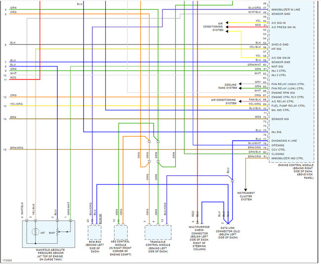

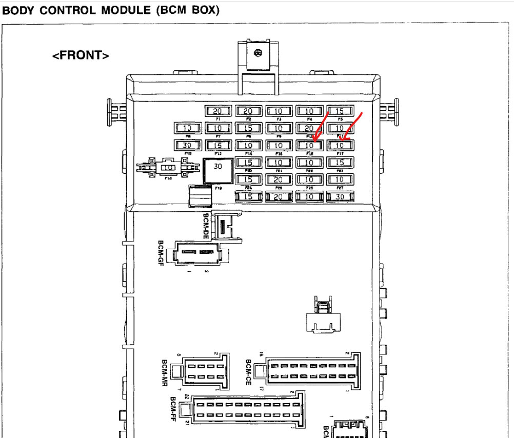

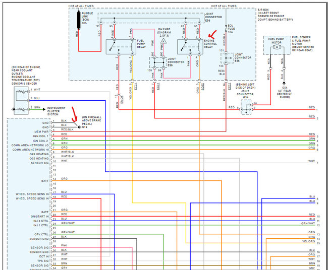

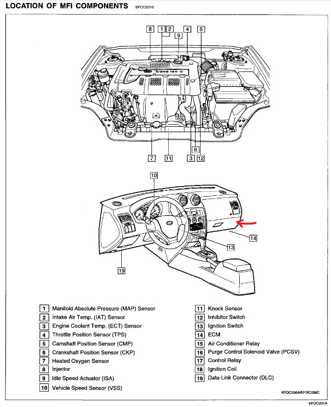

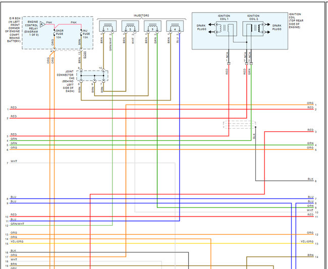

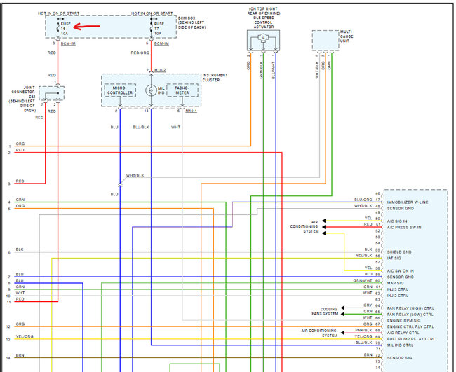

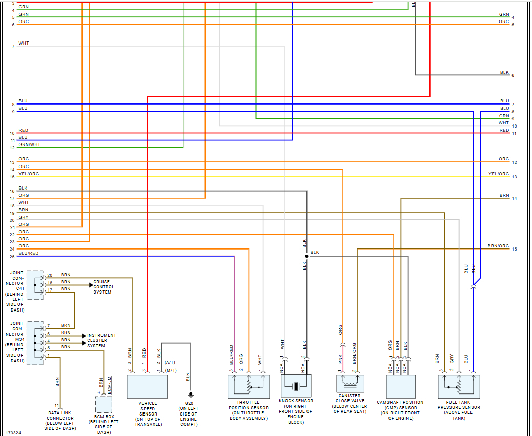

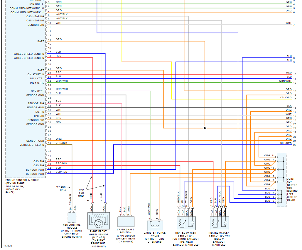

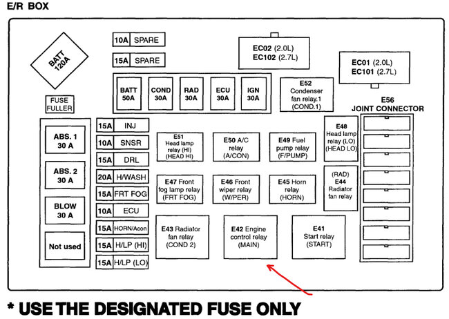

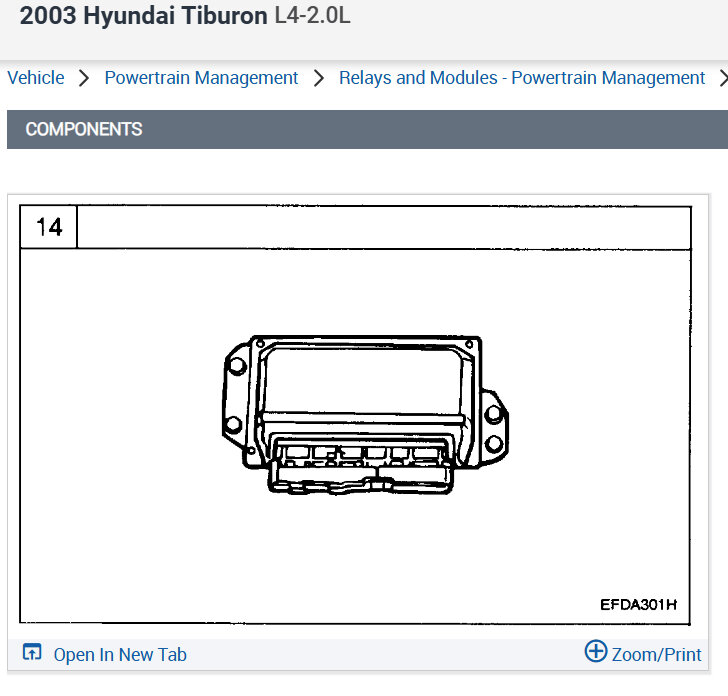

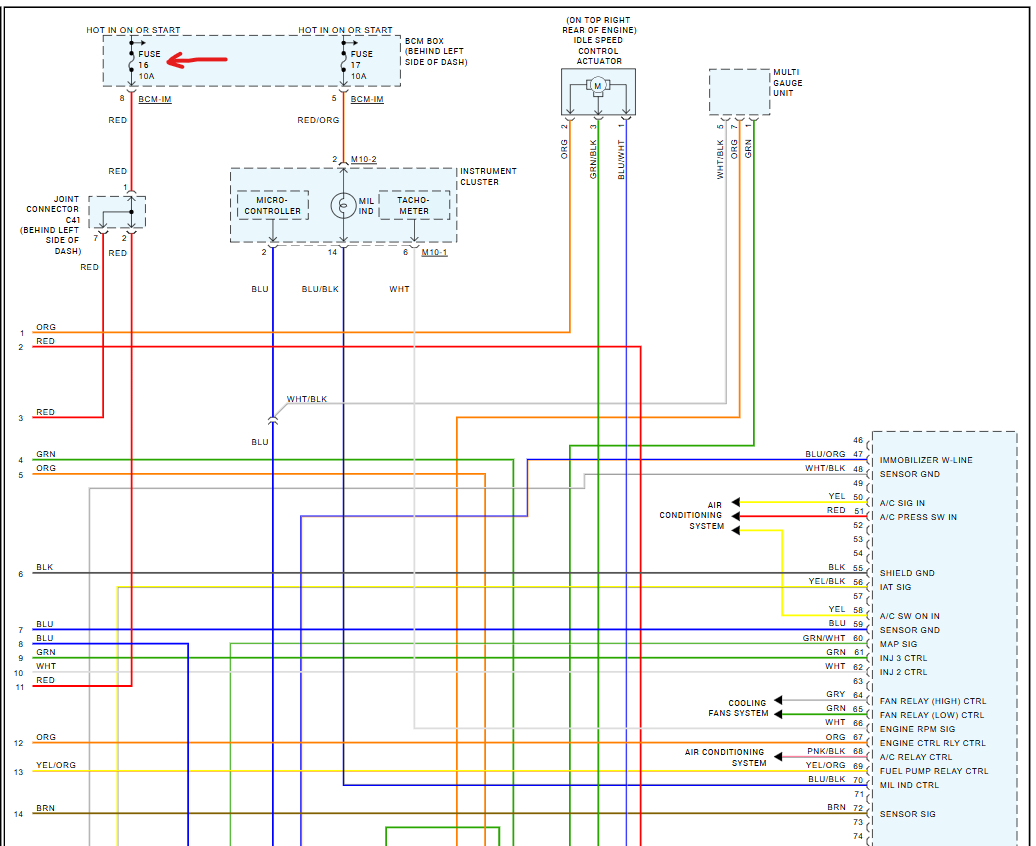

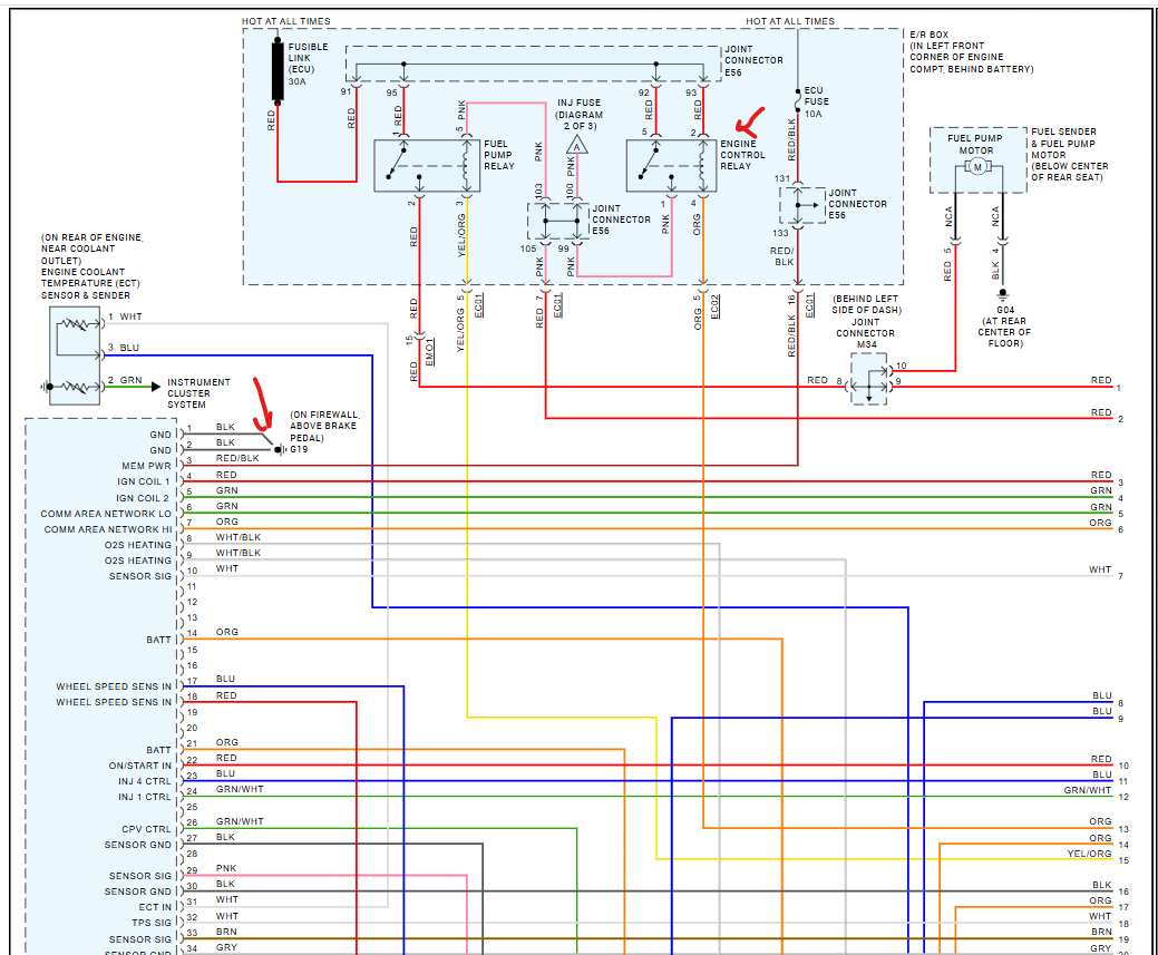

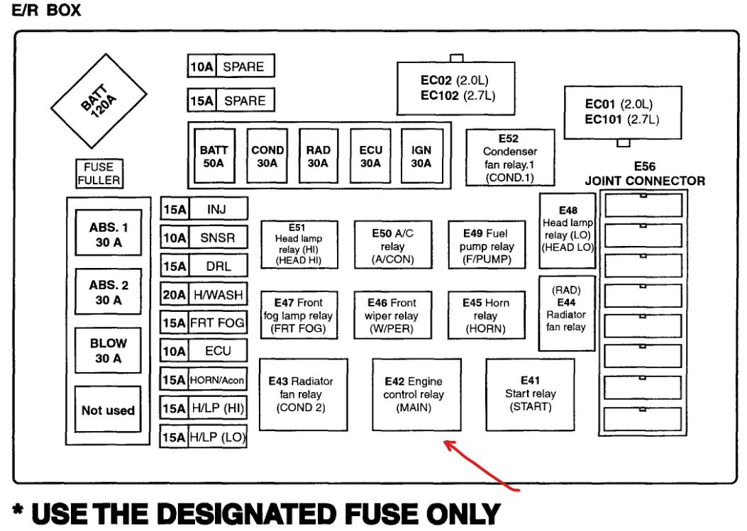

Gotcha, the scanner connected but no data and no codes. It sounds like the PCM is dead, but let's swap out the PCM power relay, check the ground for the PCM which is right above the brake pedal (G19). Also, we need to check fuse # 16 and 17 in the fuse panel inside the car. Here are two guides that will help and if none of these help I would get a preprogrammed unit by searching Google or Ebay. Here is the PCM and engine wiring diagrams so you can see how the system works, and I marked the grounds, relay and fuses to be checked.
and
Here is the location of the relay and fuses as well as how to change out the PCM. Check out the images (below). Please let us know what happens.

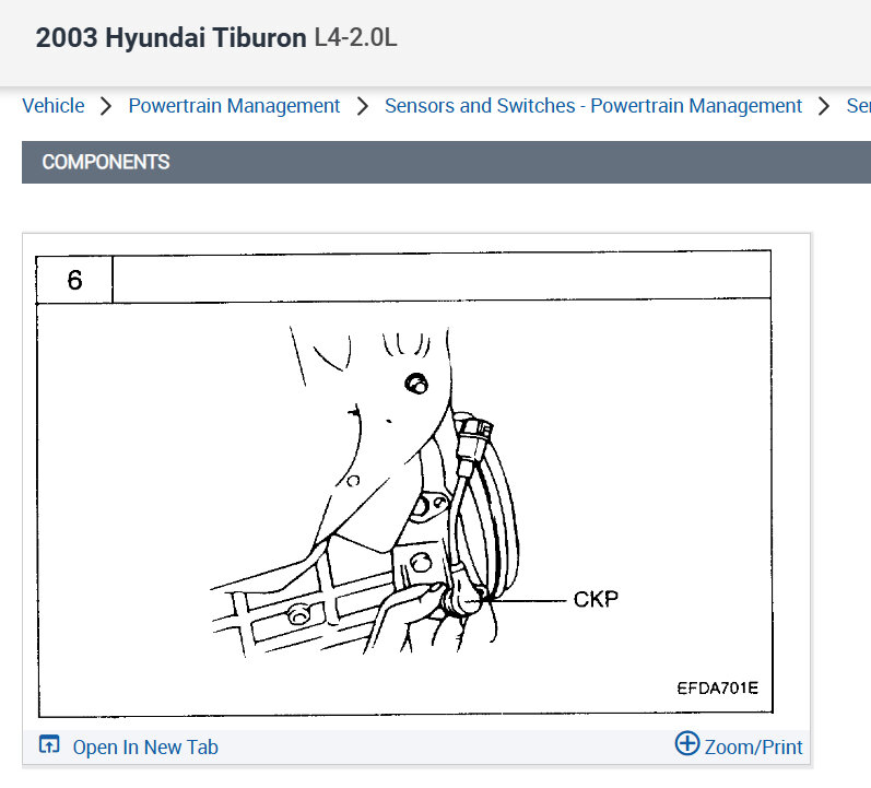

You found the problem, if the PCM does not see engine RPM it will not trigger coils or injectors, I would swap out the crankshaft sensor because it sounds like you have defective one. Here is the location so we can be on the same page. Check out the images (below). Let us know how it goes.
