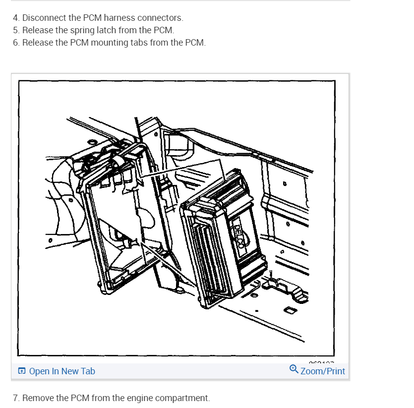

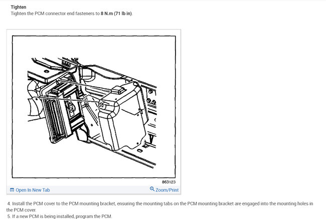

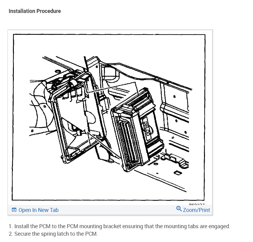

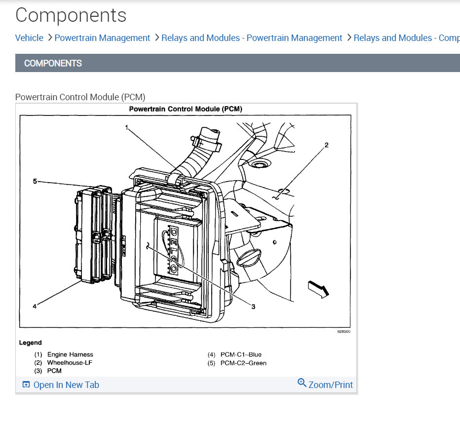

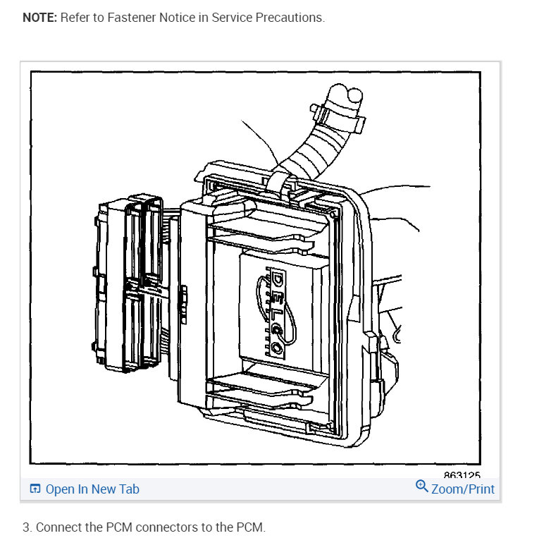

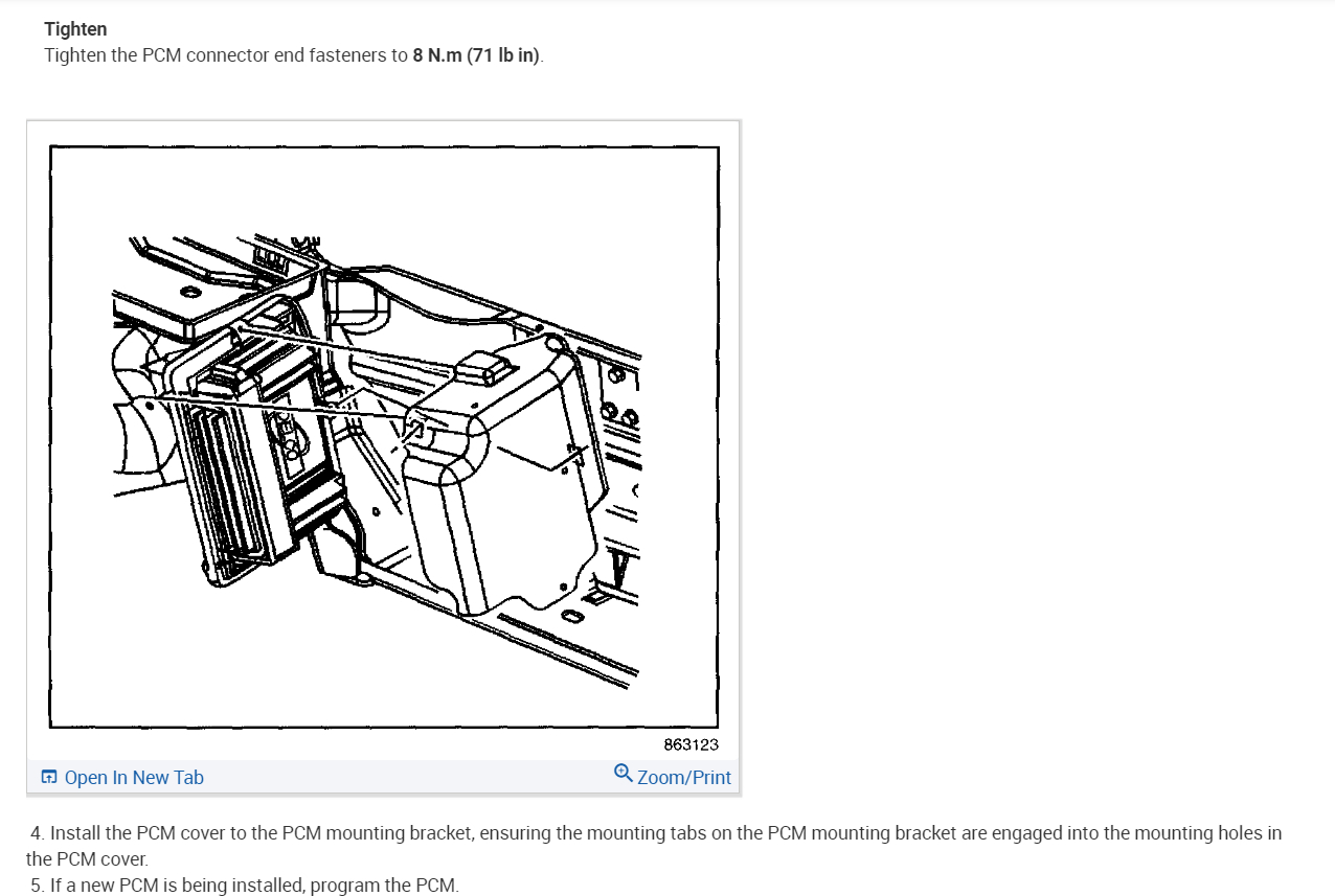

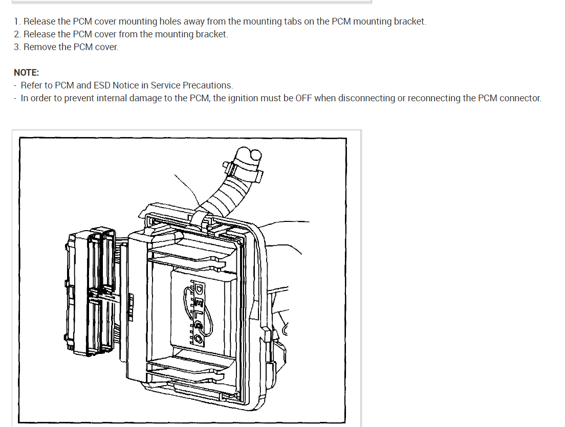

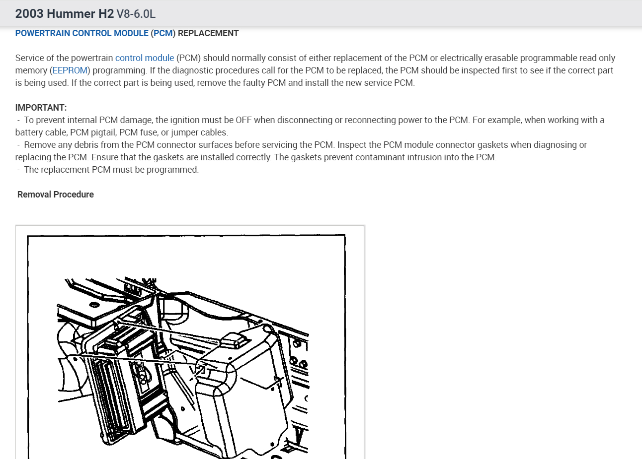

Has the shop or you run the codes? You could have a PCM going bad due to the injectors, if there are no codes, I would try swapping out the PCM which you can get a preprogrammed unit by searching Google or Ebay. Here is the location so you can do the job.
This guide can help you get the codes:

I assume the shop checked all fuses, correct? If not check these as well, also do you know if the shop did a CAN scan? You can get a CAN scanner (Controller Area Network) from Amazon.
