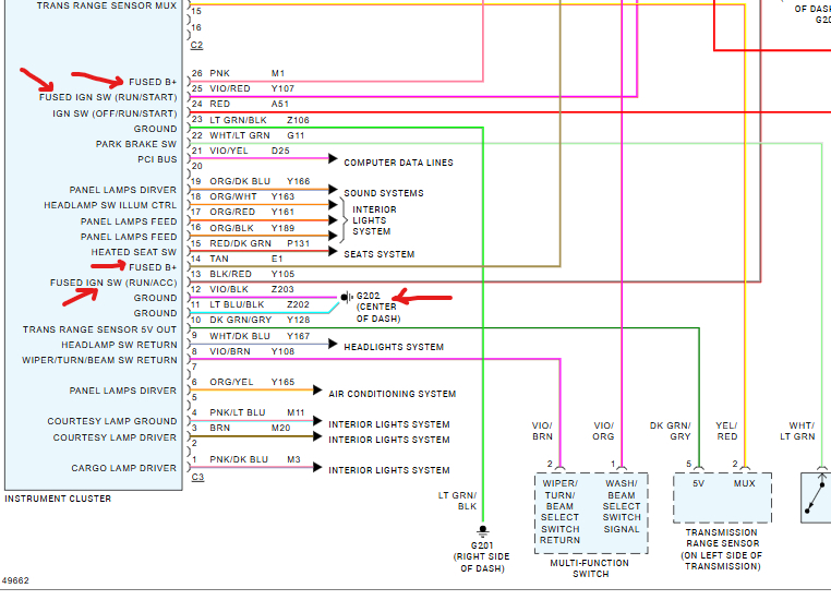

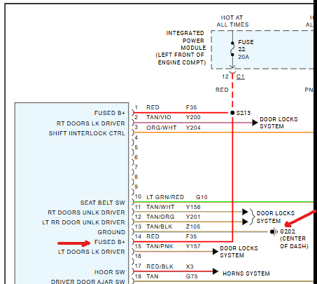

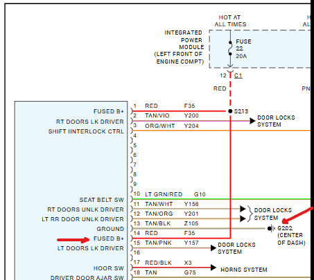

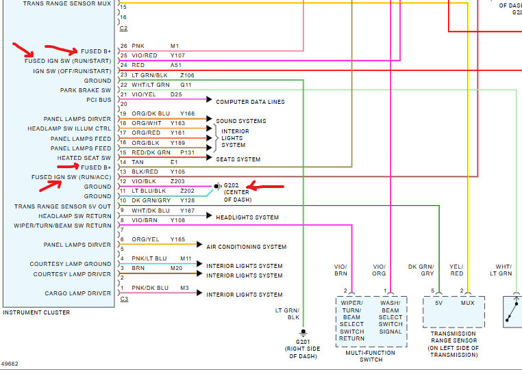

Okay, lets check the power and grounds for the cluster. Here is a guide to help and the wiring daigrams that show which wires are power and which ones are ground.
Do your testing with the cluster disconnected and the ignition switch on. Check out the images (below). Let us know how it goes
Oct 16, 2025 at 2:29 AM

Cluster wires all have power where they are supposed to
Oct 18, 2025 at 2:10 AM
