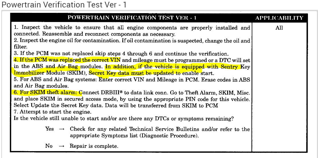

Began as intermittent problem would shut off randomly but start back up after setting. Scan tool will not communicate. I verified powers and grounds at the PCM (Pins C1 2, 22 and 31, 32) and load tested the circuits. I verified that there is a 5V reference. I tried unplugging all the sensors on the 5V reference circuit and cycling the key with no change. A new PCM was ordered and still no change.

When you replaced the PCM, did you load the VIN? Was the PIN code entered for this vehicle?
Take a look at the pic below and let me know if this was done.
See pic below.

It was ordered from a place that preprograms them. I found the problem I believe. I installed the old computer that I had sent off for repair (that was a nightmare in itself) got it back with a large hole cut in the back with no real tests done to it. Anyway, I thought it might be a program issue. With the old one plugged in I heard all the relays click finally but it quickly went back to no bus. I pushed on the computer chip that was exposed by the hole cut in it and heard the relays click again. Got it to start and when I tapped on the chip again it died. Installed the new one again and pressed in the area that that chip would be, and it made the relays click. I put a small c clamp on it and tightened it until I heard the relays activate and it will start and run. Removed c clamp and it does. Going to contact the place I got the new PCM from and go from there.
