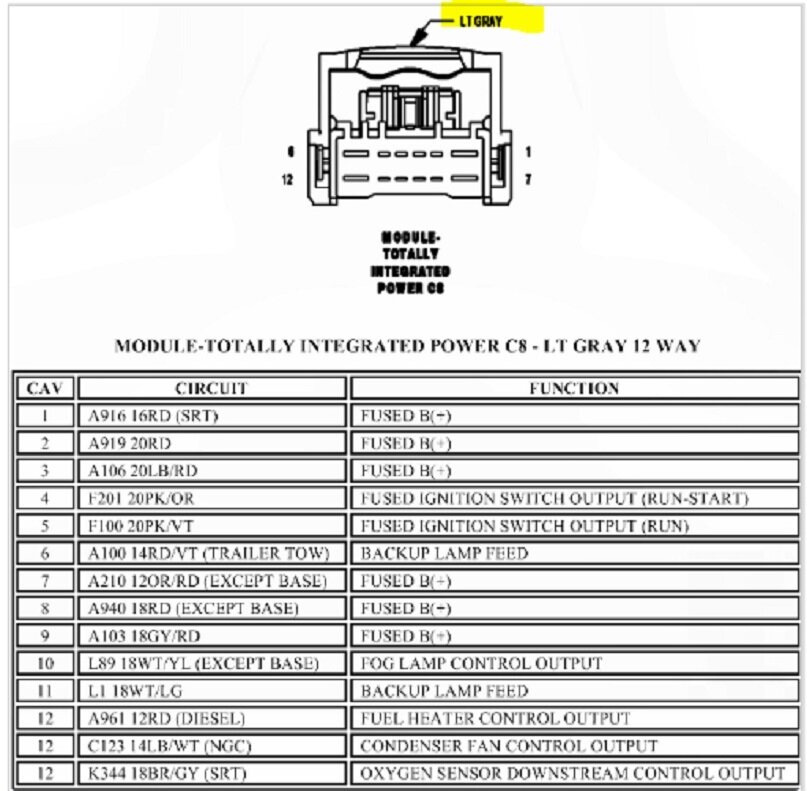

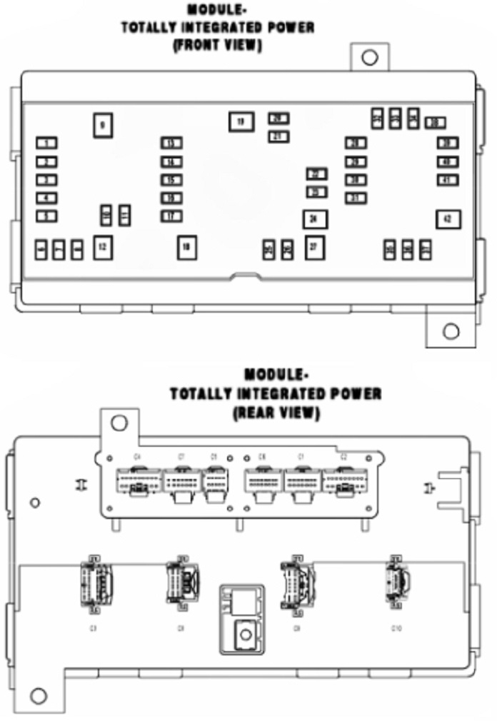

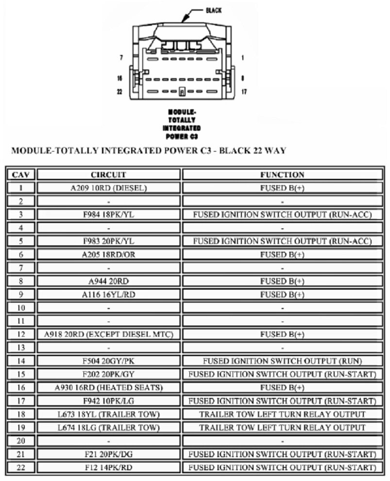

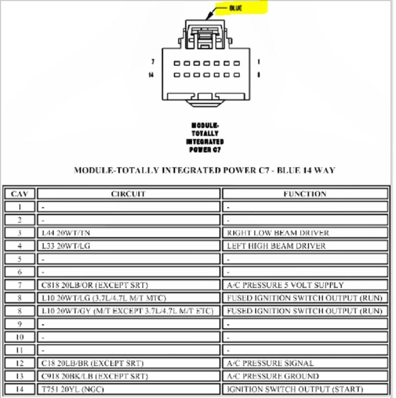

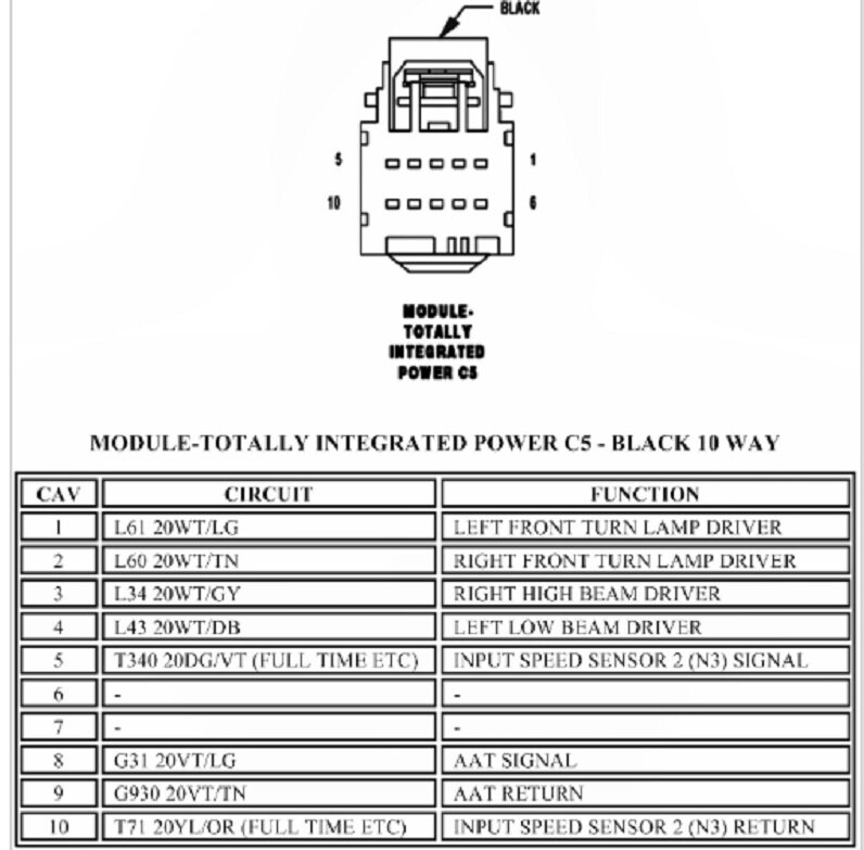

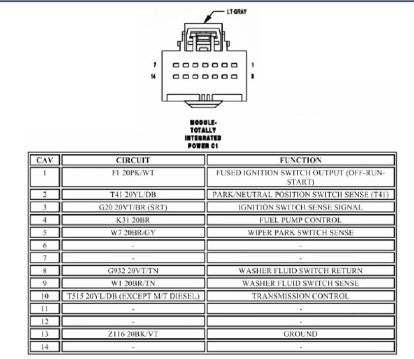

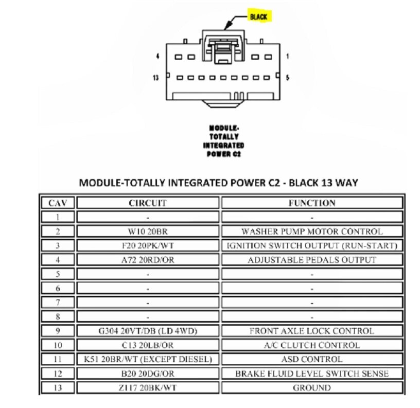

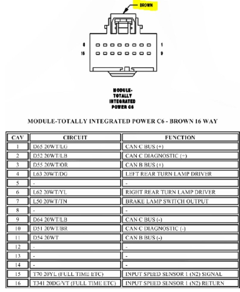

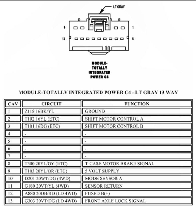

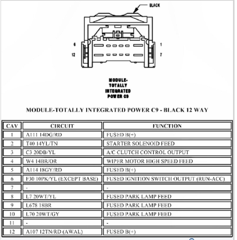

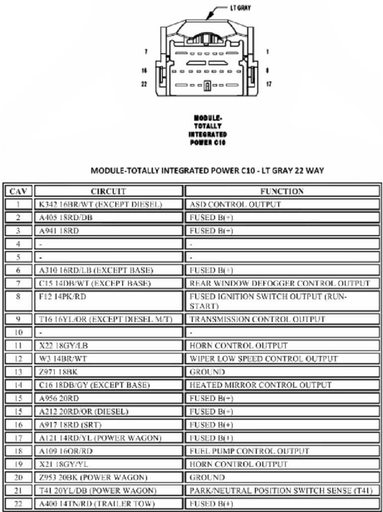

Can you help me? i need TIPM pinout for the truck listed above 2500 4x4 diesel 5.9.
Feb 10, 2025 at 3:56 AM
CARADIODOC
  • 34,415 POSTS
Here they are. If they're hard to read, try to copy and paste them into a typing program such as MS Word where they can be expanded. The original drawings are very blurry, especially the last one showing the connector locations. My best recommendation is to go by the size and pin count for each plug, and their colors, to be sure you're looking at the right one.
