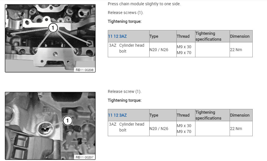

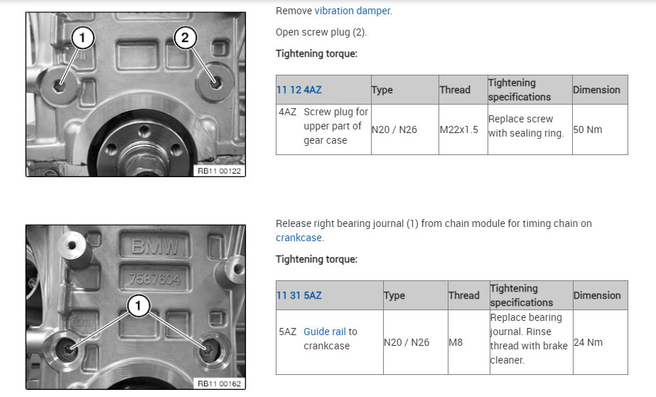

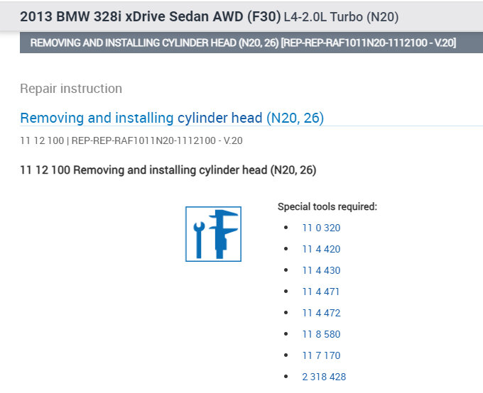

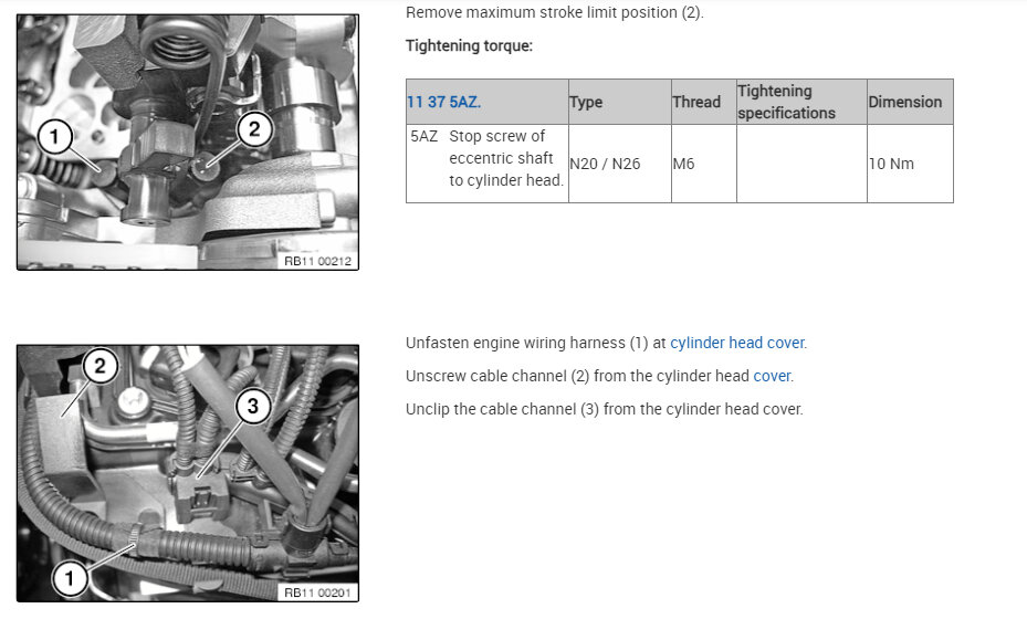

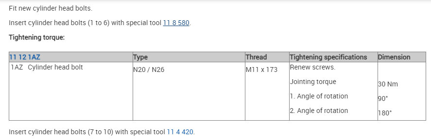

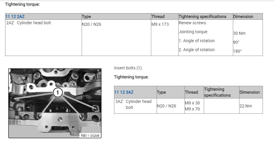

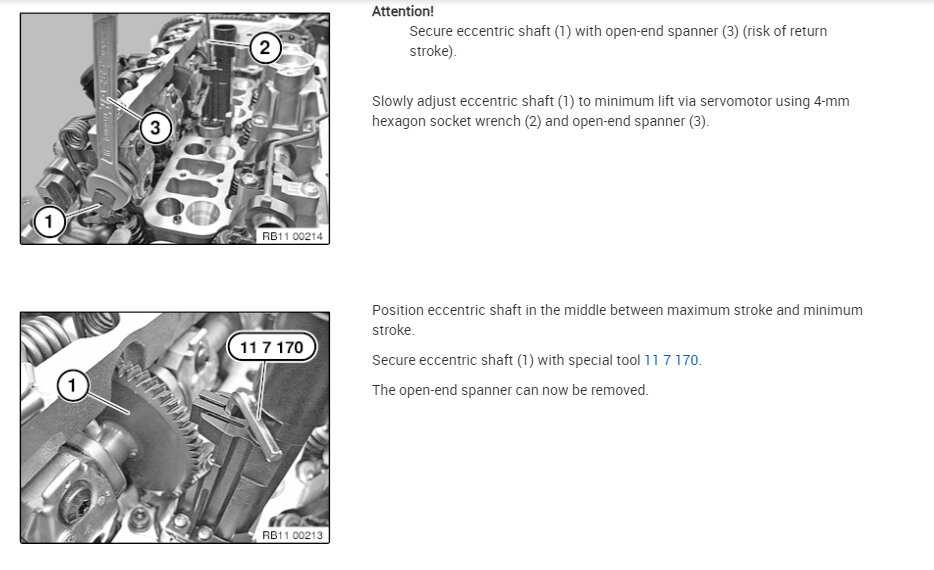

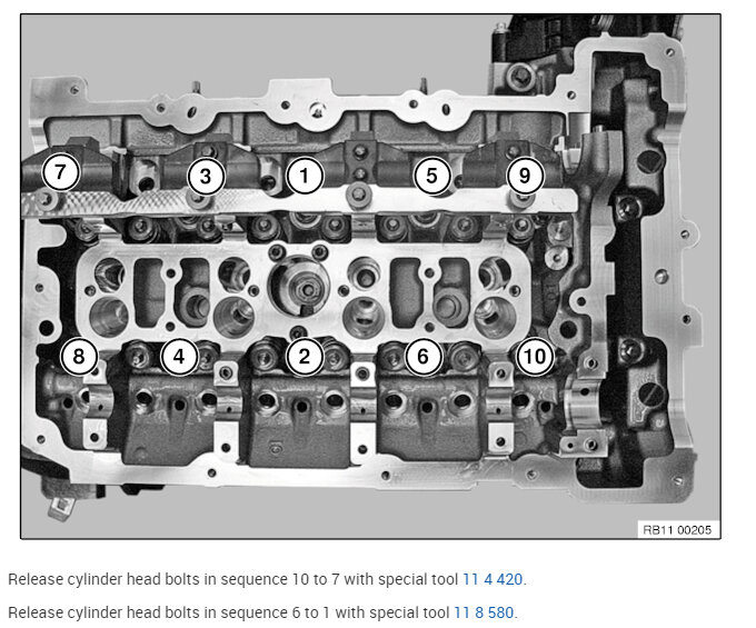

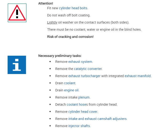

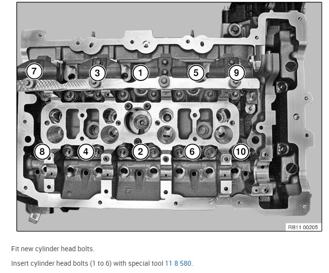

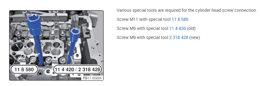

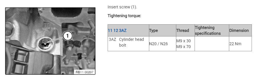

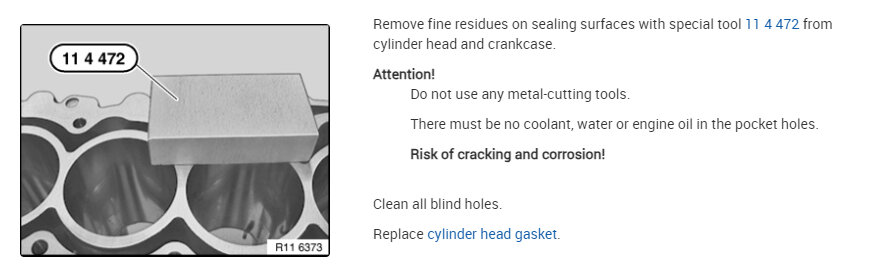

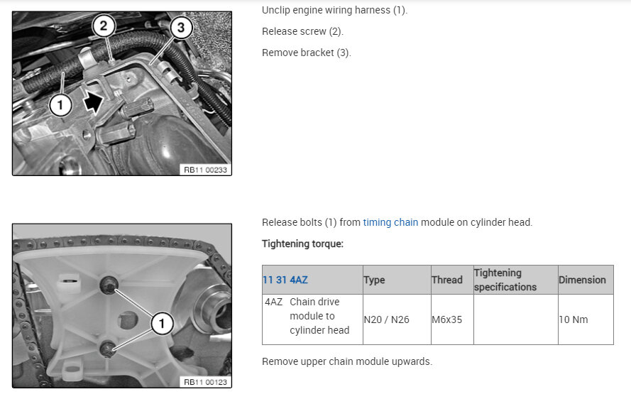

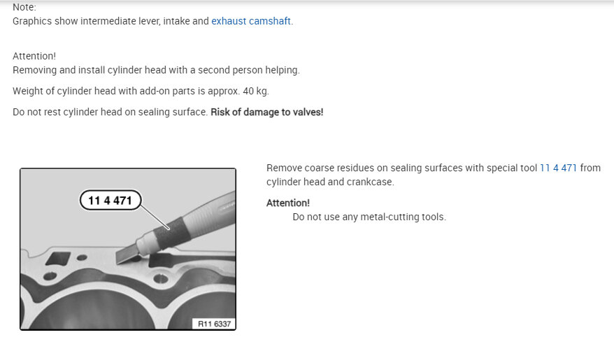

Also, I don't know if you need them, but I attached the directions for the removal and installation of the cylinder head. These are just for the head. If you need anything other, let me know.

That isn't good news. There is a good chance internal damage was done to the cylinder head, pistons, or valves.
Now that you know the timing chain failed, we need to remove the cylinder head to check for damage.
Do you need anything as far as the timing chain/tensioner replacement? If you do, let me know.
