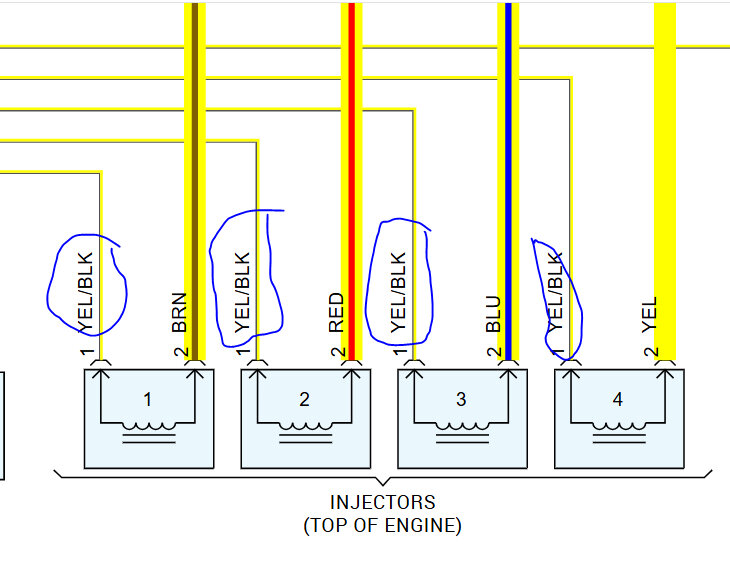

I've changed the battery, alternator, put a new radiator, new Serpentine belt, there no codes no check engine light, all fuses and relays are good, fuel pump is good have fuel going to injectors, and even with jumper cables car barely turns over to crank, about every third or fourth revolution it wants to try and crank but never does. I do not know what else to do.
P.S. spark plugs and coil packs are good and getting fire.

Is it possible for you to record it cranking and upload it for us to hear? Also, has the starter motor been checked to make sure it isn't failing?
If you have fuel and an ignition spark, the engine should run. However, things can prevent it from starting, such as low or excessive fuel pressure, low engine compression, a plugged exhaust system, and ignition/engine timing.
On the other hand, if it sounds sluggish when cranking, that leads me to believe it has something to do with the starter circuit.
If you remove a spark plug, are they wet? If not, try starting fluid to see if it makes a difference. We may have an injector issue, and fuel isn't entering the combustion chamber.
Do me a favor. Each fuel injector will have two wires. One of them at each injector is yellow with a black tracer. That is the power supply. With the key in the run position, confirm they are getting power. The other wire at each is a different color. The PCM provides a ground path via that wire to complete the circuit. If you do have power, confirm there is a signal ground while cranking.
I attached a schematic of the injectors below as a reference. I circled the power supply wires to each.
Let me know what you find. Also, if you could upload a video of it cranking for us to hear, it may be helpful. You could have a timing issue.
Let us know.

It has a cracked engine block, they drove it for about 30 minutes without any coolant in it no compression at all, starter was changed also forgot to mention.

Way more than that, I have a shop i mechanic out of, changed the battery, alternator, starter, belt, radiator, flush and fill with the coolant, changed oil, tested all fuses, relays and cleaned ground wires, diagnostic scan tool showed no codes and all live data readings were good...but finally after 5 or 10 trys cranking it you could see the oil on the dipstick changing to a more milky look and the radiator was shooting coolant with puffs of gas that smelled like smoke outta the radiator fill neck, bad head gasket I'm hoping or worse hope not...

I've got it out, yes I usually leave it in also it's just a pain to get it out which the head looks good, the timing chain cover and the timing chain guide closest to the front of the car were broke and sheared the bearings on the crank, so got to pull motor anyway, that's what I told the customer at the beginning...
