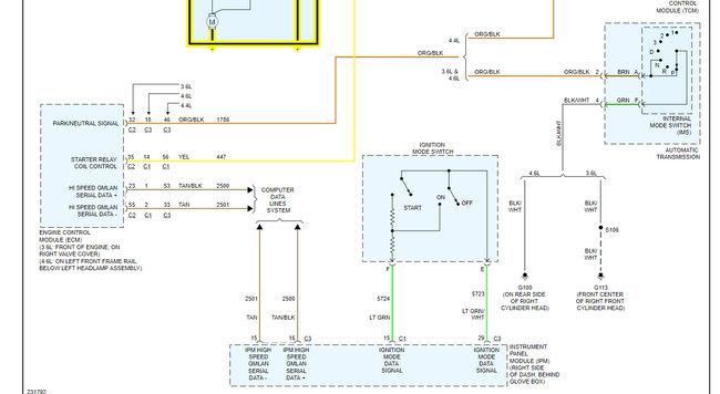

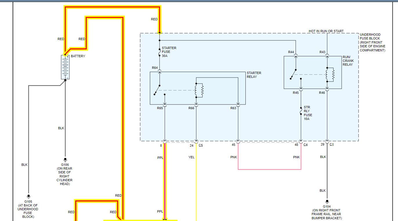

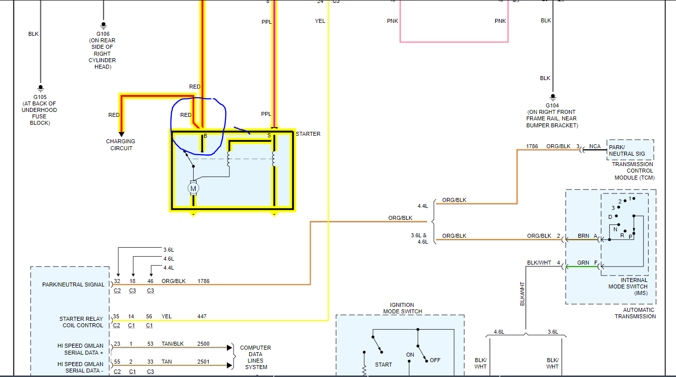

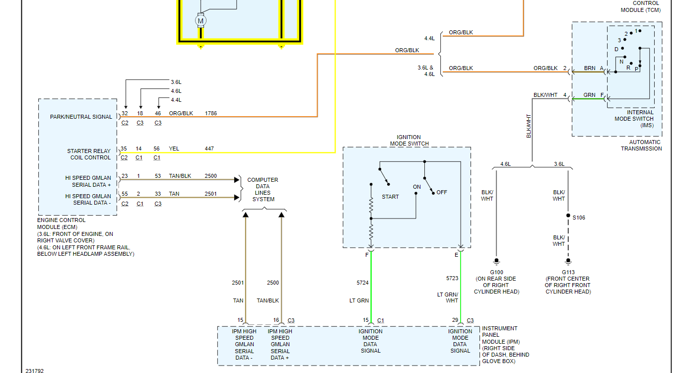

I attached a wiring diagram of the starting system as well. Check for battery voltage at the starter solenoid large terminal where the positive battery cable attaches.

Yes, thank you very much for the advice really. I have replaced the head gasket or in this case I think it's considered valve gasket. If not mistaken. I will also check for voltage here in the. Next hour or so. Will the engine crank with a bad starter solenoid?
Apr 22, 2021 at 3:34 AM
No, it will not.
