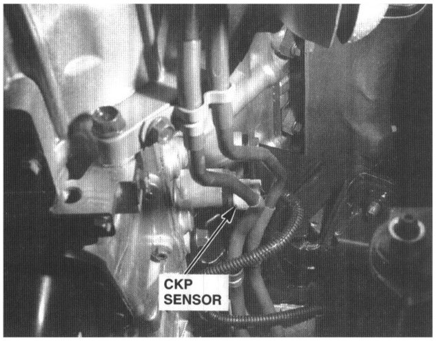

Truck just shut off while driving. Replaced fuel pump because it was not working. Still cranks, but no start. And I now have a reduced power light when I try and crank it. Checked and I have good fuel flow to engine and I also have spark. It has a 3.2l v6 engine.

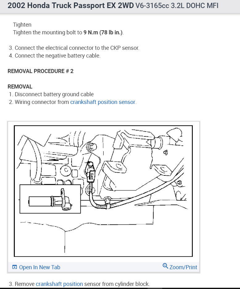

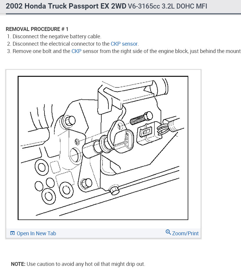

Hi Kerisa my name is Alex and I will be helping you today. This sounds like it might be your crankshaft position sensor giving you problems. Here are a couple of instructional videos that will probably help. Let me know if you have any other questions or concerns, and we will go from there.

Here is the location of the crankshaft sensor to help you replace it. but lets run the codes is see what comes up. Here is a guide with diagrams below:
