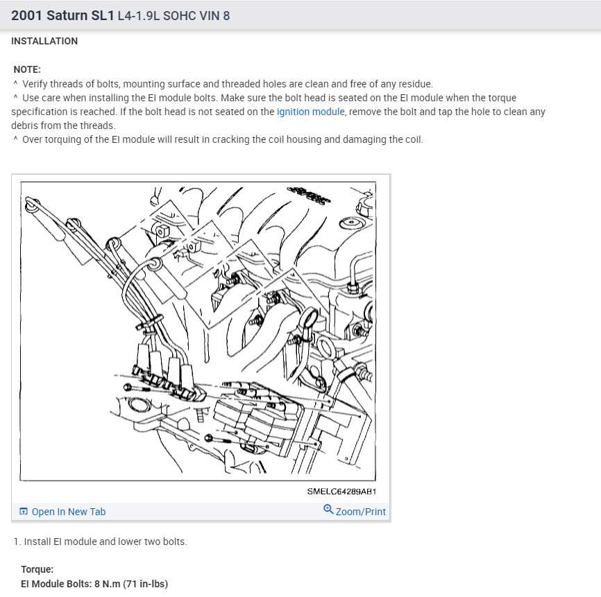

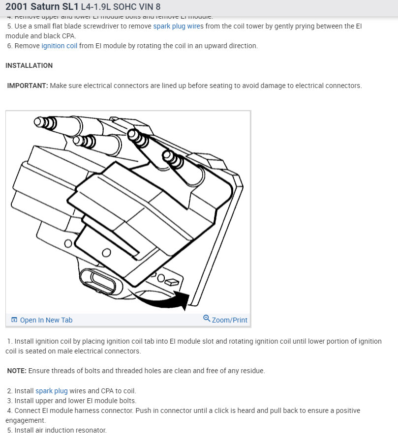

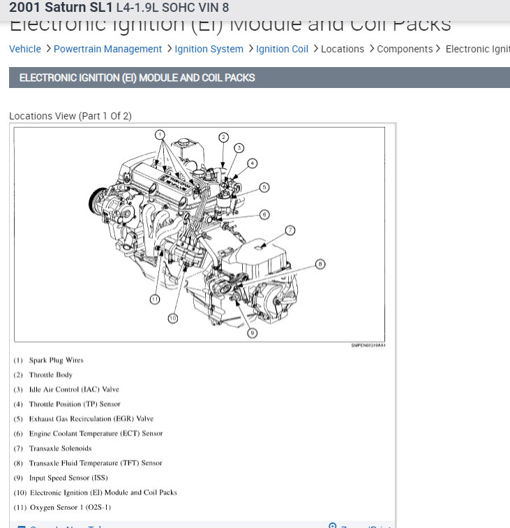

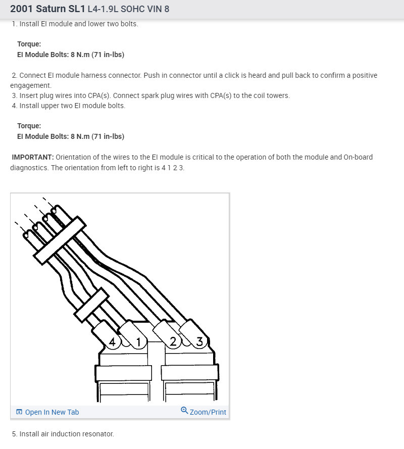

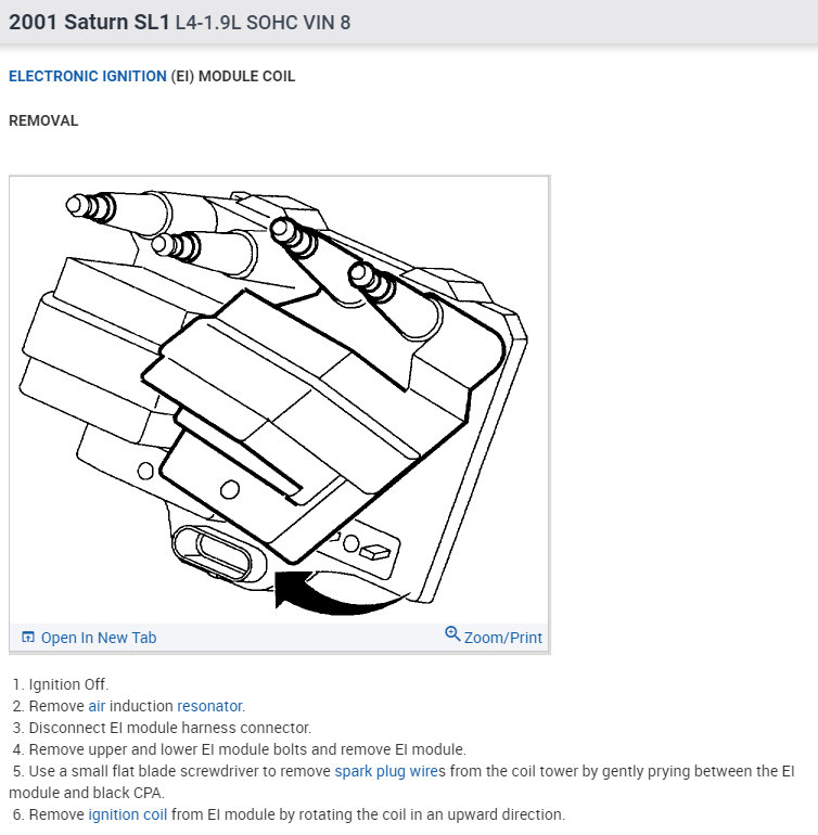

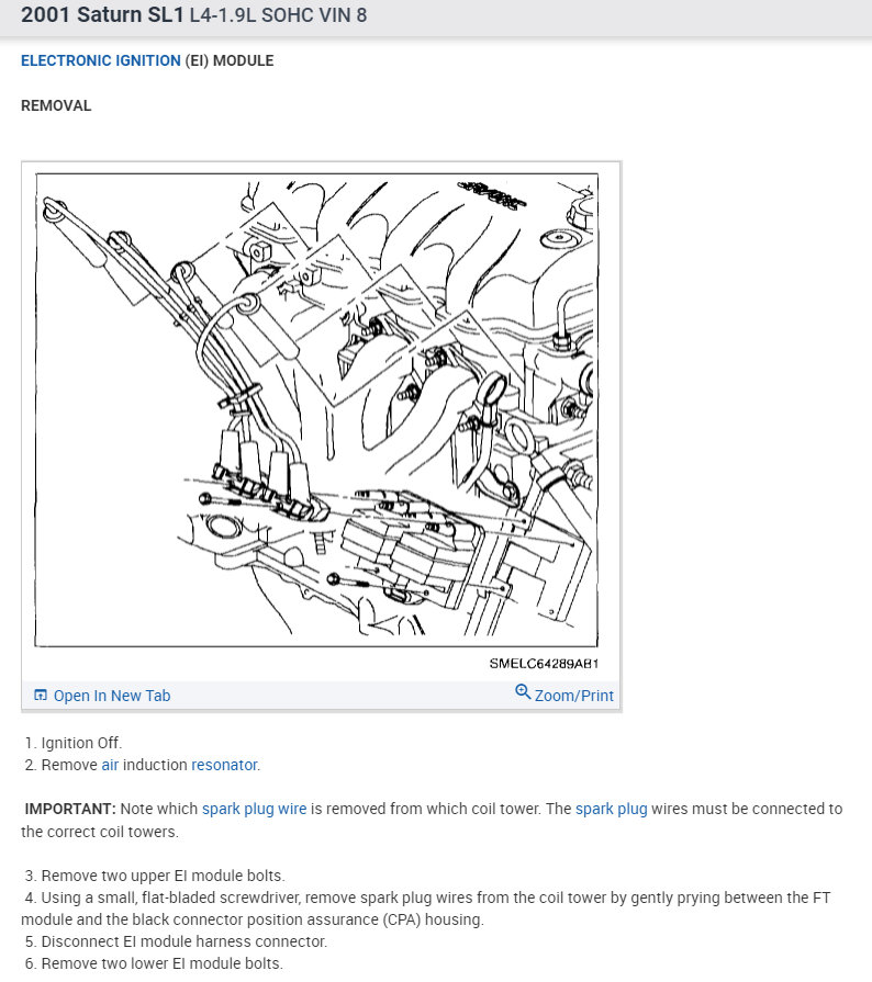

No spark can be due to a bad coil pack or a faulty control module.
You want to check and see if there is power to the coil.
Take a look at this guide. It covers what to look for when checking for spark.
Go through this and report back to your finding.

Running rich should not keep it from starting. It might run rough if it is too rich.
If you are getting fuel but not spark, then that will be the first item you will have to check off.
Let me know if you are able to figure out the spark issue from the guide.
