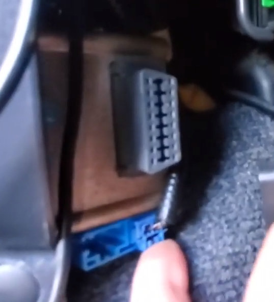

I would suggest conducting a diagnostic scan first to see what codes come up.
How to conduct a diagnostic scan:
You can also read fault codes by bridging out the blue, 2 pin, connector.
See location on picture at the bottom, at passenger side near center console.
How to:
https://youtu.be/8M5BaAa6tCM
It is possible that any codes retrieved could point towards the non-start issue.

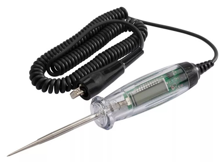

This can be done by using a dedicated spark tester, a long screwdriver or a test light
How to use a spark tester:
https://youtu.be/IcEsmK_V01I
How to use a long screwdriver and test light:
https://youtu.be/9K78XIhhjAQ
How to use a test light:
See image below for test light sample, these can be purchased online or automotive shops.
