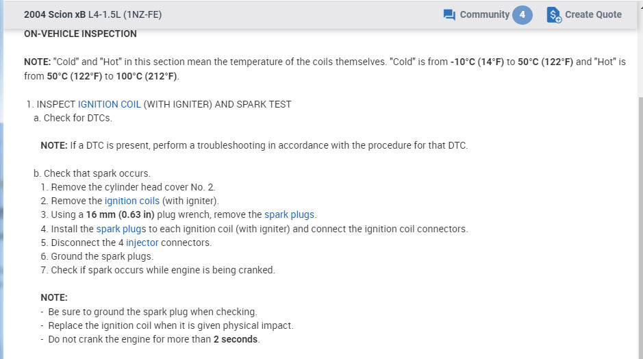

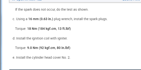

My car cranks fine but won't start in the morning and has no spark, but later in the afternoon it has spark and runs fine. The error code p0340 is flagged but no engine lights on dashboard.
Jun 28, 2020 at 9:47 AM

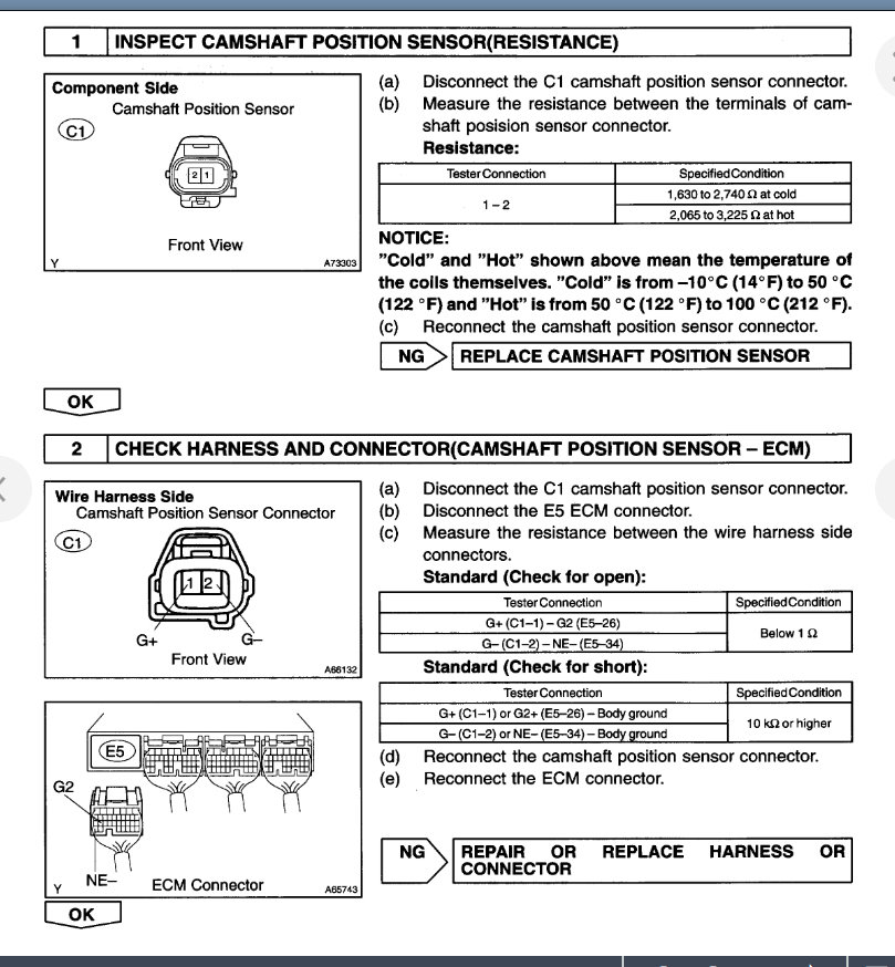

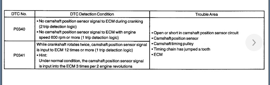

This code is for a cam sensor circuit performance Bank 1. That is unlikely to cause a no start if the check engine light is no actively on.
However, it could go stored once you cycle the key so we need to run through the testing to find out what is causing the code and then see if the no start is cured as well.
Let me know if you have questions. I attached the test for your review. Thanks

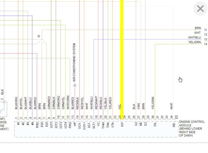

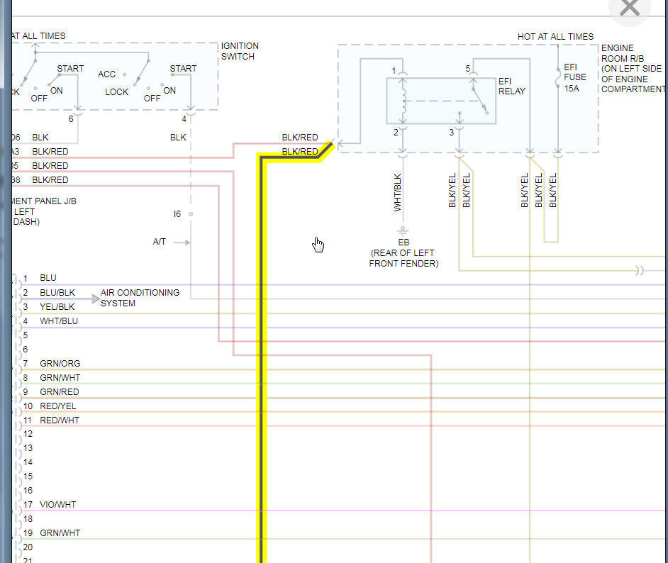

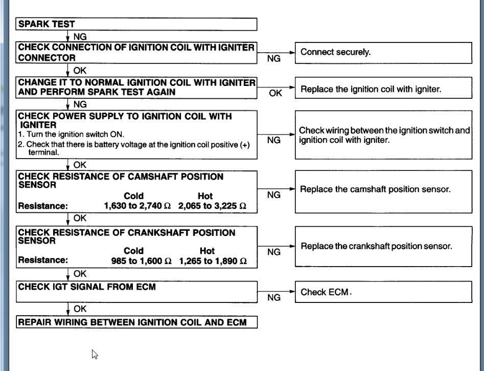

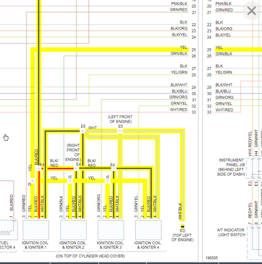

My car cranks but won't start in the morning. I checked for spark and no spark. I checked for ground and e everything tested good. Retested for spark in the afternoon and I have spark and car runs like normal. Next morning same thing crank no spark and car runs in afternoon.

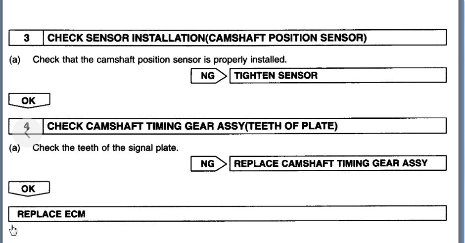

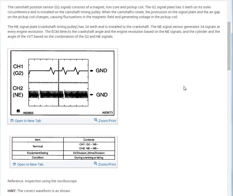

How did you make out with the camshaft code diagnosis? Do you still have the P0340 code? If so, we need to chase that down. I attached a spark test for your review and as you will see it is having you test the cam sensor for on open or resistance. So the fact that you have a cam code, is most likely the issue.
Run through this information and let me know what you find. Thanks

Found the problem finally; had time to investigate crankshaft position sensor and I have a power steering leak and has been accumulating on the senor pigtail. I disconnected the pigtail and oil was dripping out of the port on the sensor, removed the sensor tested it after cleaning the oil out of port, it is read the correct ohms. finished cleaning and drying out connector and success engine fired up. Now I have to tackle the leaking power steering pump.
