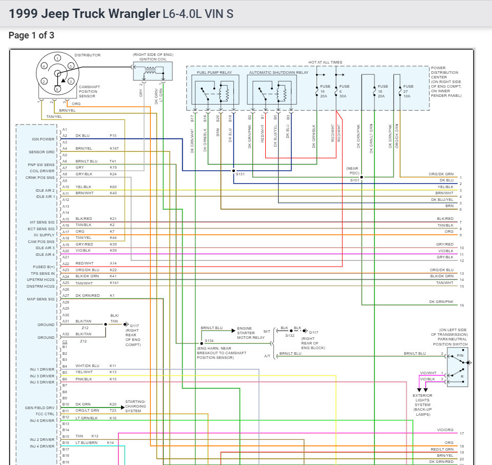

Replace crankshaft sensor. It started idle rough. I started checking connections unplugged connections on ECM and cleaned but not seeing that I bent one of the pins and plugged it back in trued starting it wouldn’t start shut down relay was buzzing.
I unplugged the black plug from ECM and found broken pin was shorting across other pins. I got a replacement ECM now it will not start; it cranks over just fine also replaced camshaft sensor. Still no start.
Checked for power to ECM that’s okay checked grounds at ECM ok check for the 5 bolts from ECM it’s okay. Something I should have said at first was when it first stopped there were some codes about a bad fuse but couldn’t find any blow ones. Checking other things unhooked battery when I hooked it back up there are no codes showing even after cranking engine a whole lot and there is no RPM showing when cranking the check engine light will come on after cranking engine for a few seconds.
This vehicle in in great shape all the wiring is good only thing this vehicle set in a damp basement for a few years, and I had trouble with the turn signal took the turn signal switch apart and it was all corroded I cleaned It up put it back together and it has worked find. Also, there is no spark there is fuel.

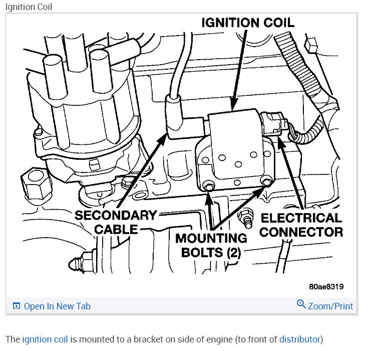

When you checked for spark did you remove the coil wire to check, or the spark plug wire? I have seen the ignition rotor short out and not allow the spark to be generated from the ignition distributor. I would check for power on the positive side of the coil (key on) as well.

Sorry for the long wait but life happens. And thanks for the advice. Okay, checked for spark from coil. no spark to plug or to rotor cap.

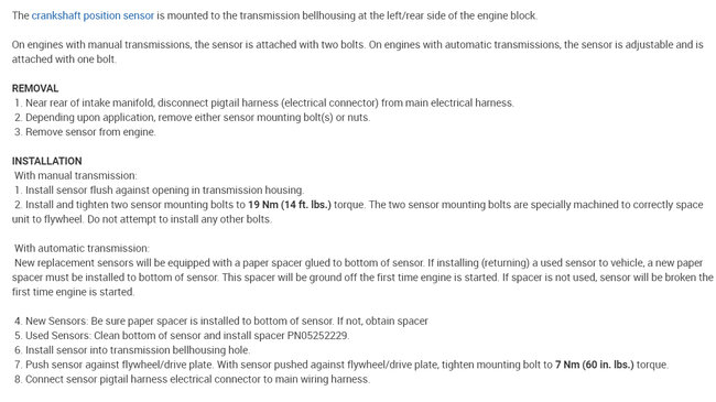

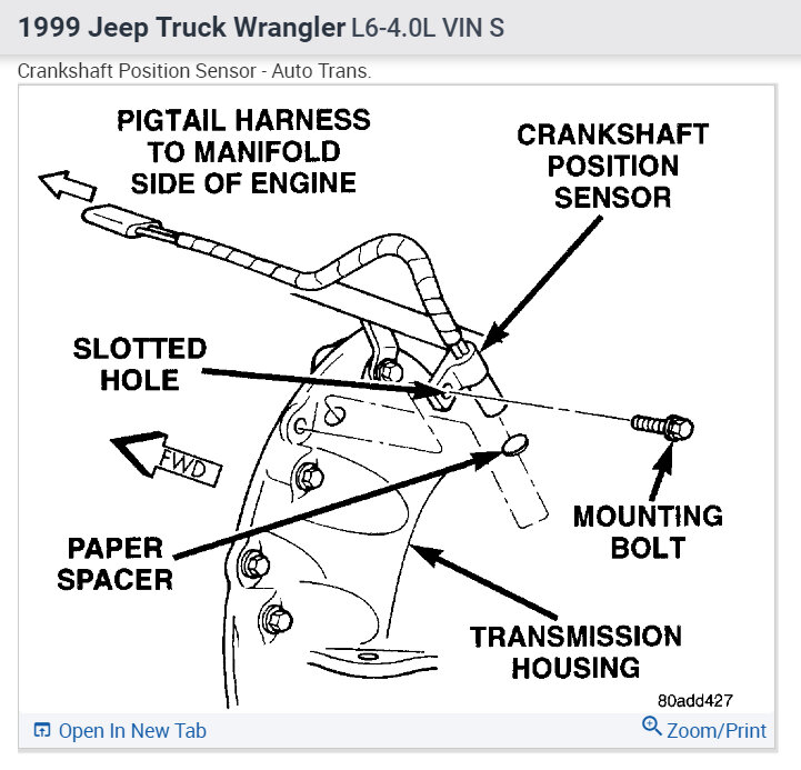

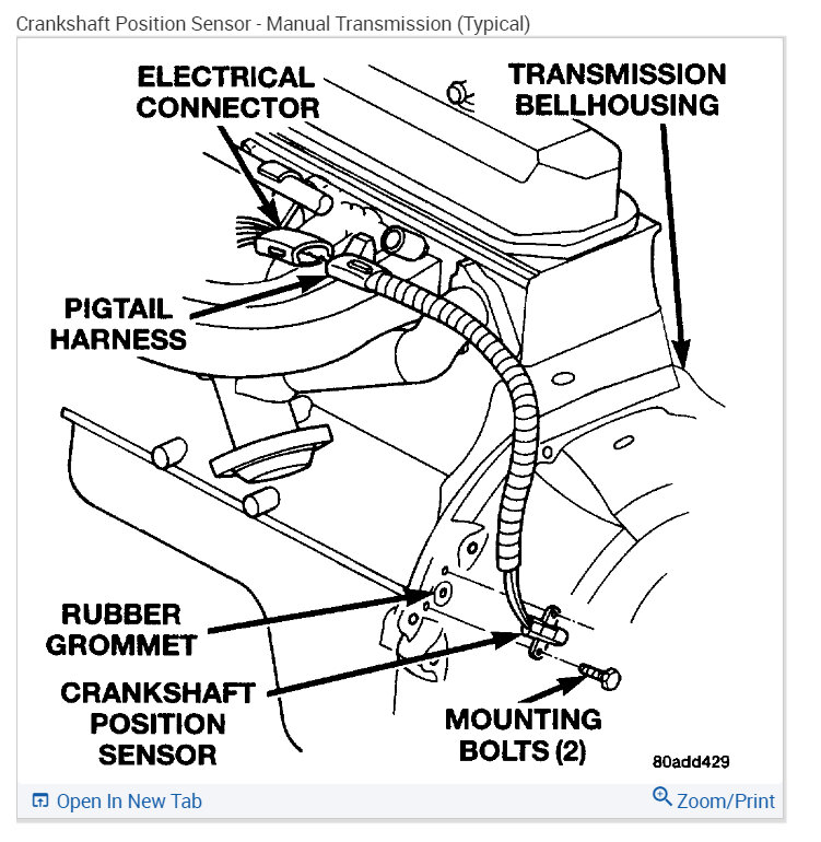

Good job, most of the time what happens is the crankshaft angle sensor goes out, here is the location so you can check it out. Also, please check all fuses with the system on, this guide can help:

I replaced the crankshaft sensor, and it will still not start. Thought that maybe the new one was bad so I replaced it and still will not start.
Also replaced camshaft sensor still not start but still cranks fine. Checked fuses didn’t find any bad ones.

Check for spark. There aren’t any. Check coil there were some cracks in housing, so I replaced the coil and still no spark.

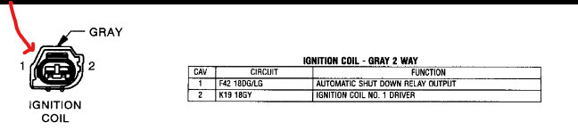

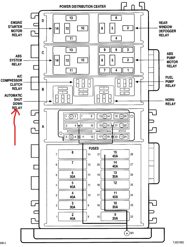

Okay, can you turn the key on and while using a test light check the positive side of the coil for power?
Here is a guide to help:
Remove the connector and test terminal #1, if no power is present swap out the auto shutdown relay.
Check out the images (below). Please let us know how it goes.
Oct 30, 2023 at 2:16 AM
WILLE16
  • 13 POSTS
No power.

Okay, let's check for power at the fuse #18 in the under hood fuse panel, this guide will help, key on.

Okay, since you don't have power at #18 I would change out the auto shutdown relay. Which I mentioned above.

Try that by switching it with other relays, still the same no power.

When you turn the key on can you feel the ASD relay click? You may need a helper with this test.

No there is no click.

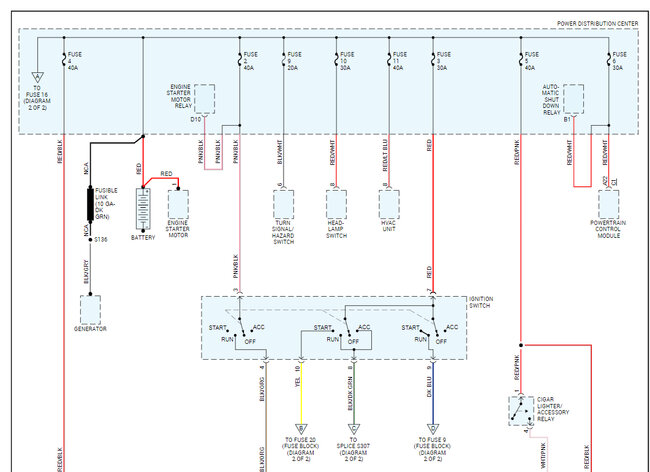

Please recheck fuse #19 and fuse #6 in the fuse panel under the hood. If the fuse is okay sway out the ASD relay. Let me know how it goes.

Fuses are okay, swapped out relay, still the same crank no start.

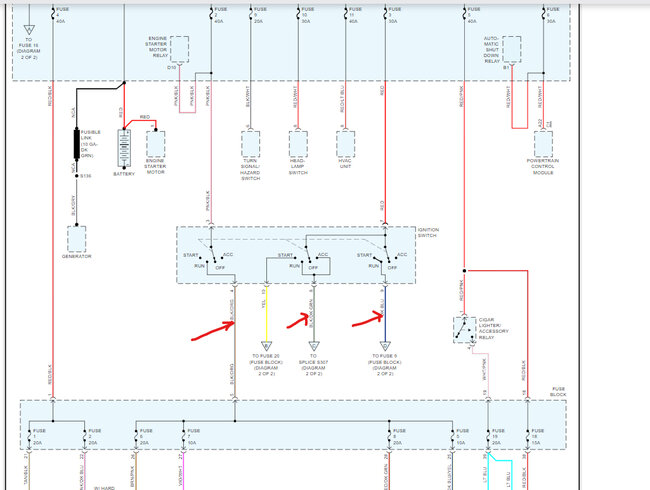

Okay, it sounds like the ignition switch is bad. here is a guide to help check for power and I have marked the wires you need to check for power when the ignition switch is in the "on" position:
Check out the images (below). Let us know how it goes.
Nov 16, 2023 at 2:06 AM
WILLE16
  • 13 POSTS
Check switch and power with switch on it's okay.

If you don't have power to fuse #6 (please double check) then the PDC had gone bad. Here is the wiring diagram to show you what powers fuse #6. You might be able to piggyback power onto the red/white wire from the PDC to fix it as well, I would use an inline fuse. Check out the images (below). Let us know what you find.
