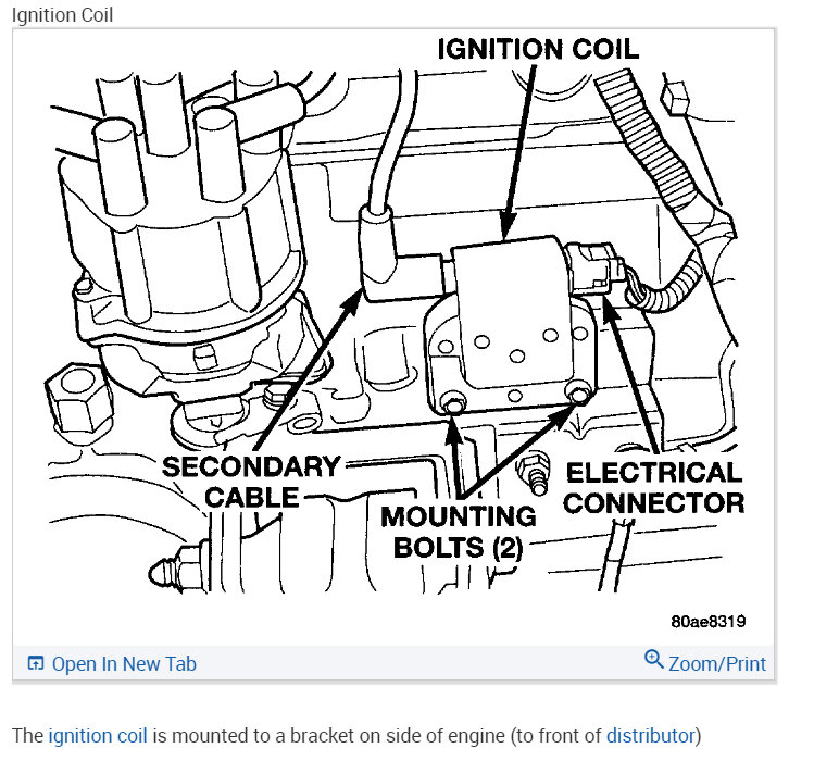

When you checked for spark did you remove the coil wire to check, or the spark plug wire? I have seen the ignition rotor short out and not allow the spark to be generated from the ignition distributor. I would check for power on the positive side of the coil (key on) as well.

Sorry for the long wait but life happens. And thanks for the advice. Okay, checked for spark from coil. no spark to plug or to rotor cap.

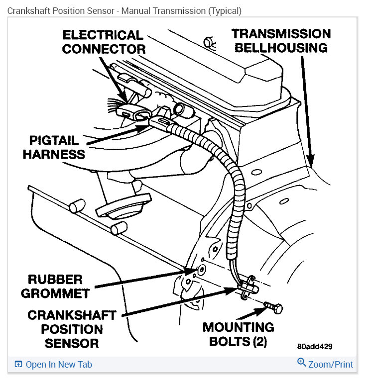

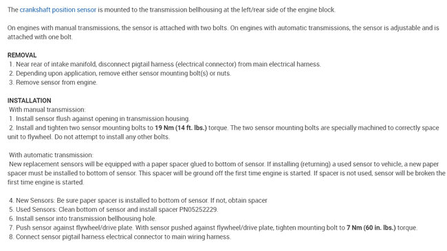

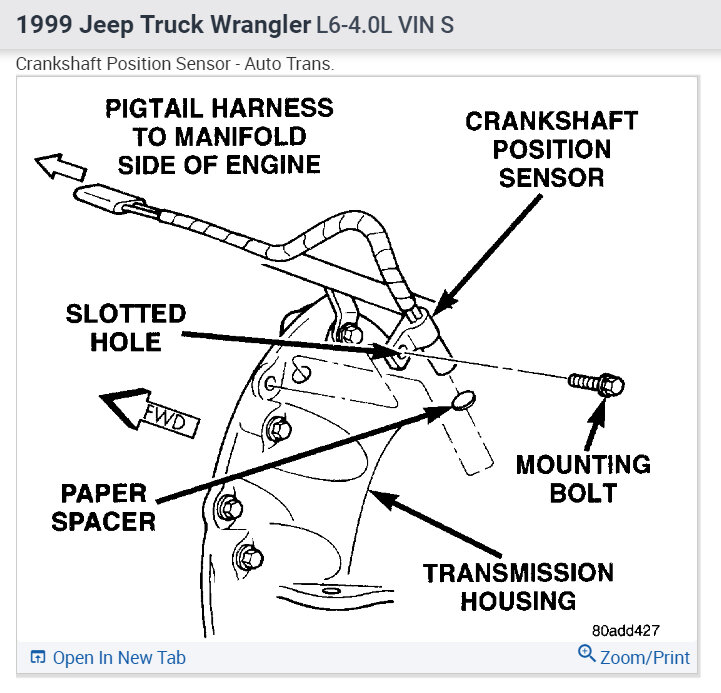

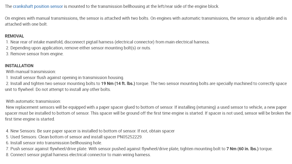

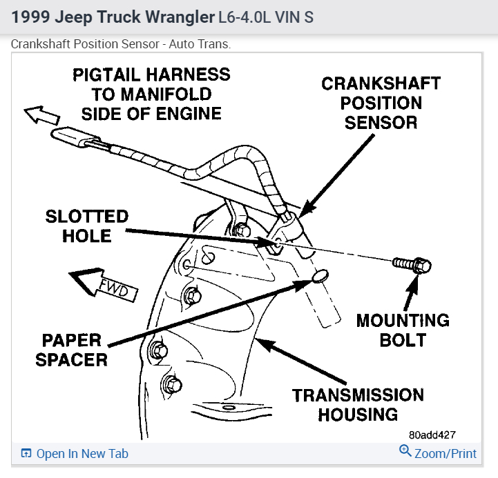

Good job, most of the time what happens is the crankshaft angle sensor goes out, here is the location so you can check it out. Also, please check all fuses with the system on, this guide can help:
Oct 17, 2023 at 2:26 AM

I replaced the crankshaft sensor, and it will still not start. Thought that maybe the new one was bad so I replaced it and still will not start.
Also replaced camshaft sensor still not start but still cranks fine. Checked fuses didn’t find any bad ones.

Check for spark. There aren’t any. Check coil there were some cracks in housing, so I replaced the coil and still no spark.

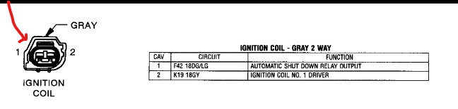

Okay, can you turn the key on and while using a test light check the positive side of the coil for power?
Here is a guide to help:

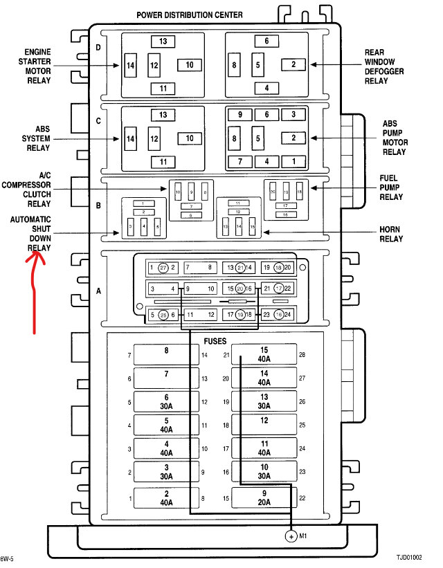

Remove the connector and test terminal #1, if no power is present swap out the auto shutdown relay.
Check out the images (below). Please let us know how it goes.
Oct 30, 2023 at 2:16 AM
WILLE16
  • 13 POSTS
No power.

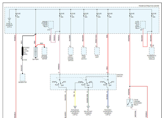

Okay, let's check for power at the fuse #18 in the under hood fuse panel, this guide will help, key on.
Nov 5, 2023 at 3:22 AM
WILLE16
  • 13 POSTS
I have checked all the fuses under the hood and behind the glove box all are good.

Okay, since you don't have power at #18 I would change out the auto shutdown relay. Which I mentioned above.

When you turn the key on can you feel the ASD relay click? You may need a helper with this test.
Nov 10, 2023 at 1:28 AM
WILLE16
  • 13 POSTS
No there is no click.
Nov 12, 2023 at 12:12 AM
  • 55,214 POSTS
Please recheck fuse #19 and fuse #6 in the fuse panel under the hood. If the fuse is okay sway out the ASD relay. Let me know how it goes.
Nov 13, 2023 at 1:13 AM
WILLE16
  • 13 POSTS
Fuses are okay, swapped out relay, still the same crank no start.

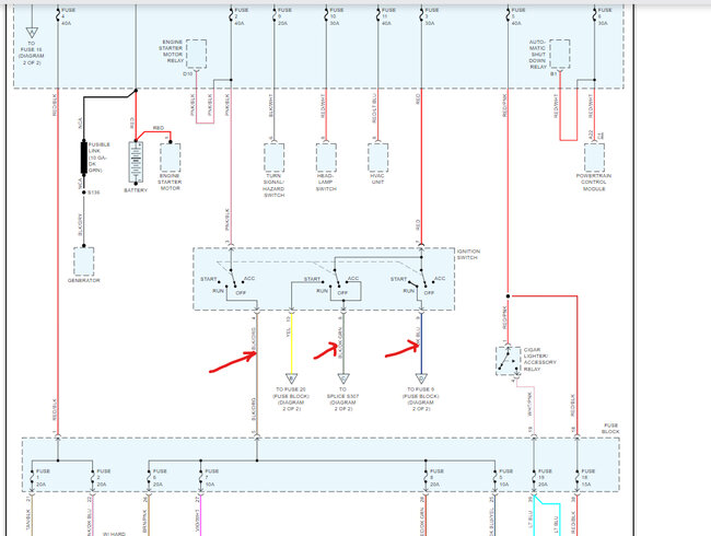

Okay, it sounds like the ignition switch is bad. here is a guide to help check for power and I have marked the wires you need to check for power when the ignition switch is in the "on" position:
Check out the images (below). Let us know how it goes.
Nov 16, 2023 at 2:06 AM
WILLE16
  • 13 POSTS
Check switch and power with switch on it's okay.

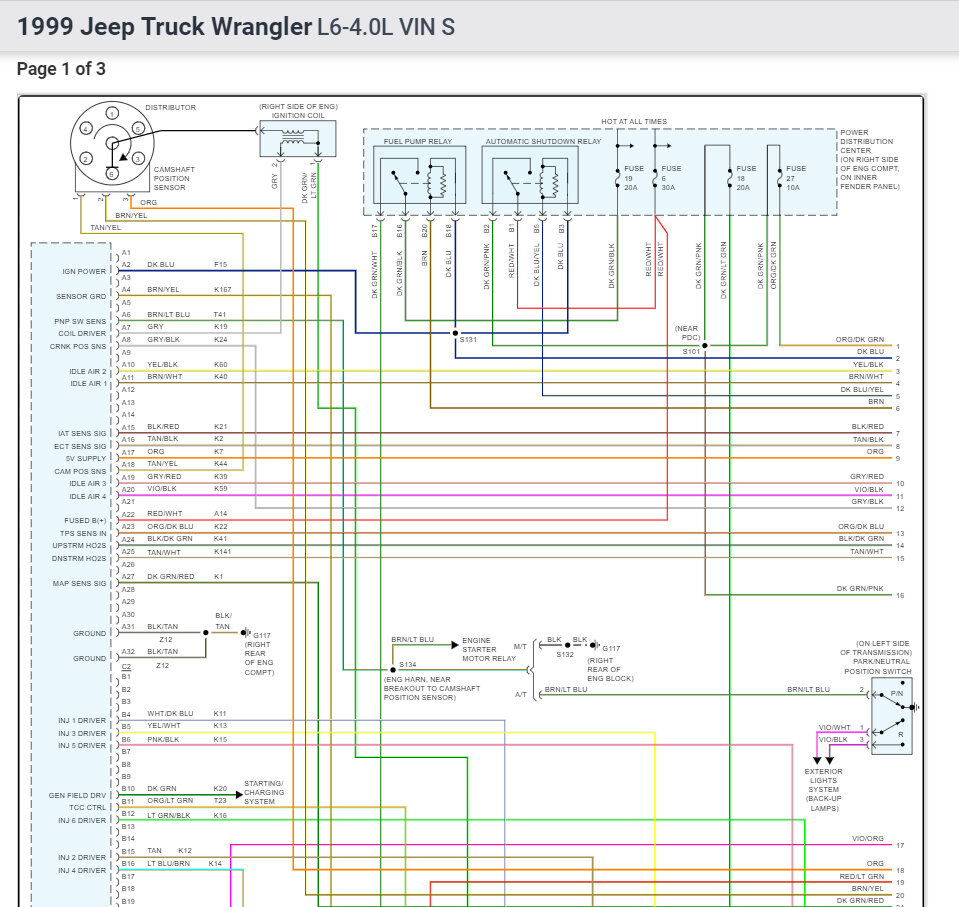

If you don't have power to fuse #6 (please double check) then the PDC had gone bad. Here is the wiring diagram to show you what powers fuse #6. You might be able to piggyback power onto the red/white wire from the PDC to fix it as well, I would use an inline fuse. Check out the images (below). Let us know what you find.
Dec 5, 2023 at 2:40 AM
