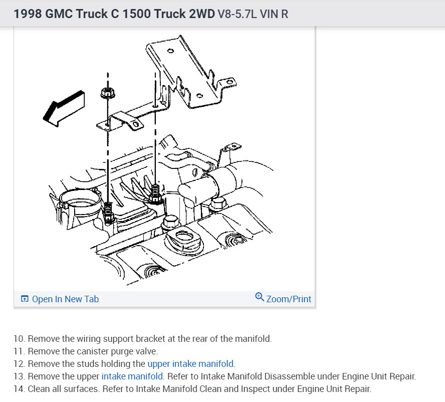

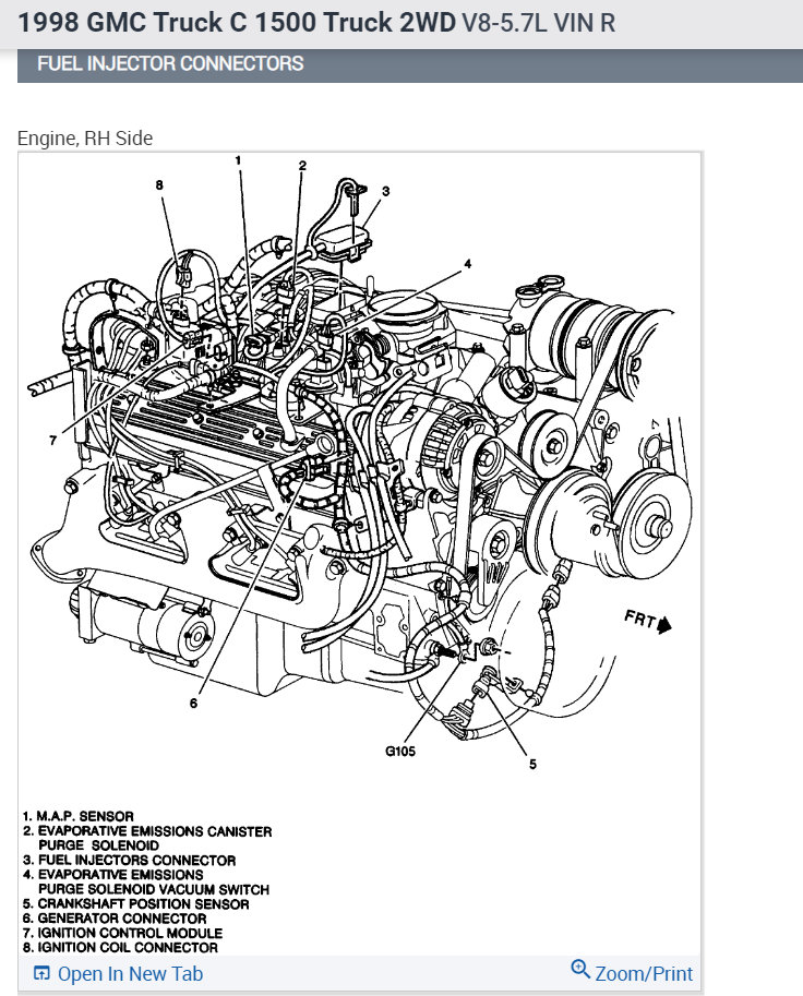

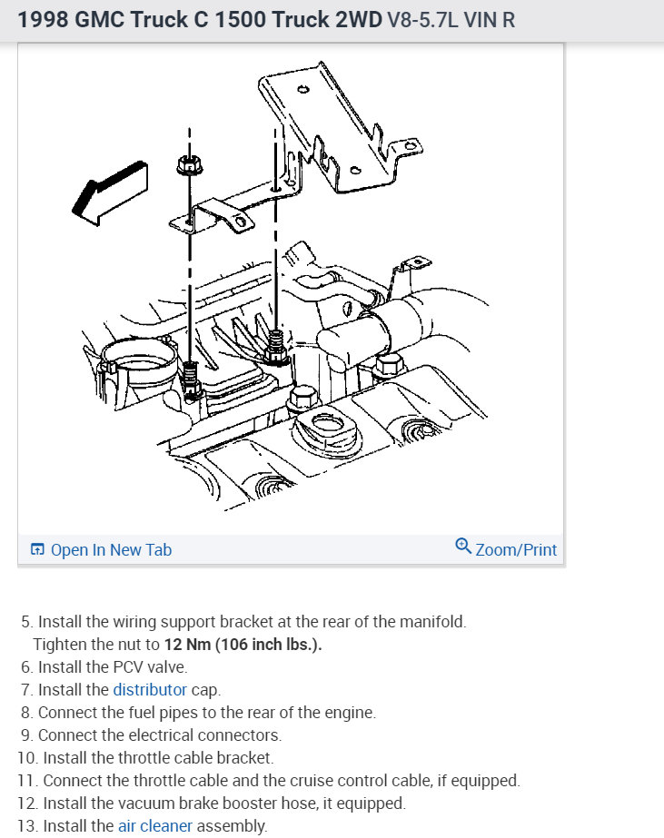

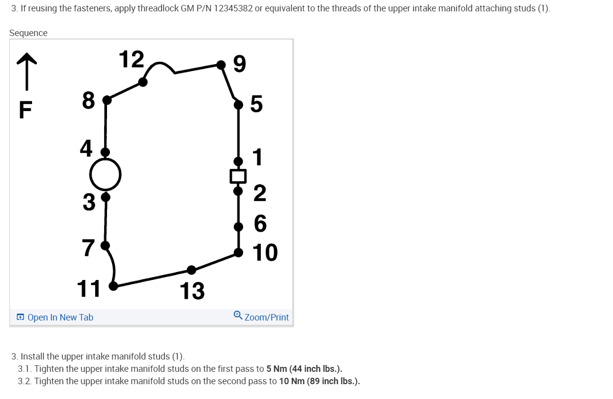

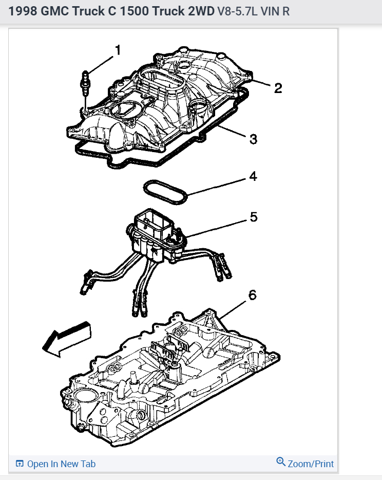

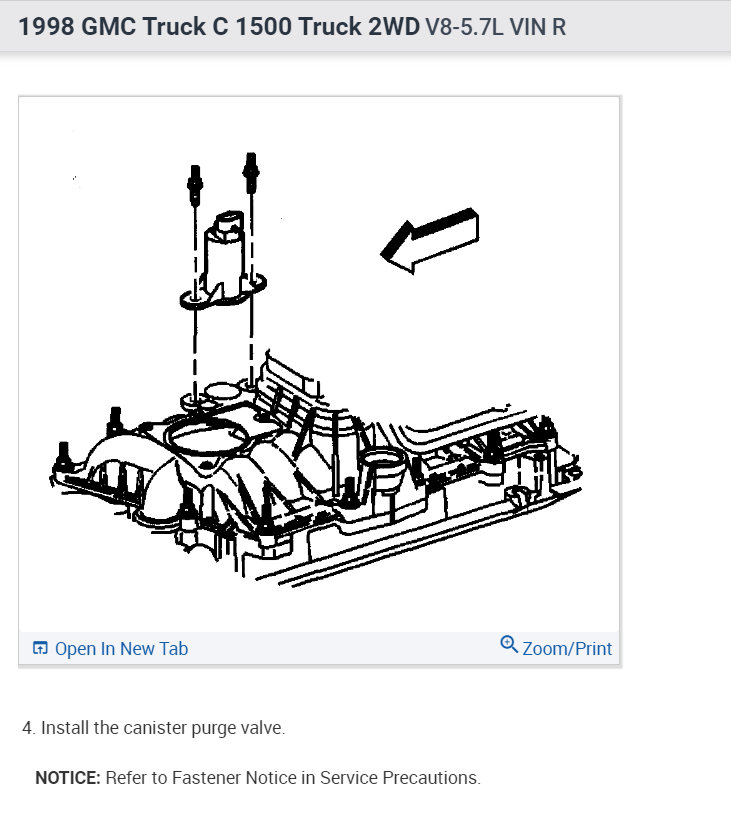

Yep, I was going to say spider injector which they had problems with, the new unit from AC Delco has been updated so they work better FYI. Here is how you can change the spider out to fix the problem, also I would install new spark plugs when you do the repair. Check out the images below to see how the repair is done.
REMOVAL PROCEDURE
CAUTION: Use care in removing the fuel injectors to prevent damage to the electrical connector terminals, the injector filter, and the fuel nozzle.
NOTE: The fuel injector is serviced as a complete assembly only.
CAUTION: Also, since the injectors are electrical components, these injectors should not be immersed in any type of liquid solvent or cleaner as damage may occur.
1. Disconnect the negative battery cable.
2. Relieve the fuel system pressure. Refer to Fuel Pressure Release Procedure.
3. Remove the Upper Manifold Assembly. Refer to Engine Mechanical.
4. Remove the Fuel Meter Body Assembly. Refer to Fuel Meter Body Assembly.
INSTALLATION PROCEDURE
1. Install the fuel meter body assembly. Refer to Fuel Meter Body Assembly.
2. Install the upper manifold assembly. Refer to Engine Mechanical.
3. Connect the negative battery cable.
Check out the images (below). Let us know what happens and please upload pictures or videos of the problem.
