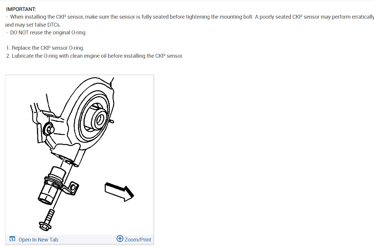

Truck diving fine. Then brought it into my garage to replace the radiator. It sat for 2 weeks. After finally replacing the radiator, I tried to start but it wouldn’t. No spark from coil. Ran a diagnostic code check and got Crankshaft position sensor. A circuit. From my code reader.
Jan 19, 2024 at 4:07 AM
  • 55,399 POSTS

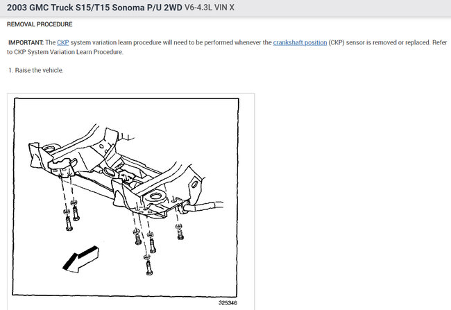

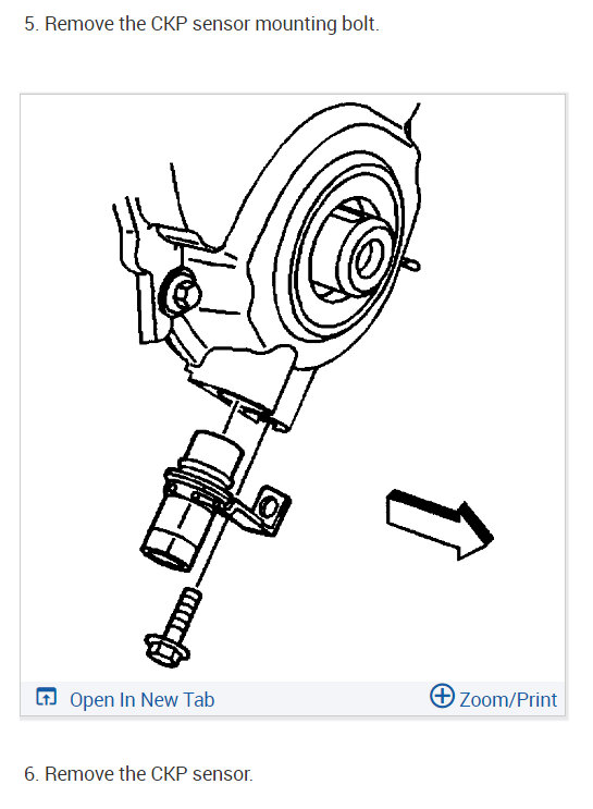

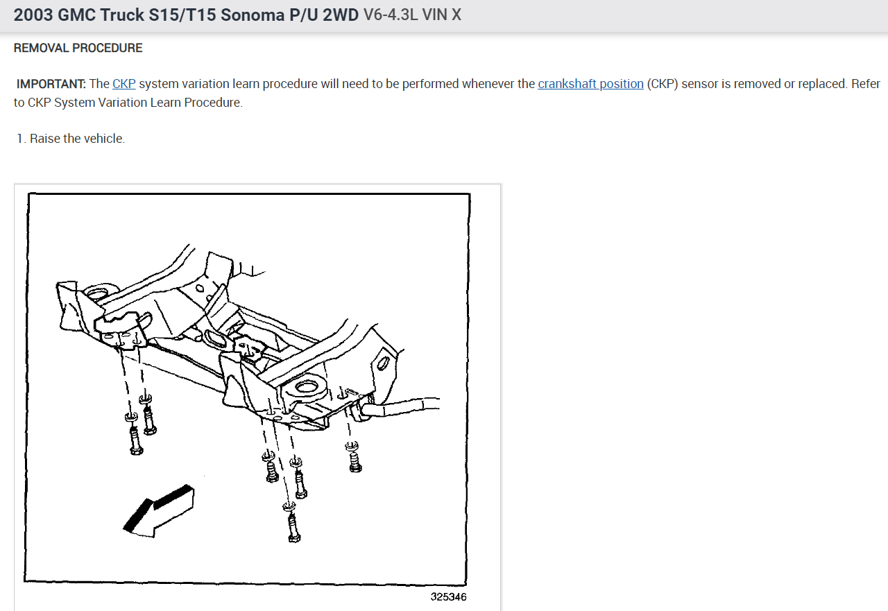

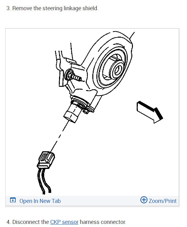

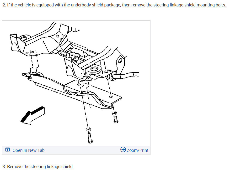

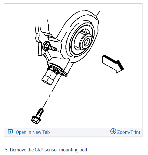

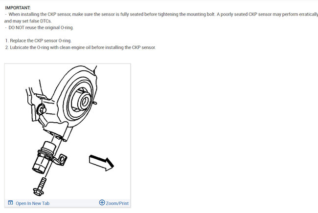

Yep, that will do it, the crankshaft sensor must be working for the engine to run, I would check the electrical connector at the sensor and if it is good shape replace the sensor. Here is the location of the sensor so you can check it out. Below.
