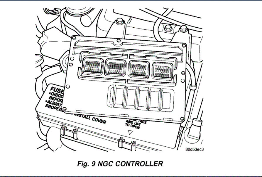

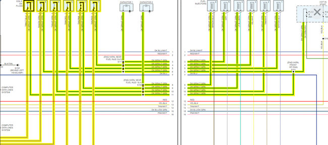

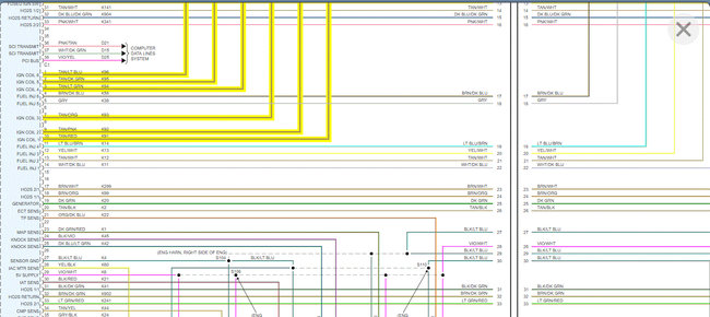

I attached the diagram of the coils to the ECM. You need to the wiring to the ECM to be sure there is voltage to the connector.
Aug 29, 2020 at 9:33 AM

Sorry I'm not tech literate when it comes to circuits and stuff like that. but if I have voltage coming to the ground wire on all of the coils from the PCM which is 13 volts what does that mean?
Aug 30, 2020 at 3:40 AM
LOREN STOVER
  • 130 POSTS
One more thing; if I'm wrong here then how do I check for signal from the PCM? I don't know if it's ohms or voltage or what it is.
Aug 30, 2020 at 3:42 AM
No, the voltage goes to the ECM from the coils. If there is voltage there then the ECM is the issue.
Aug 30, 2020 at 3:45 AM
LOREN STOVER
  • 130 POSTS
Let me see if I'm getting this right. so if there is voltage at the connector to the PCM then the PCM is the issue, correct? because all of my coils have the same voltage on both wires and still 3 coils are not working.
Aug 30, 2020 at 3:51 AM
Correct. The ECM inside circuitry is what controls the grounds for those 3 coils.
Aug 30, 2020 at 3:59 AM

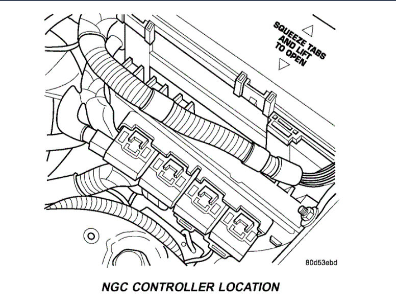

Okay. one more thing; is there a diagram of the plug I need to look at? because all my wires are discolored from age.
Aug 30, 2020 at 4:02 AM
LOREN STOVER
  • 130 POSTS
Sorry, I meant connector at the PCM.
I attached the diagram back a few posts and I highlighted the wires and the connector numbers for you.

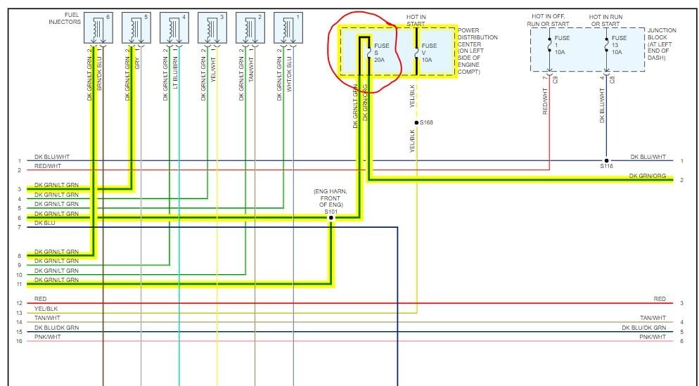

Do I need to unplug the connector to the coil before checking for voltage? I just realized that's where my voltage could come from on the ground wire.
Aug 30, 2020 at 4:57 AM
No, leave it connected with the key on.
The voltage comes from the injector.
Aug 30, 2020 at 5:13 AM

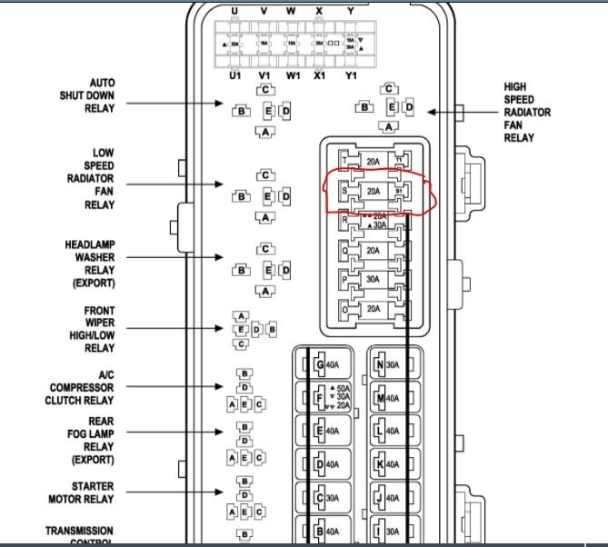

I checked all the power wires going to the coils and none of them have a 5 volt reference. what do I do next?
Sep 22, 2020 at 5:37 AM
You need battery voltage to the coils, not 5 volts.
The power comes from Fuse S in the under hood fuse block. Check for power on both sides of the fuse.
