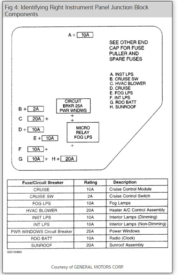

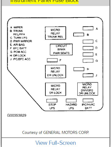

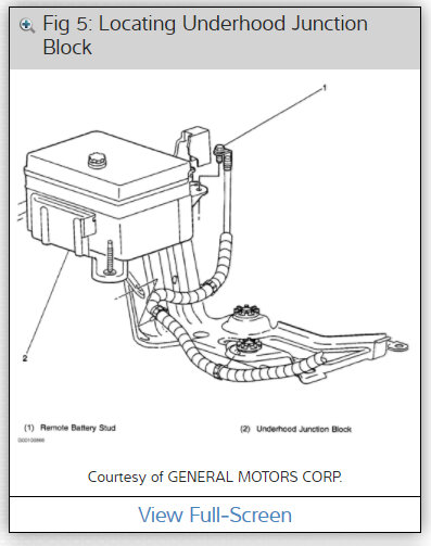

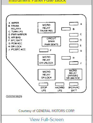

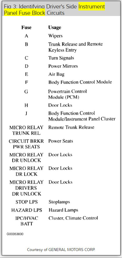

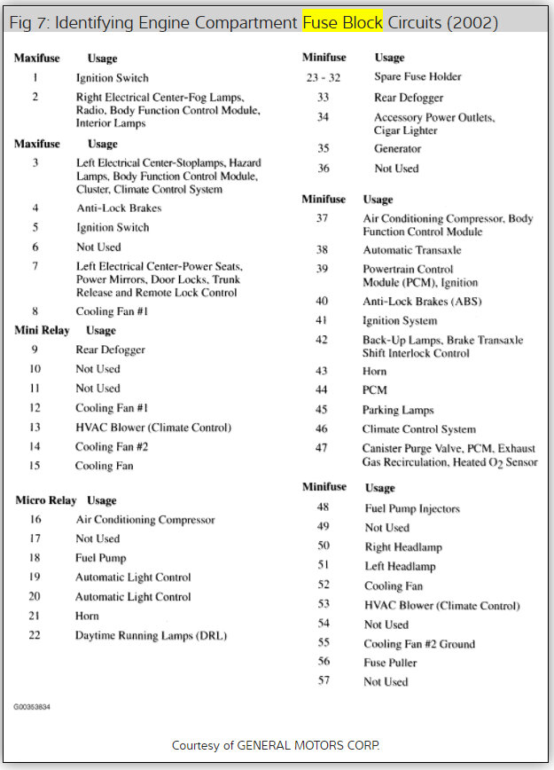

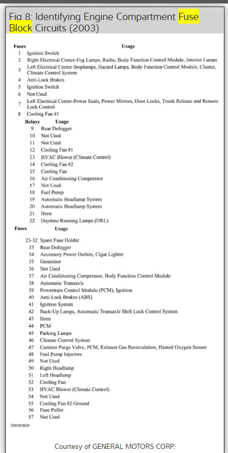

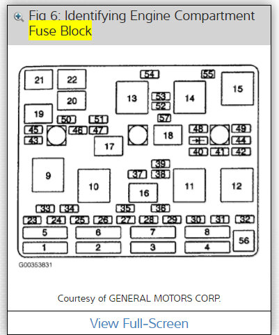

Crank no start. Fuses are good, alternator and starter as well as battery brand new. Fuel pump works. When it cranks nothing at all on instrument panel does nothing.
Dec 21, 2022 at 5:50 AM
  • 55,721 POSTS
Hi Mary,
We should start by check the fuses. here is a guide that can help with the fuse locations as well in the images below:
this guide can help as well
https://www.2carpros.com/articles/car-not-running-advanced
How does the engine sound when it is cranking over? Check the fuses with the key on and get back to me. Check out the images (below). Please let us know what you find.
