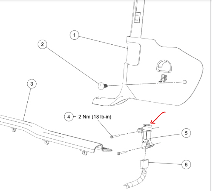

My car has a crank no start after installing new FPDM, checked all fuses relayes and tried to reinstall old on still don't start. It has new fuel pump, sender, injectors and fuel rail sensor.
Jul 2, 2026 at 3:34 AM
  • 55,732 POSTS

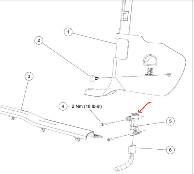

Did it not start before and tis is why you replaced the FPDM? I would check the inertia switch reset button first. Also, can you please upload a short video of the engine cranking so I can tell if the engine is in good shape? Here is the location of the inertia switch which is behind the driver side kick panel so you can check it and a video of how to tell which system is failing which is a good starting point so I can help you get the engine running again.
https://www.youtube.com/watch?v=lXLJbuAZ4CE
and
https://www.youtube.com/watch?v=dCjmRL3p4Cs
Push down on the button.
Check out the images (below). Please let me know what happens.
