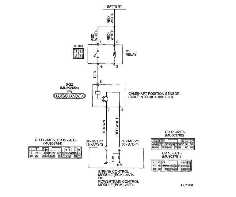

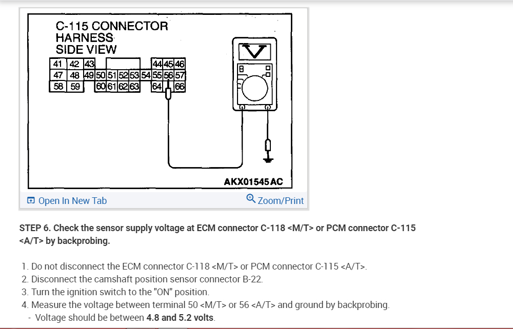

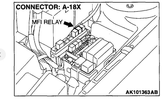

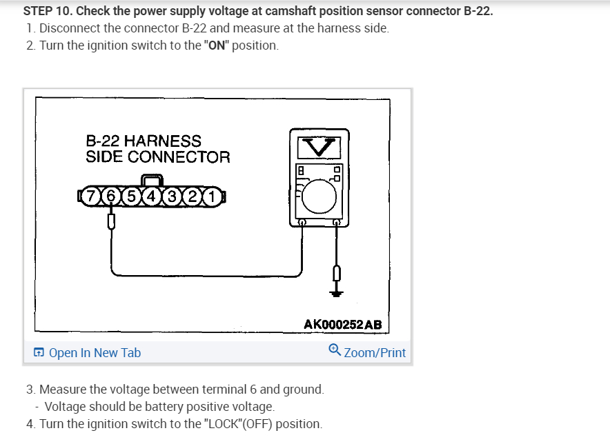

I replaced everything connecting from the camshaft to the distributor. I got spark replaced fuel pump gets fuel. Replaced crank sensor and still not start. Still pops a code saying it's camshaft position sensor or single sensor bank 1. And for some reason my odometer was saying I was driving when car was not running.

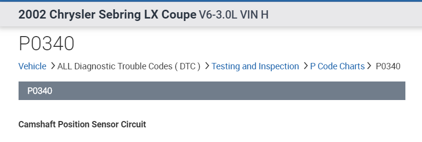

SCGRANTURISMO
  • 4,897 POSTS
What was the Direct Trouble Code[DTC] that you pulled with your code reader? We can give you specific instructions on how to repair your vehicle from the manufacturer if we have the DTC number available.

HENDRICKSJUDAH
  • 7 POSTS
P0440 generic. Camshaft position sensor A circuit bank 1 or single sensor.
Saturday, November 2nd, 2019 AT 10:12 AM
HENDRICKSJUDAH
  • 7 POSTS
Sorry p0340.
Saturday, November 2nd, 2019 AT 10:13 AM

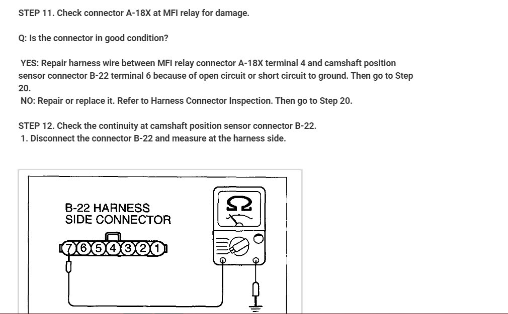

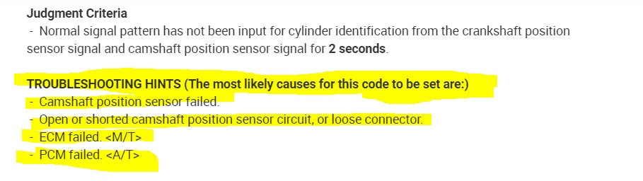

SCGRANTURISMO
  • 4,897 POSTS

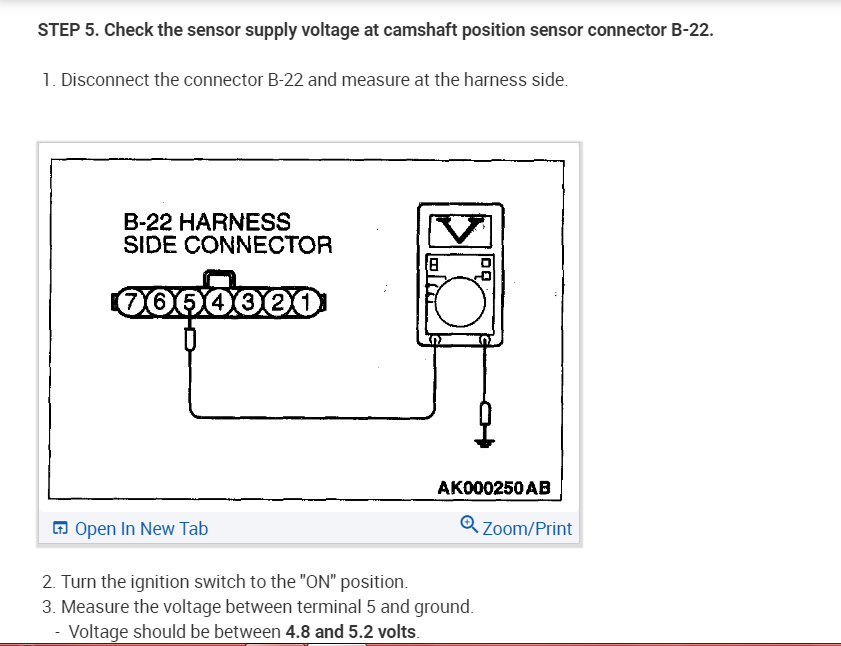

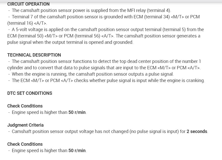

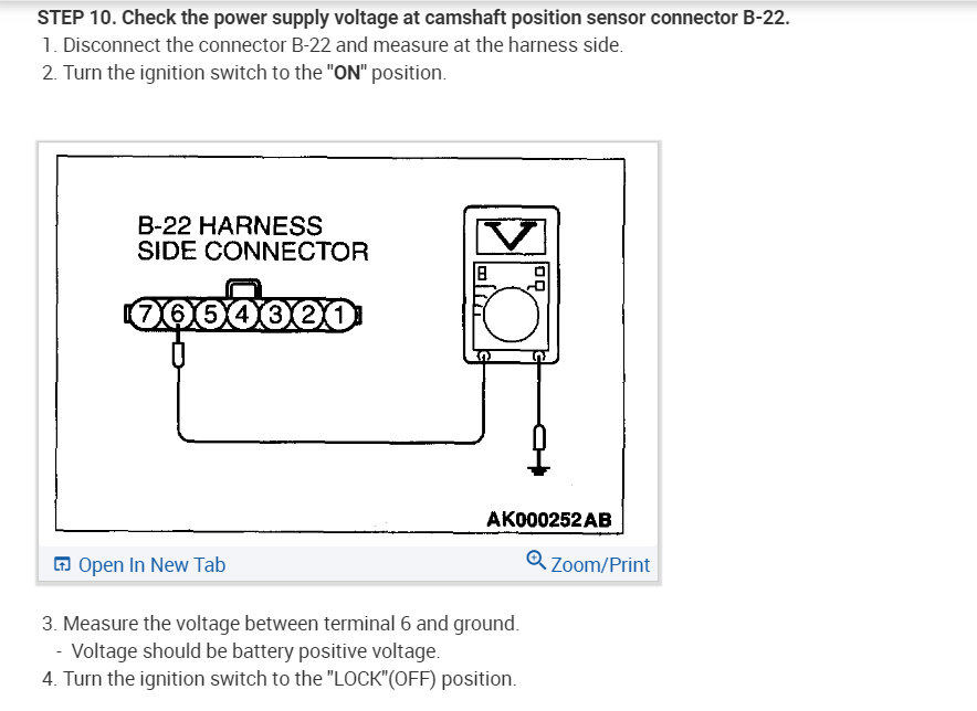

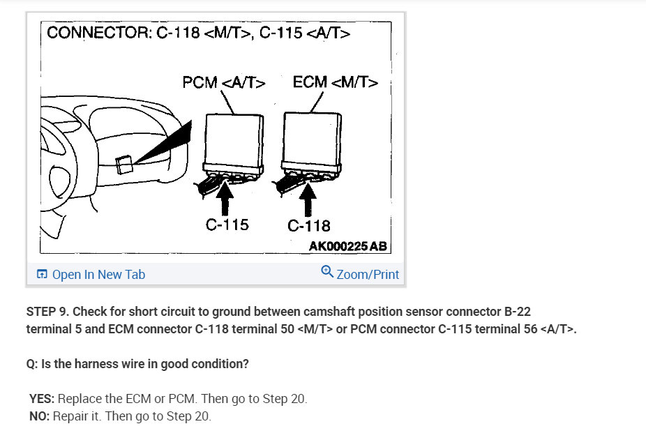

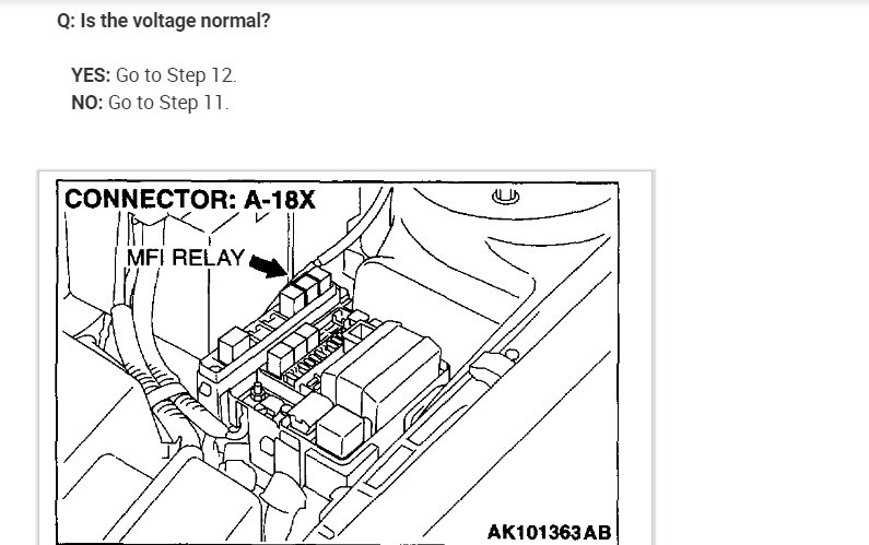

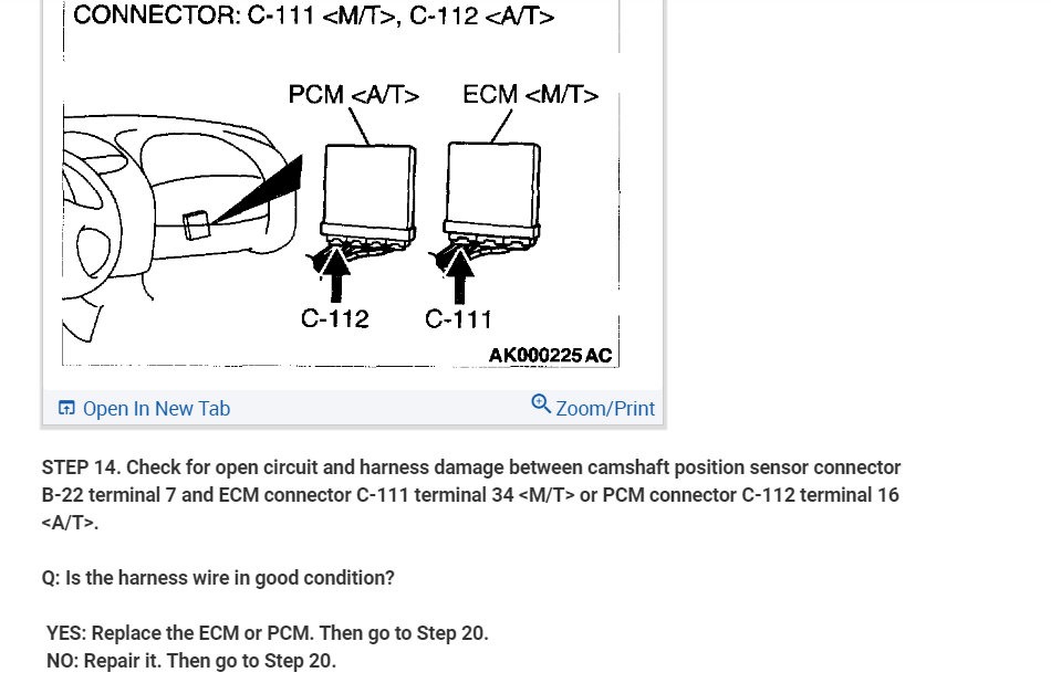

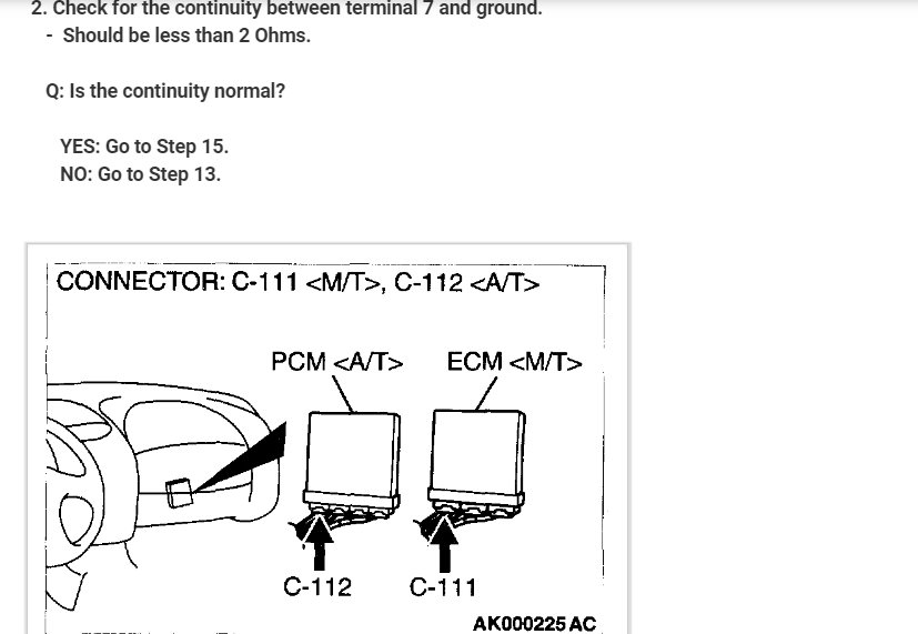

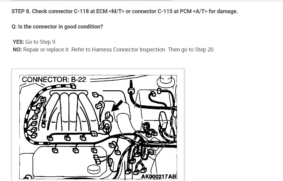

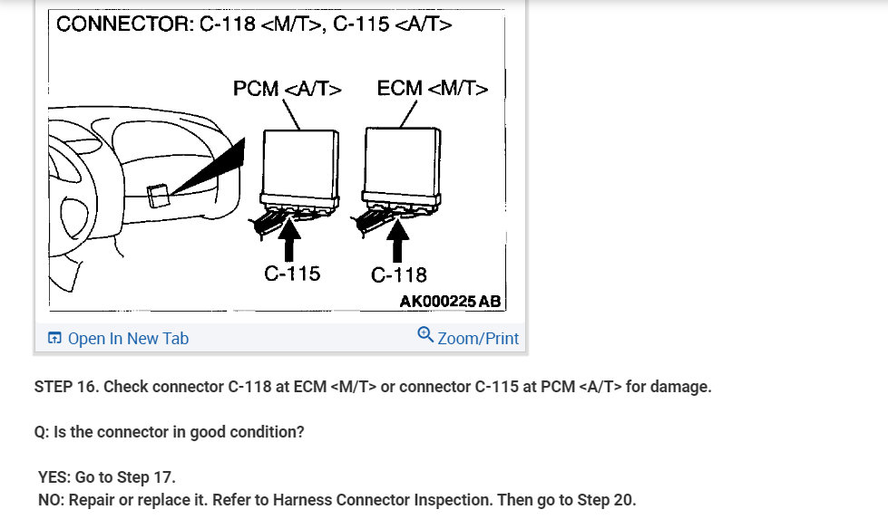

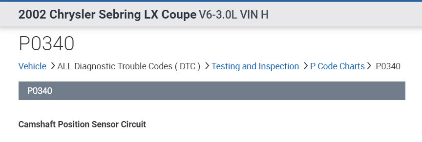

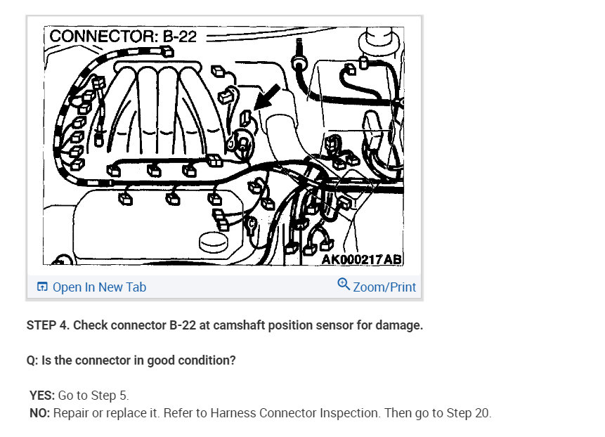

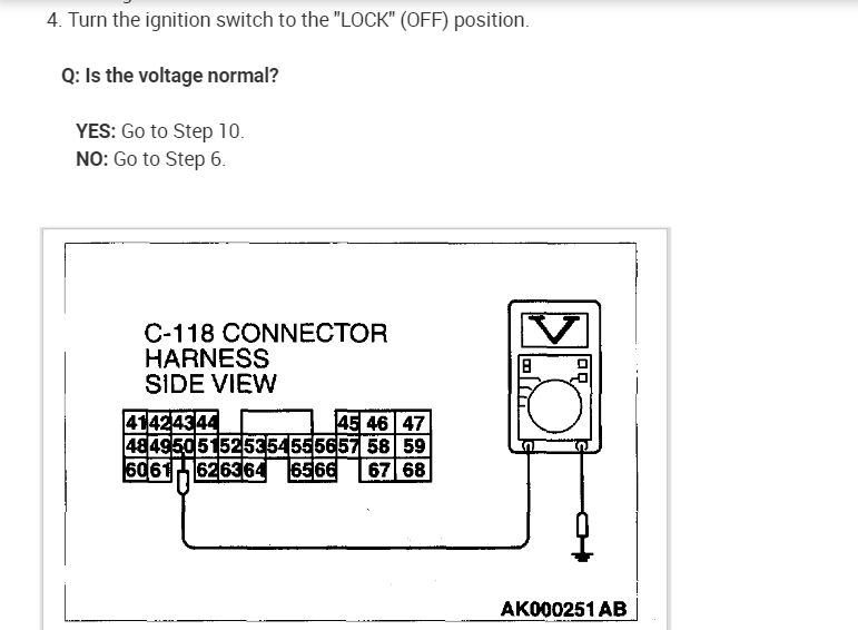

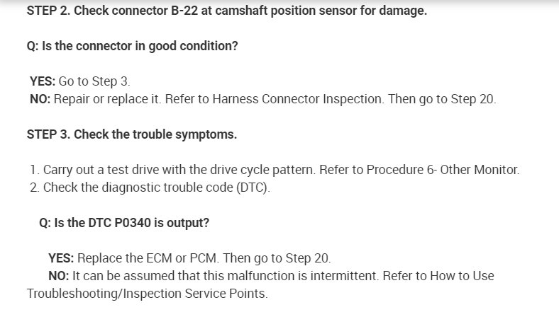

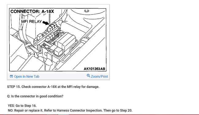

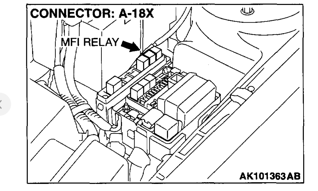

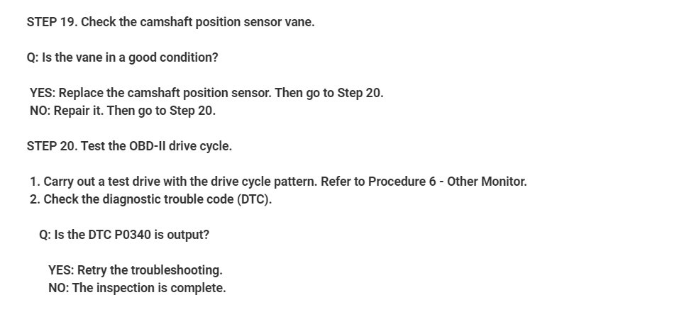

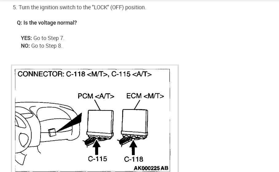

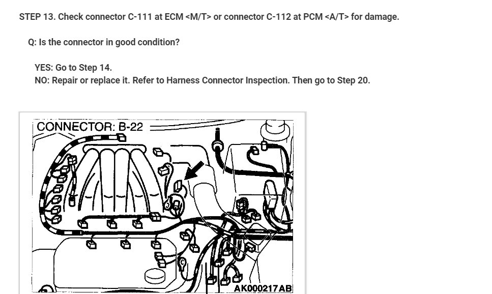

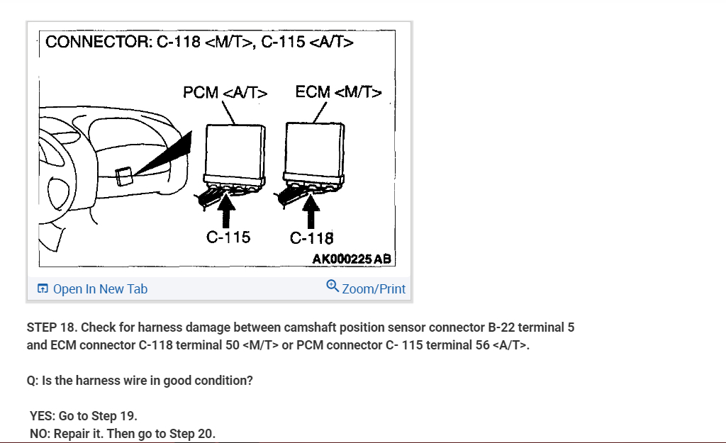

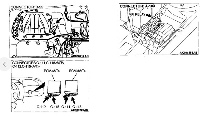

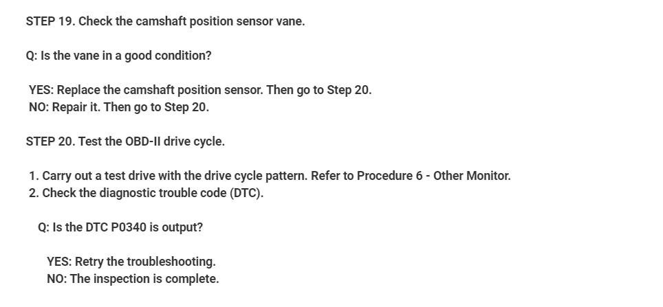

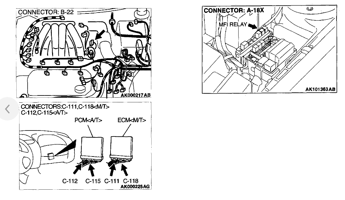

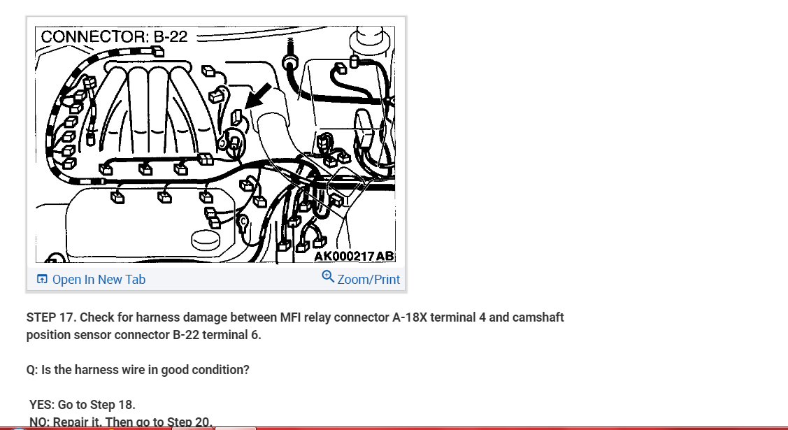

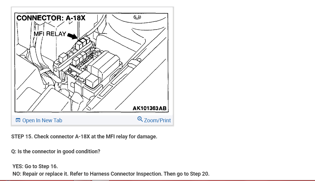

Hello again,
I would start by replacing the Camshaft Position Sensor[CMP] first. If the problem still exists then I would inspect the CMP electrical connector and associated wiring for loose connection or an open in the wire. Regardless, I have included the diagnostic troubleshooting guide for your vehicle for DTC P0340. You will need to use a Digital Multi-meter[DMM] for these tests, so here is a link below explaining how to use one, if needed:
Please go through this guide and get back to us with what you are able to find out.
Thanks,
Alex

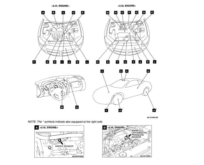

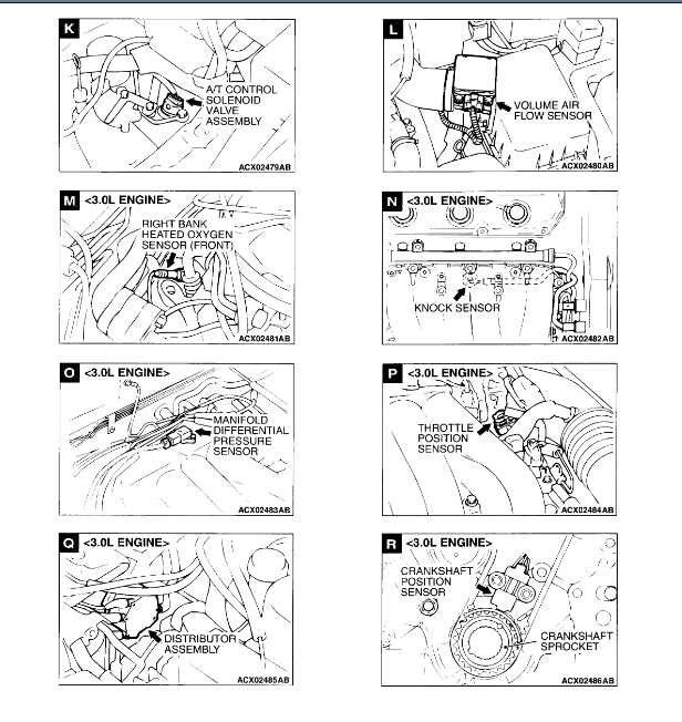

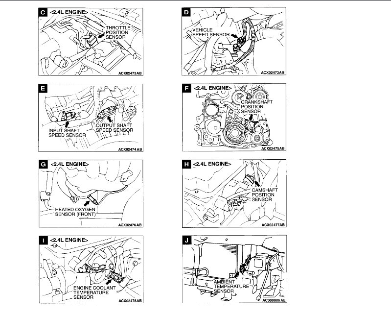

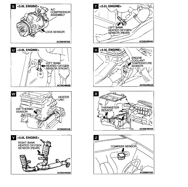

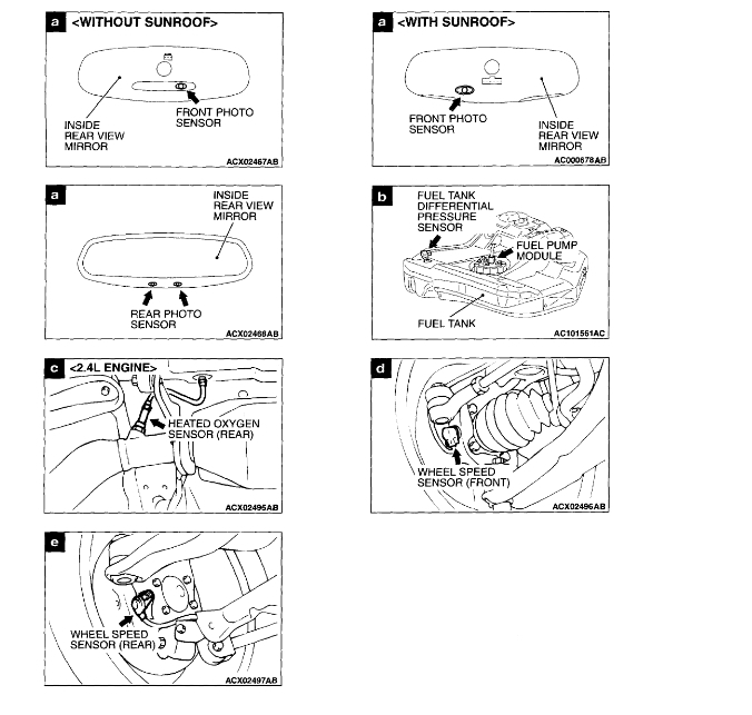

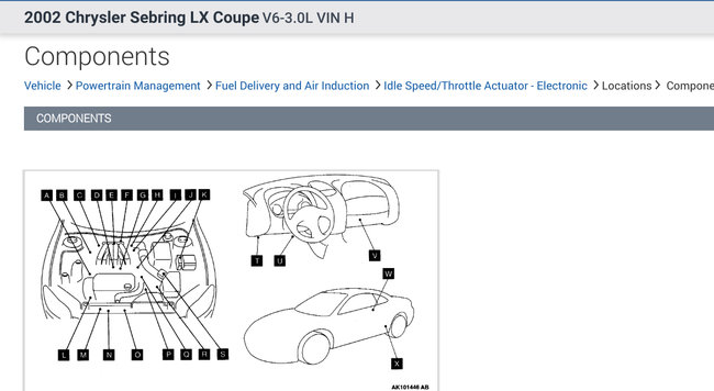

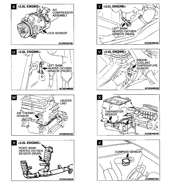

Where is the location of the cam shaft position sensor?
Sunday, November 3rd, 2019 AT 4:01 PM

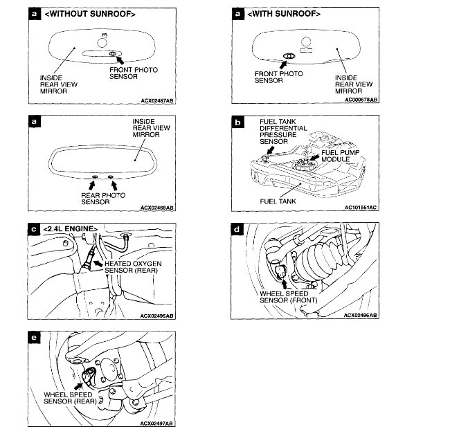

SCGRANTURISMO
  • 4,897 POSTS

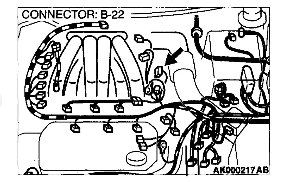

Hello again,
Here are all the sensors that I have locations on for your vehicle with the reference material available to me. I have included them in the diagrams down below. The camshaft position sensor will be in the cylinder head at the end of one or both of the camshafts. I hope this helps.
Thanks,
Alex

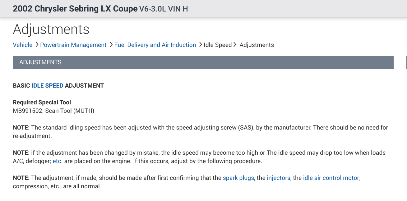

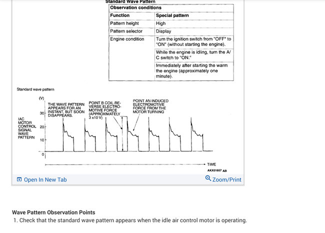

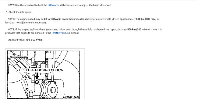

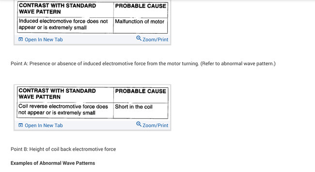

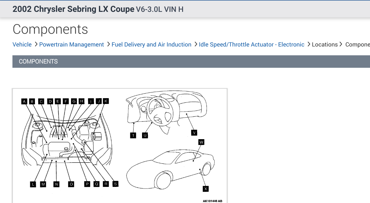

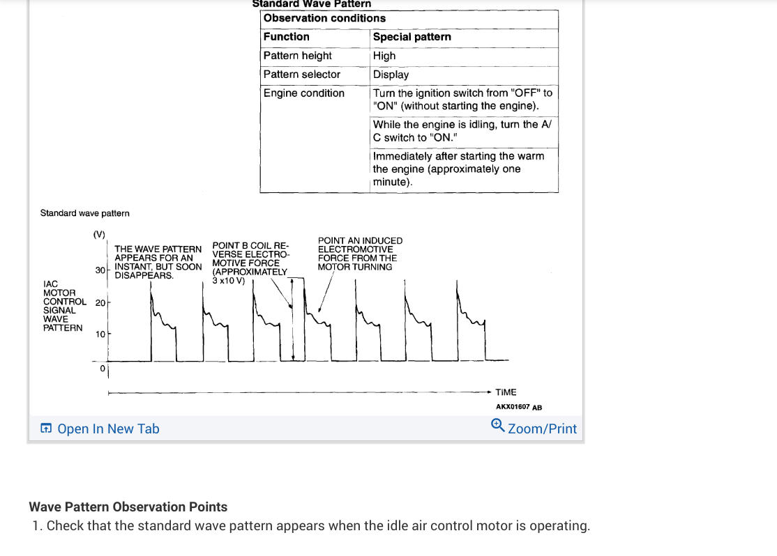

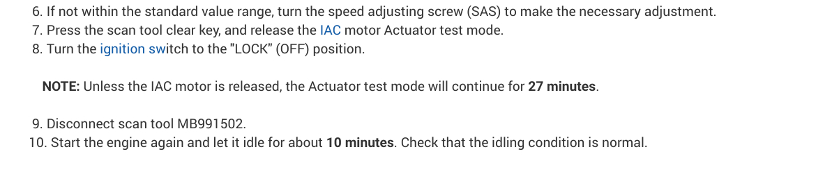

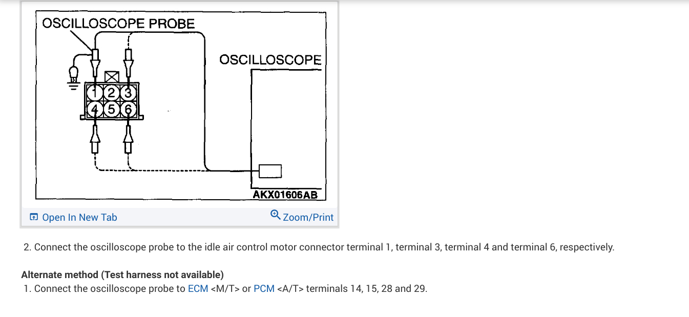

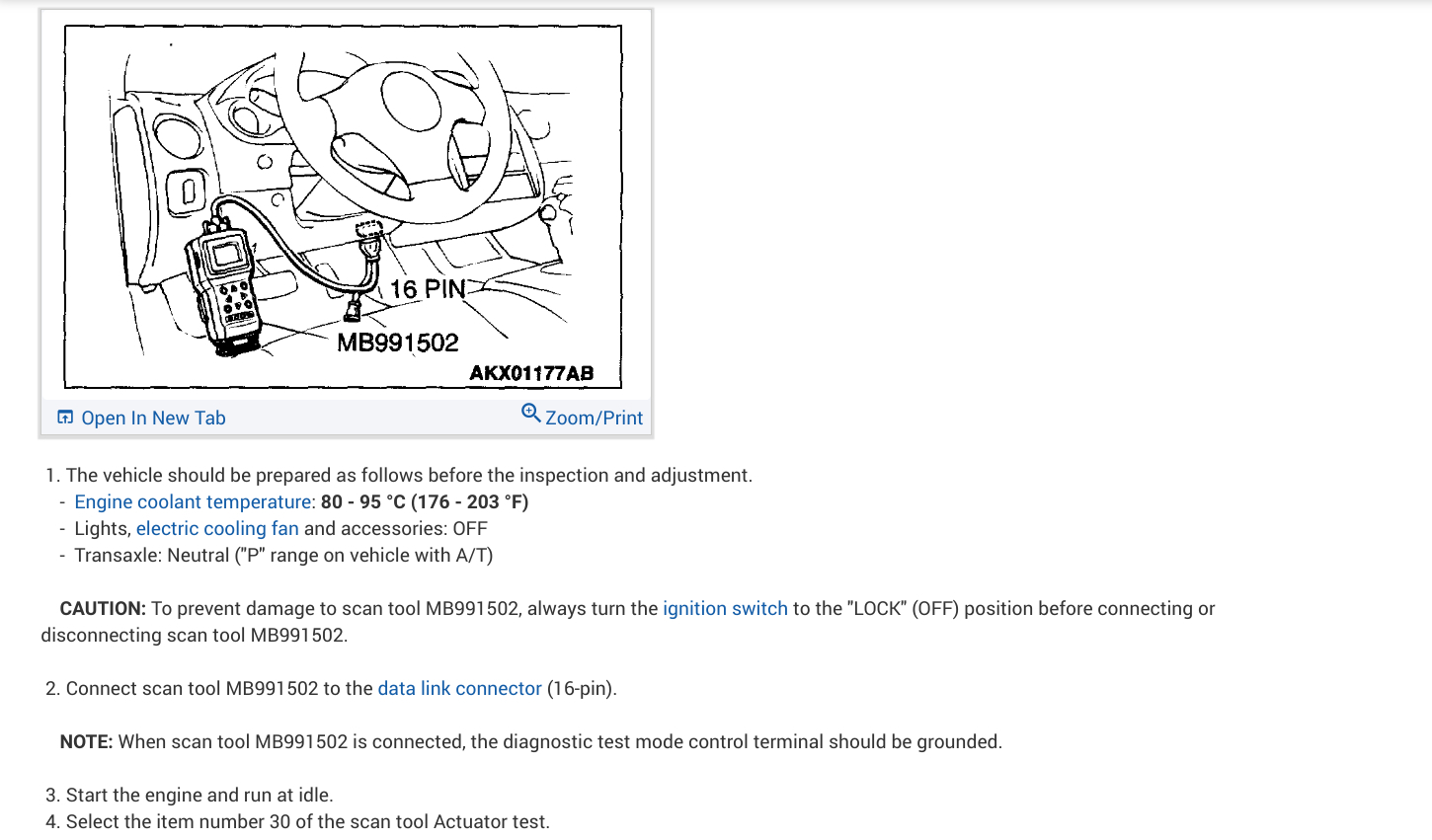

KAYLEB CARTER

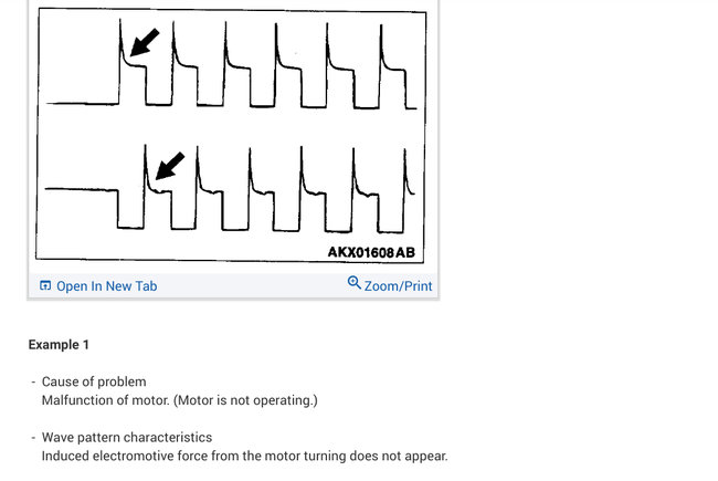

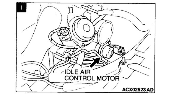

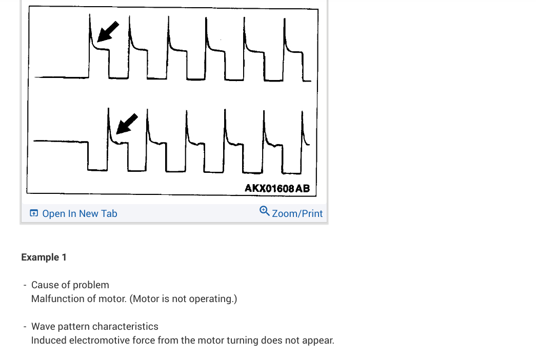

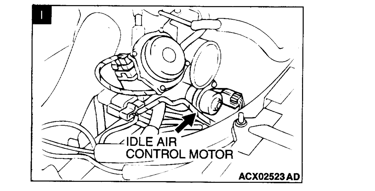

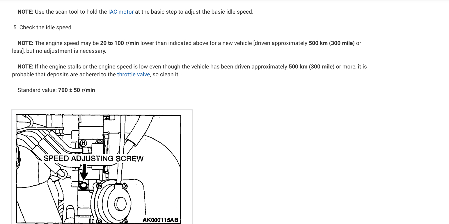

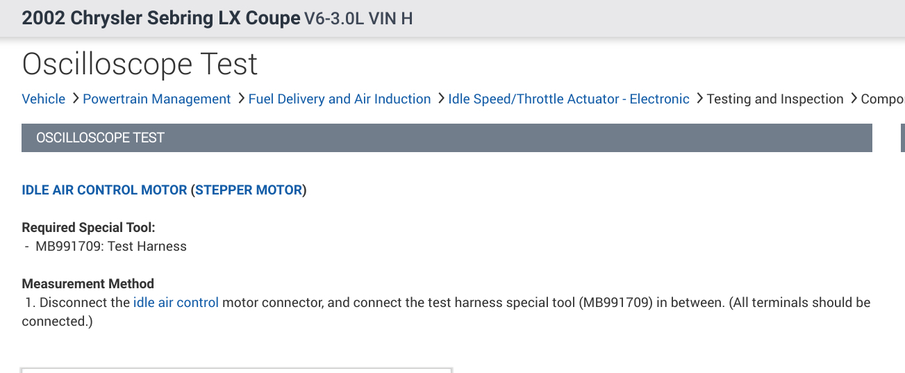

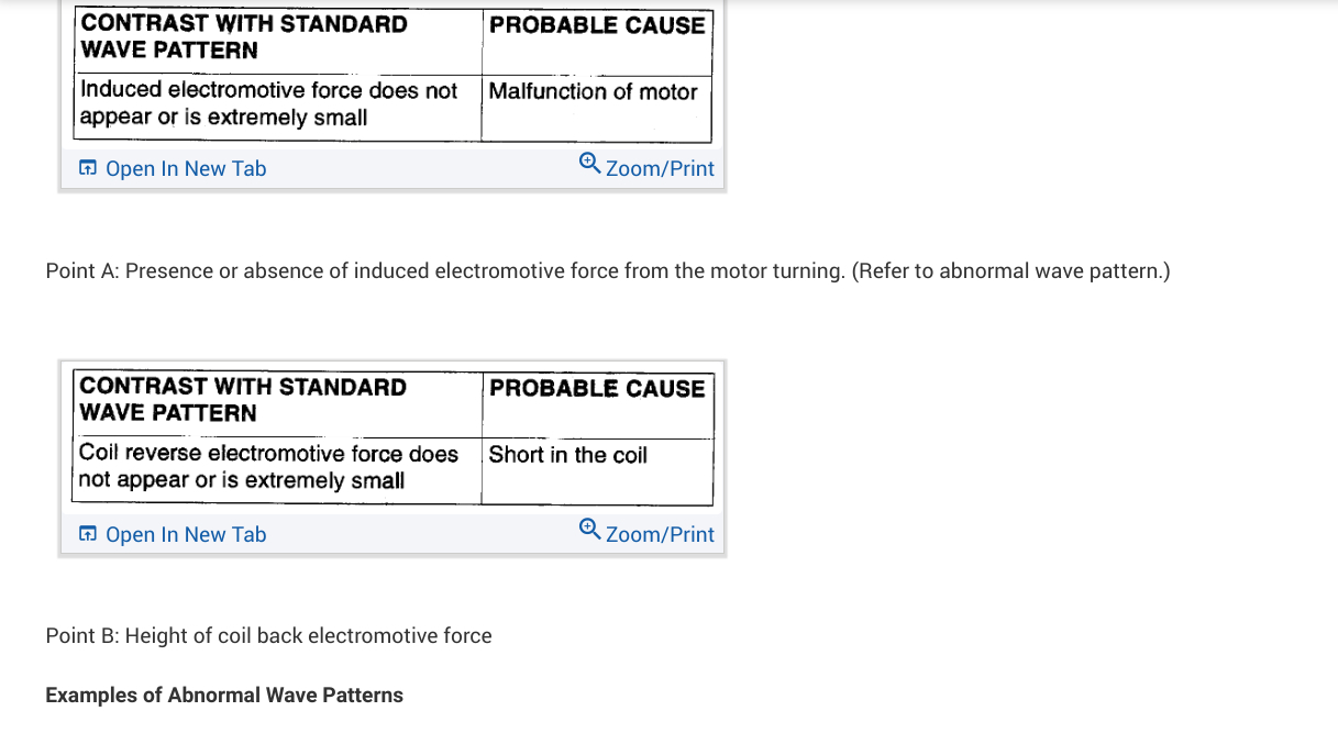

Can any of my mechanic friends help me? I'm having trouble with a 2003 Chrysler Sebring 2.7 v6 it will start but will not stay running as shown in the video. We just replaced the fuel pump and rechecked the spark plugs for gap and checked spark. It will run on starter fluid but it idles rough. Also replaced the throttle position crankshaft sensor, new battery and alternator. Any help would be appreciated.
Friday, March 27th, 2020 AT 7:40 AM
SCGRANTURISMO
  • 4,897 POSTS
Hello again.

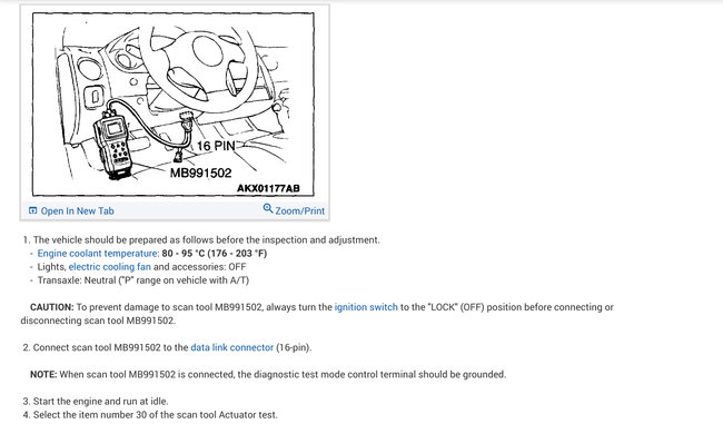

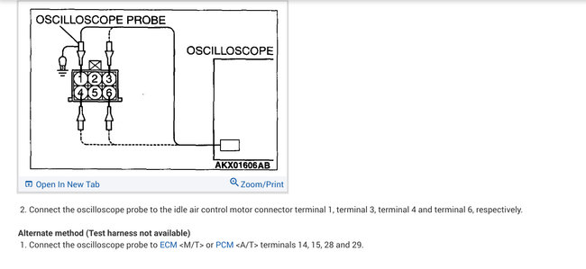

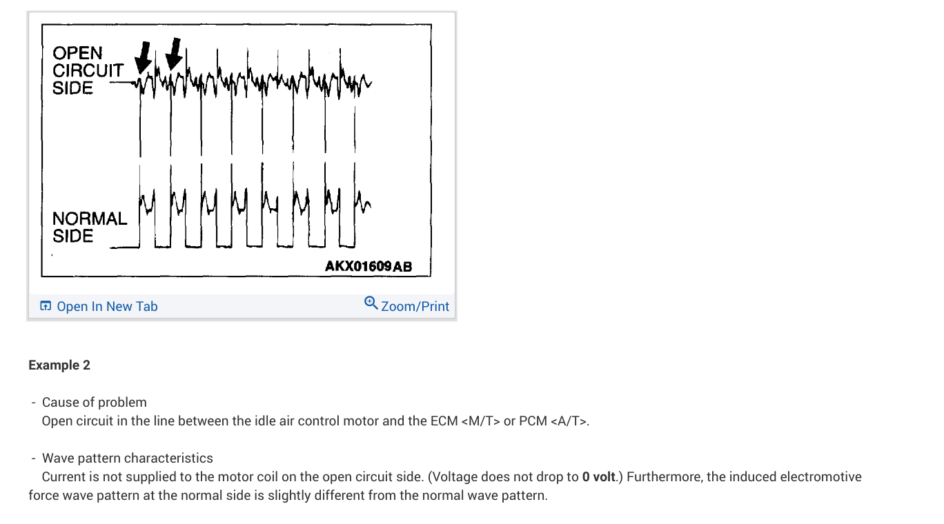

This could be a problem with your Idle Air Control Motor[IAC]. In the diagrams down below I have included the location, testing and adjustment instructions for your vehicle's IAC. The testing calls for the use of an oscilloscope, so I'm not sure how helpful it will be to you, but I sent it anyway. Please go through these guides and get back to us with what you are able to find out. We can go from there if necessary.
