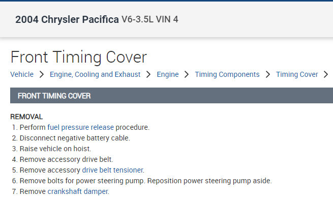

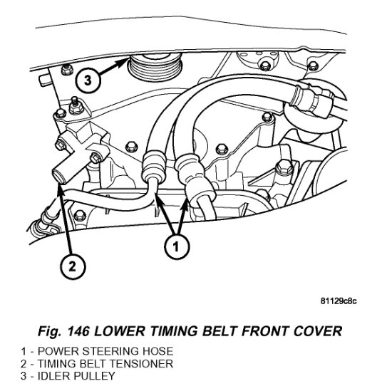

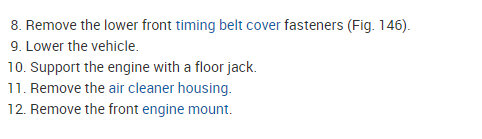

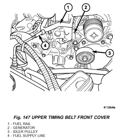

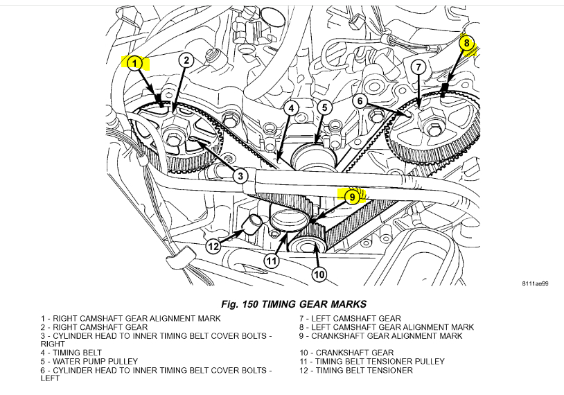

Don't crank it anymore. There is little or no compression and it will not start. It sounds like the timing belt has either broken or jumped time. This is an interference engine, so internal damage will occur if it is far enough off time.
We need to remove the timing belt cover to see if the timing is off. Listening to it, I am 99% sure that is the problem.
I attached the directions below for removing the cover. The last picture indicates the timing marks.
Let me know if this is something you are comfortable performing.
