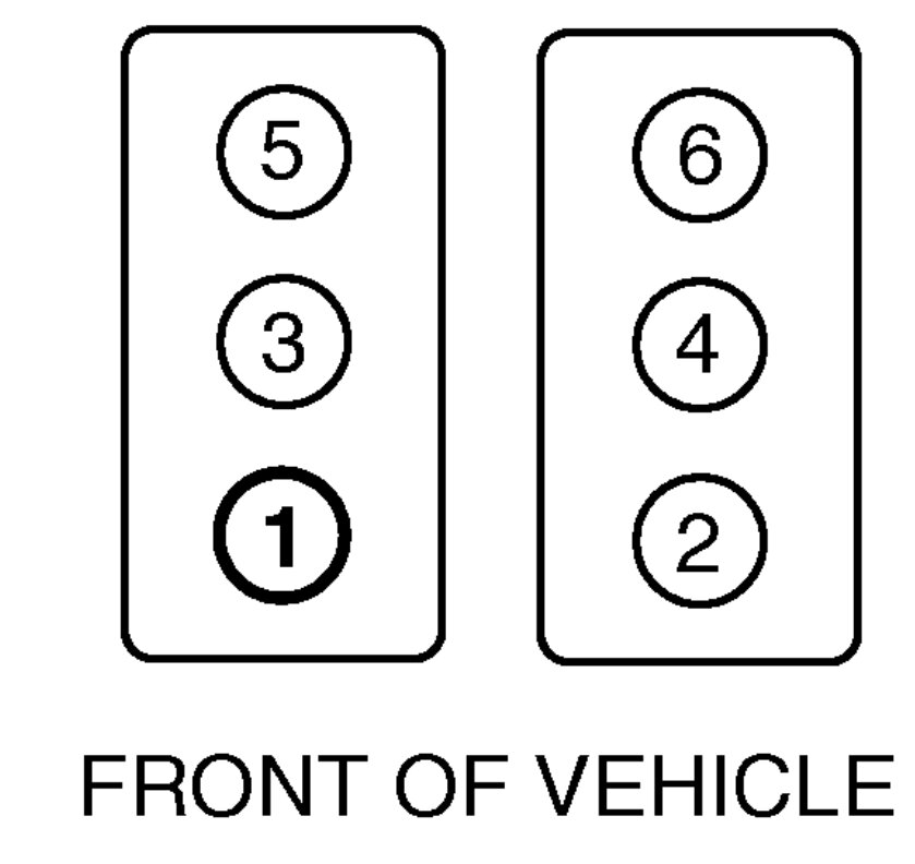

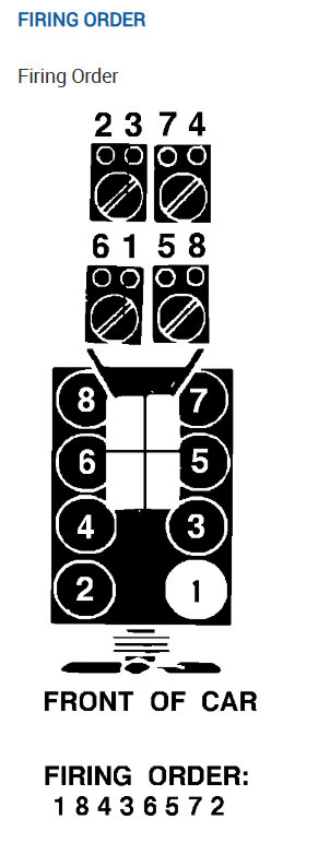

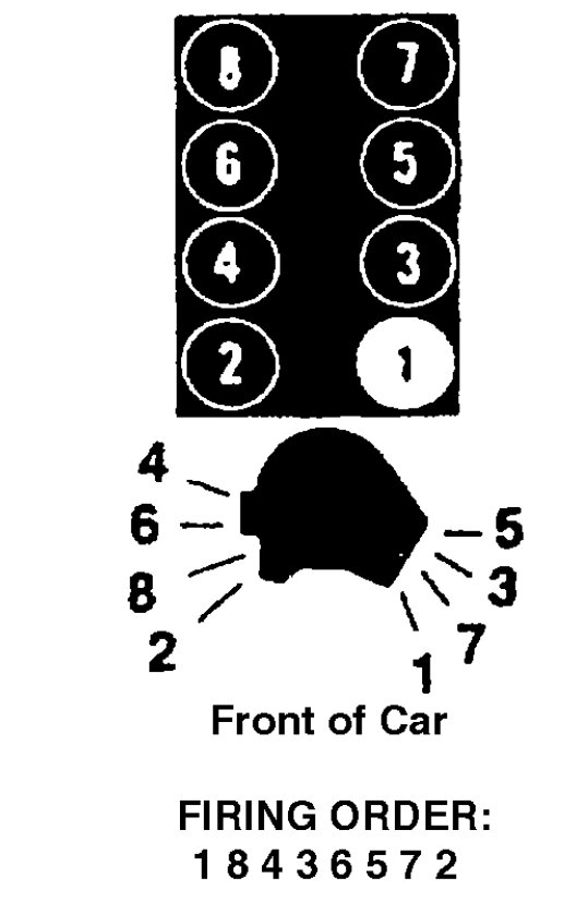

The firing order is off when you guys, I know looked at it and come back to the car either took all the spark plugs.
Mar 22, 2025 at 4:51 AM
Experienced Mechanic
55,711 POSTS
Here is the firing order for both the v8 and v6 engines:P
V6 Firing Order .................... 1-2-3-4-5-6
Please go over this video as well
Check out the images (below). Let us know if you need anything else.
