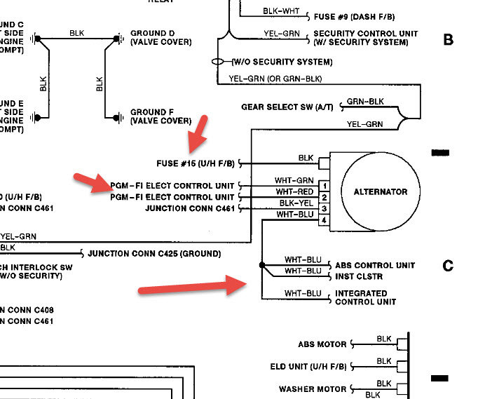

This vehicle ran fine, until it rammed into a truck. No visible damage, but car stuttered and then died. It is getting fuel and spark, although the spark may be weak, I am not sure. I was wondering if it could be the main relay. Any ideas?
Mar 31, 2017 at 3:46 PM
HMAC300
  • 48,601 POSTS
the main relay is inside the car under dash so unless that area was disturbed i would say no. If fuse box is in that area check fuses as it may have one blown as well as for pinched wires, etc. see pic for wires.
