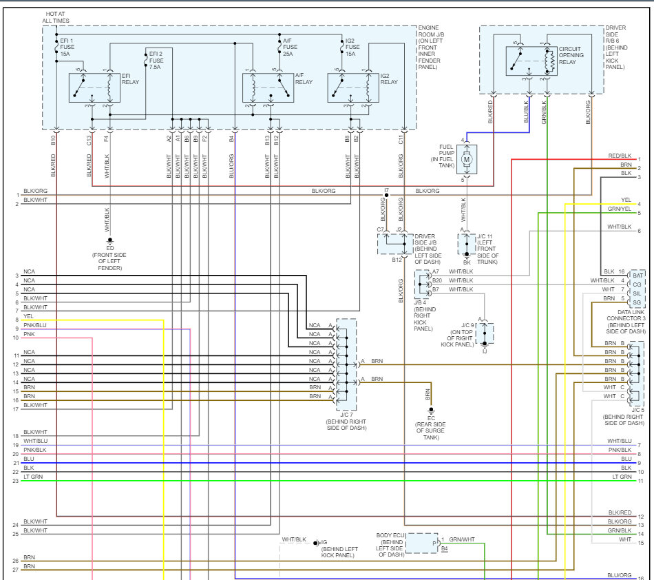

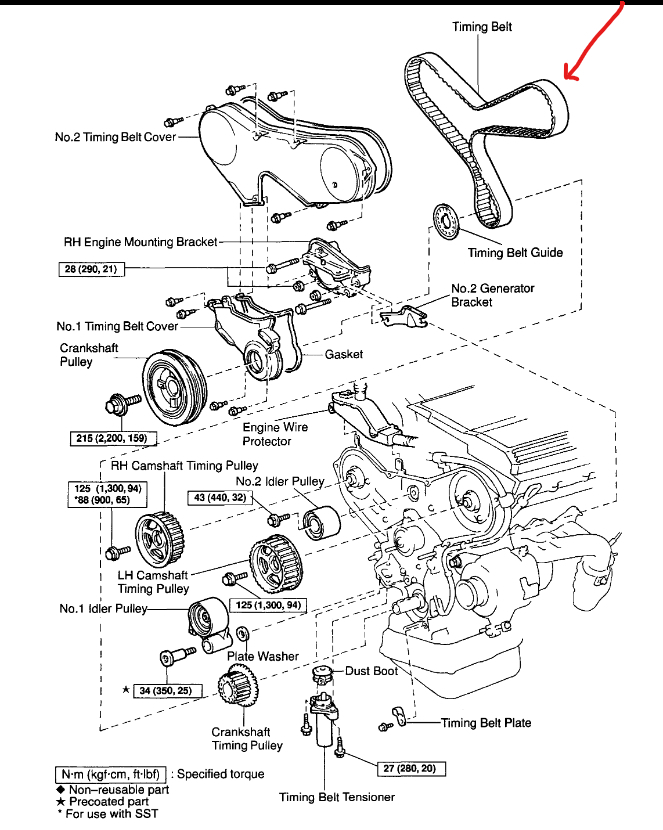

Seemingly out of nowhere my car cranks but doesn’t turn over. Plenty of battery (also tried with jumper assistance to be sure). When I turn the key, I don’t hear the pump priming, so almost certain has to be fuel delivery. Where do I start with troubleshooting? I’ve checked the fuses and relays under the hood, they are all in working order. Are there any related to this circuit in the cabin? I don’t have a diagram for the PCs fuses/relays. Thank you as always!
Oct 11, 2023 at 4:42 PM
  • 55,456 POSTS

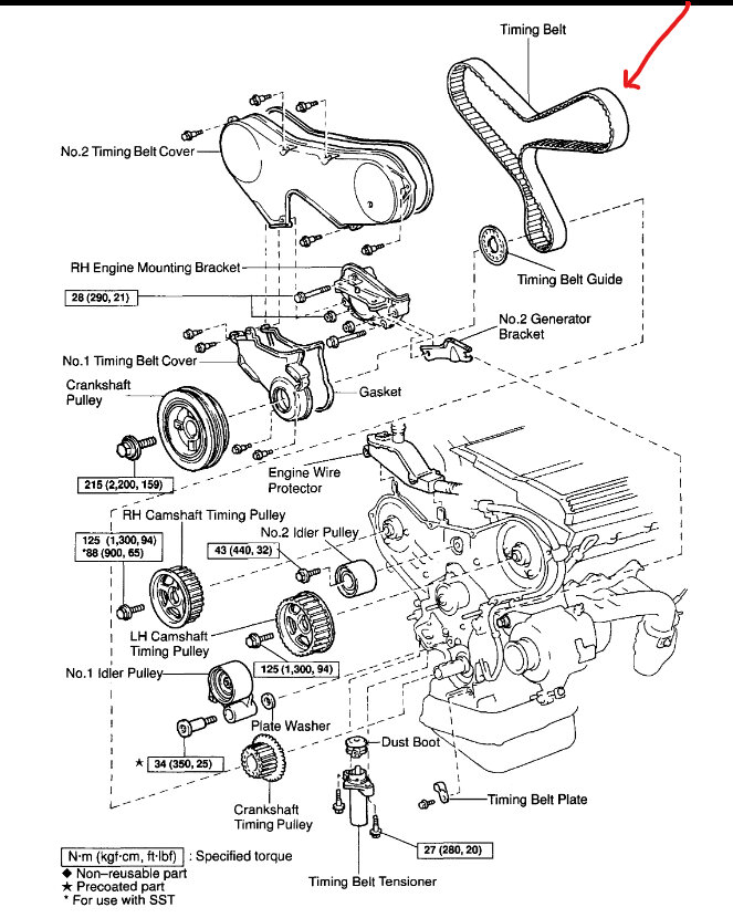

How does it sound when cranking over, does it sound like there is no compression? If so, the timing belt has let go, which is common on these vehicles. To be sure you can upload a short video of the engine cranking and I can tell for sure. Here is a diagram for the timing belt so you can see what I am talking about. Also, this guide can help as well:

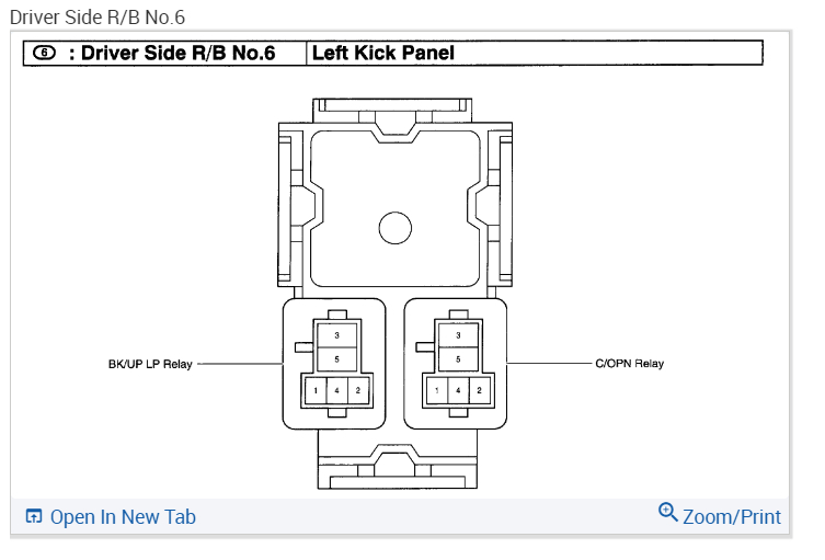

I also understand that there are a number of different relays that the fuel pump circuit runs though. are any of them in the passenger compartment? I want to check those before I assume that it’s the fuel pump itself.

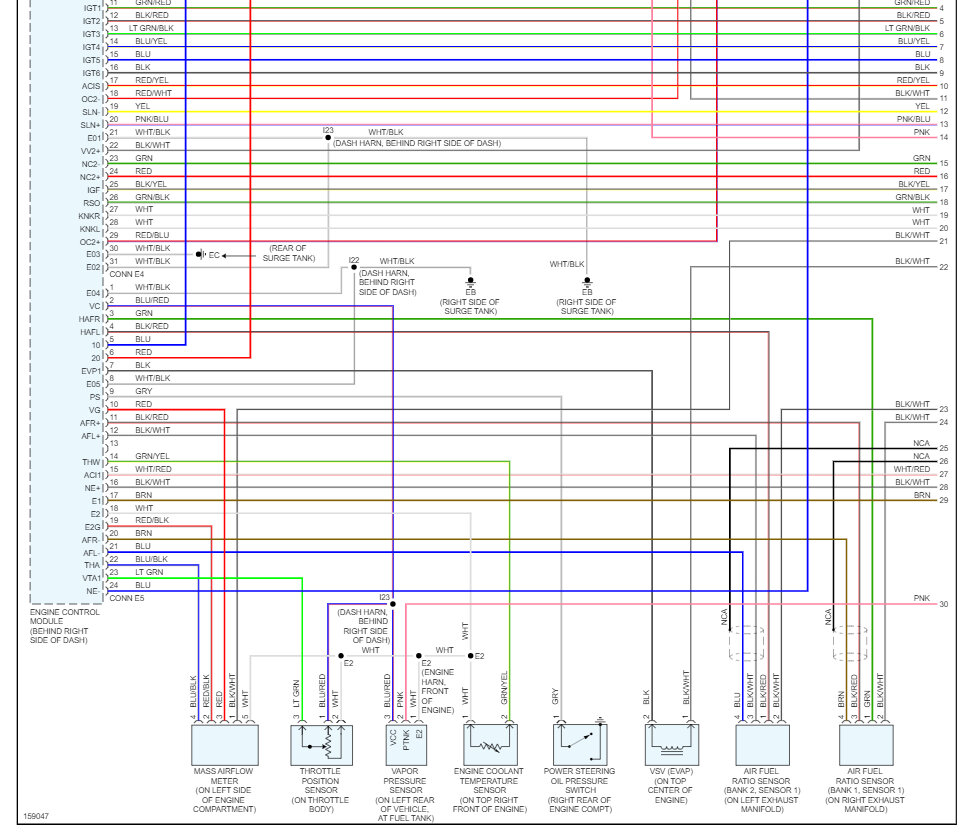

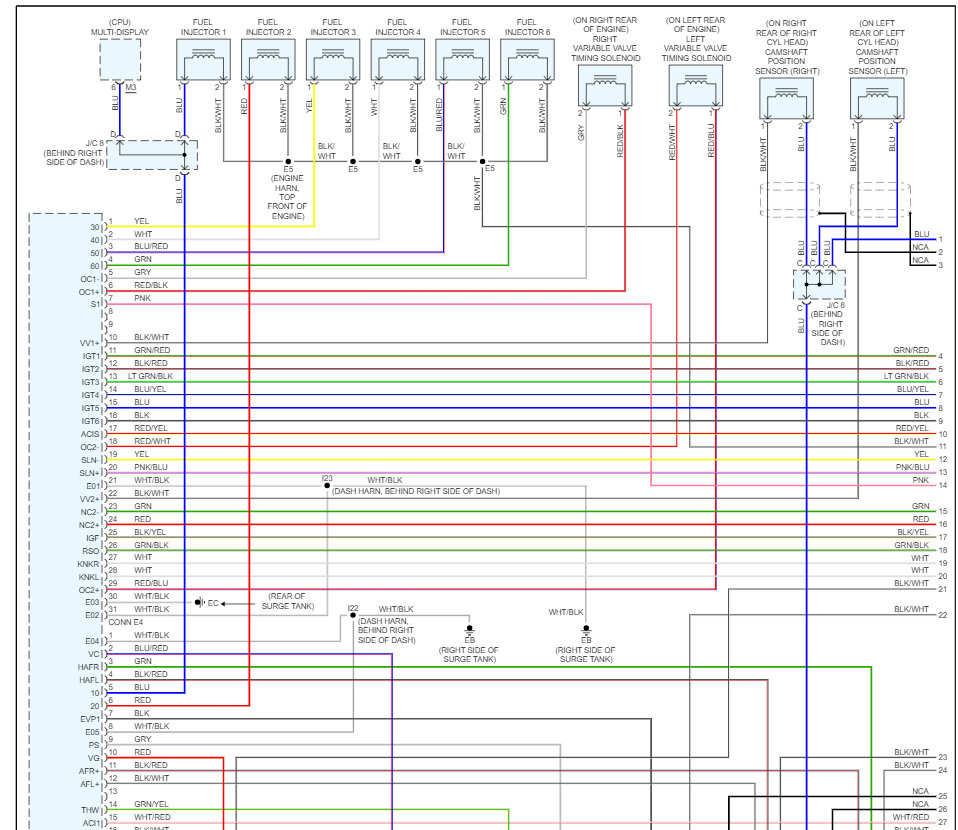

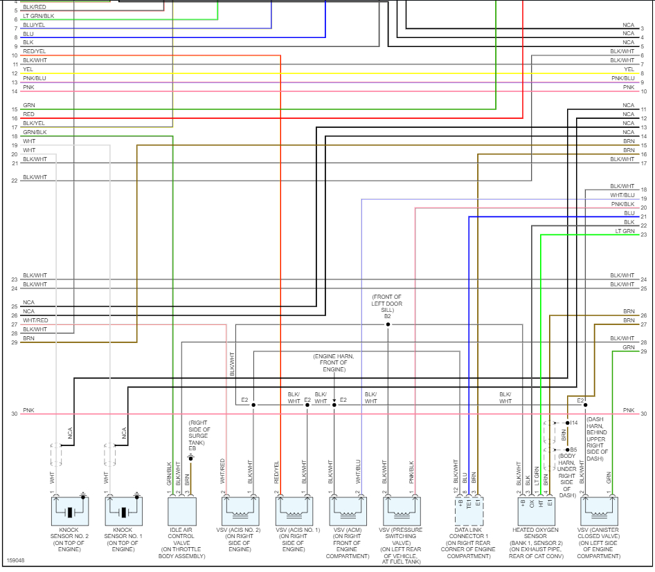

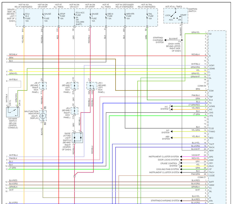

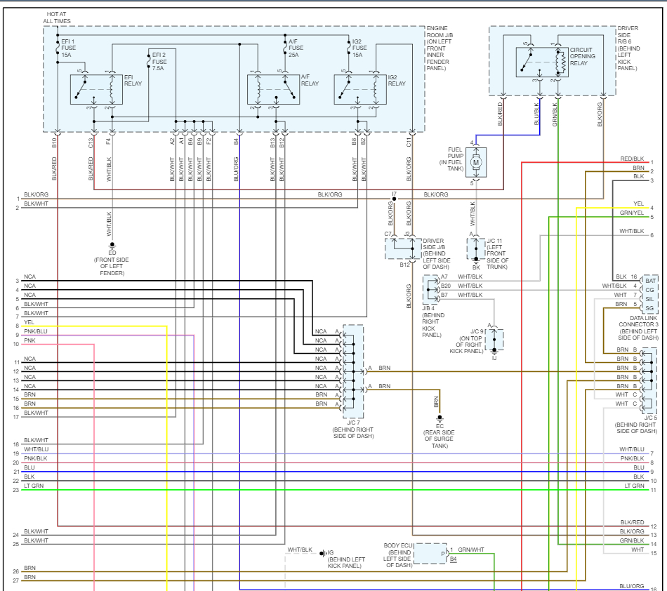

They call the fuel pump relay a "circuit open" relay. Here are the engine and fuel pump wiring diagrams for you to see how the system works. This guide can show you how to test the relay if you need it:
Here is the location of the circuit open relay as well. Check out the images (below). Please let us know what happens.

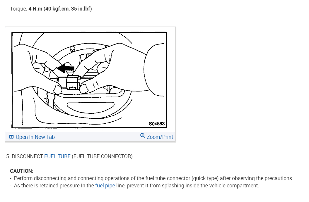

So, I tested the c/o relay, and it’s working fine. I also tested the EFI one under the hood for good measure, which is also operational.
Is it fairly safe to assume that the culprit is the fuel pump?
Oct 18, 2023 at 9:44 AM
  • 55,456 POSTS

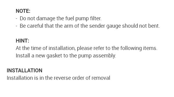

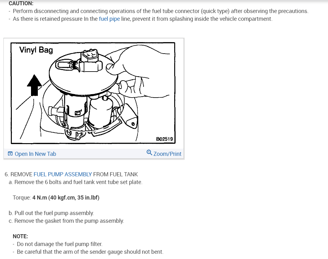

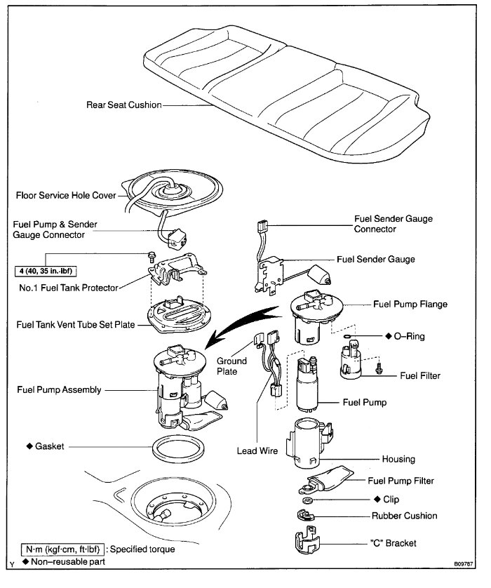

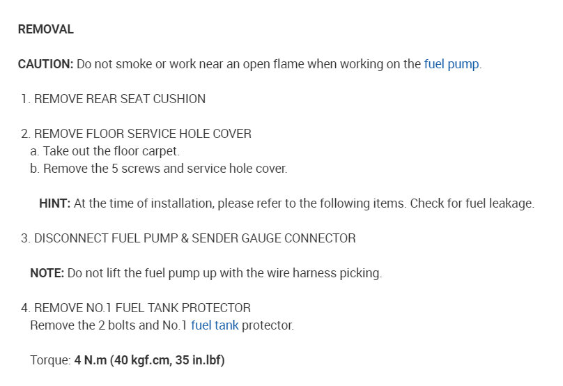

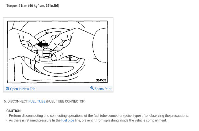

Yep, if the blu/blk wire going to the fuel pump has power when cranking and you don't hear the fuel pump is bad, here is how to change it out. Check out the images (below). Please let us know how it goes.
