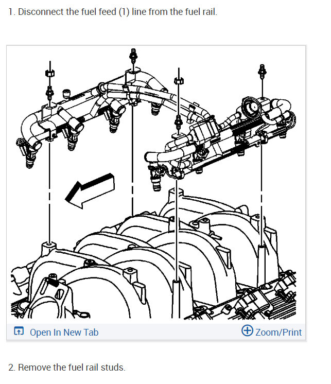

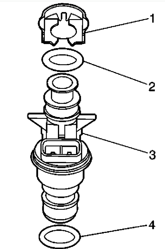

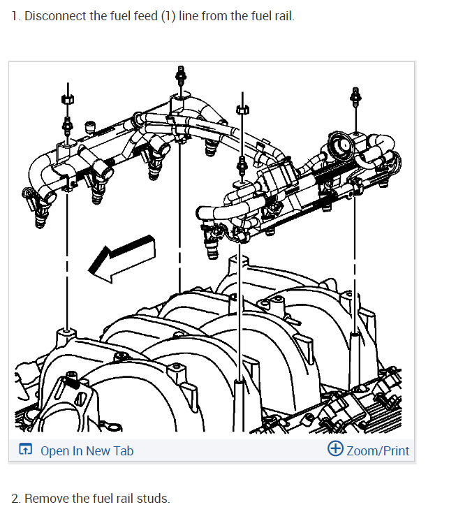

Yep, I have seen this problem before and it was a shorted fuel injector pulling the voltage down from the PCM, I would unplug all injectors to see if the voltage comes back and if so, plug the injectors in one at a time until the voltage drops, this will be the bad injector, or you can just test them, here is a guide to help:
https://www.2carpros.com/articles/how-to-test-a-fuel-injector
