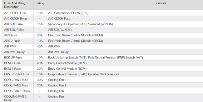

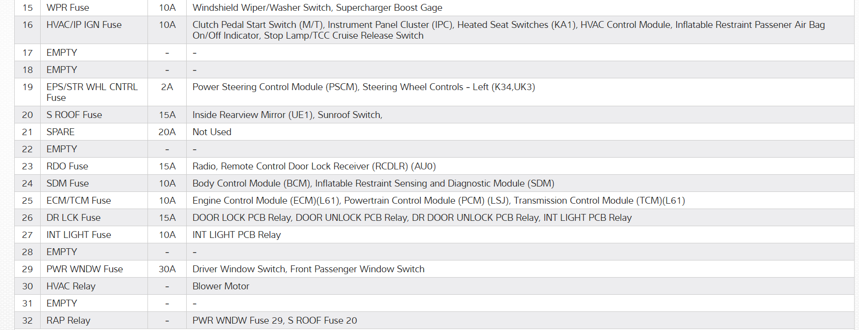

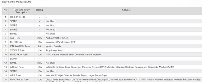

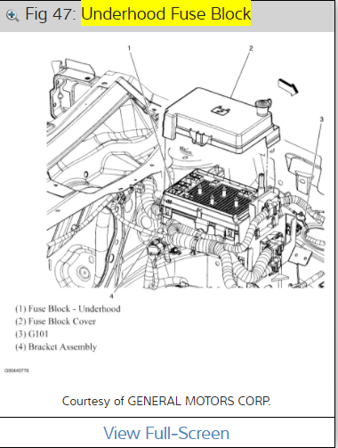

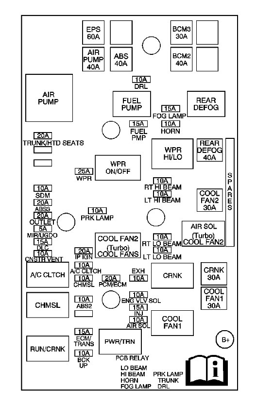

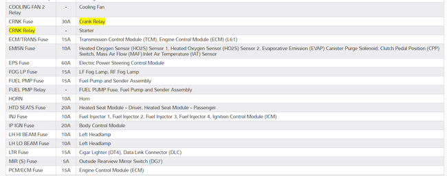

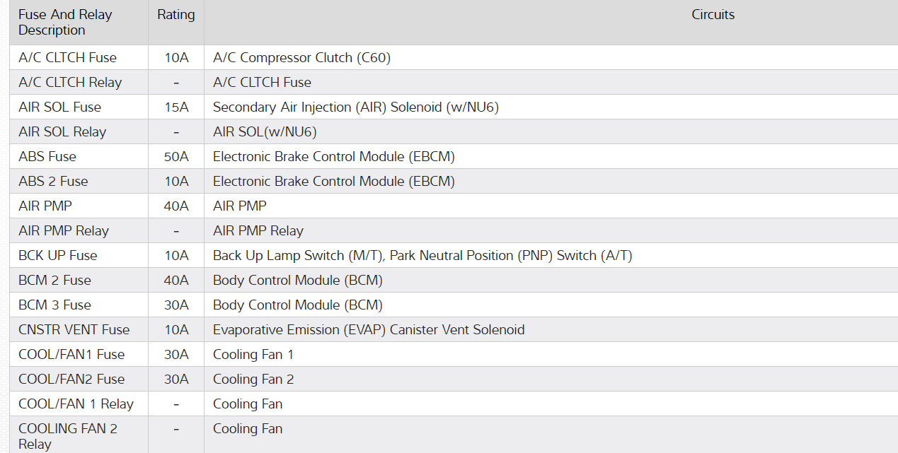

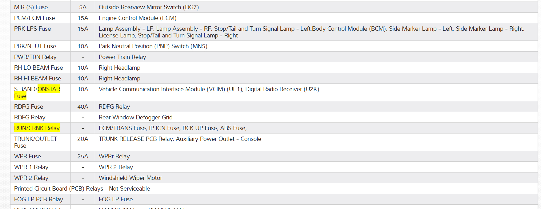

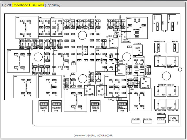

It sounds like the relay is bad even though it clicks, replace it with a new one. here is a guide to help you test it just in case:
Also here is the location of the fuel pump relay to make sure you have the correct one. Check out the diagrams (below). Let us know what happens and please upload pictures or videos of the problem.
Jun 6, 2022 at 1:23 PM

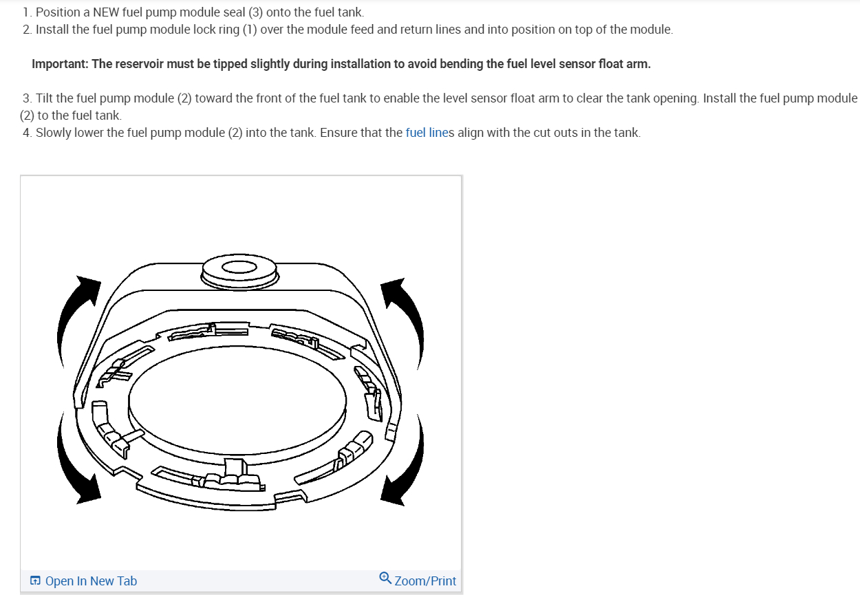

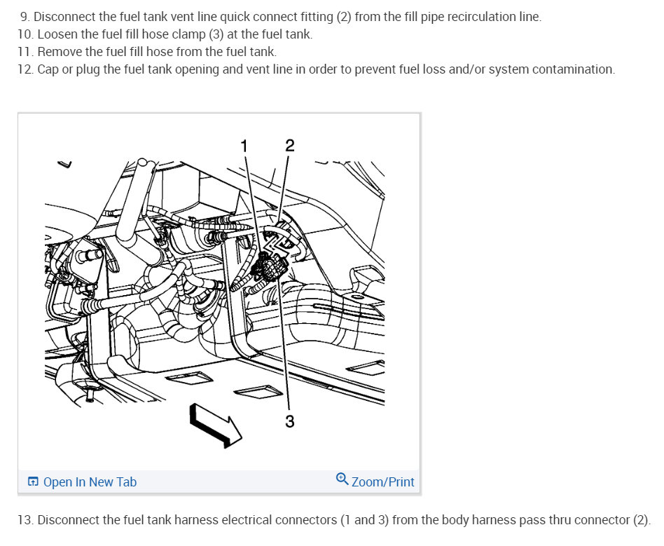

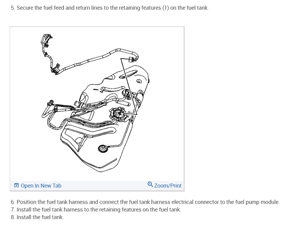

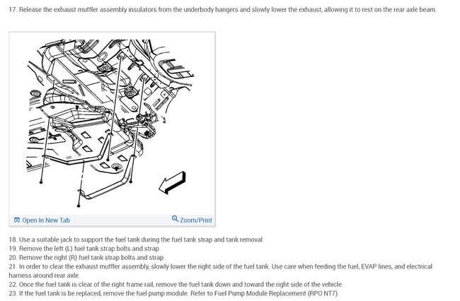

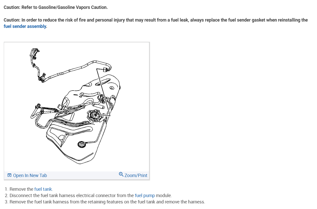

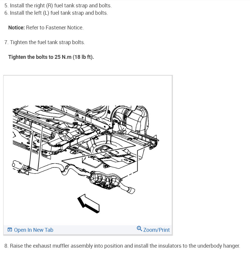

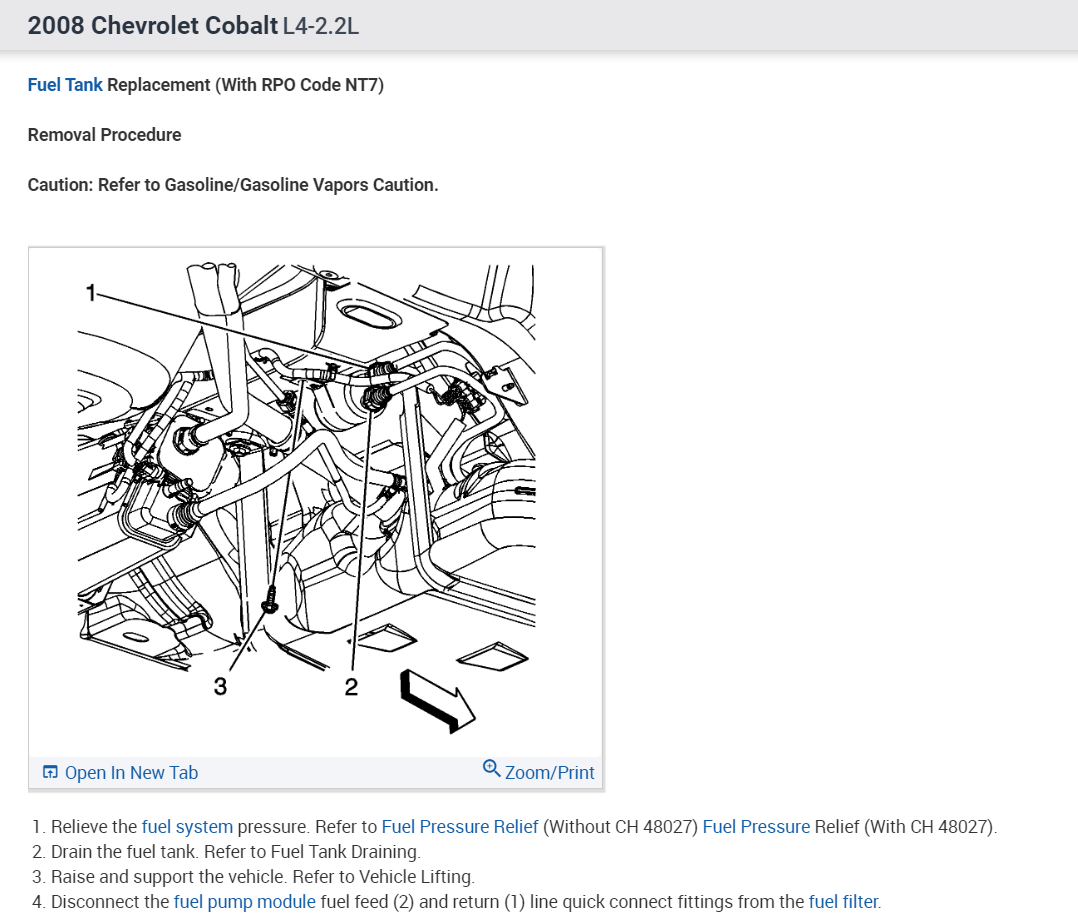

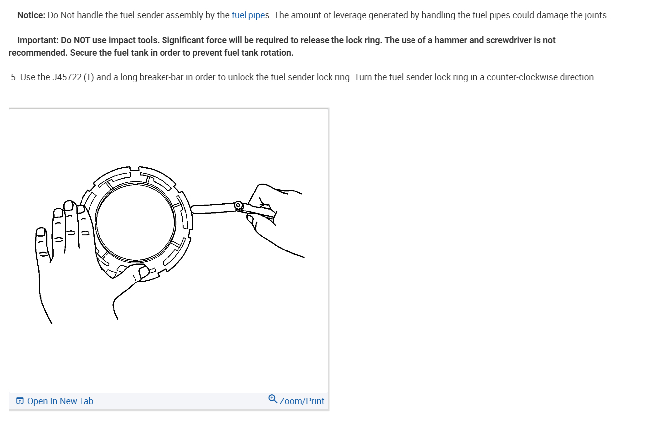

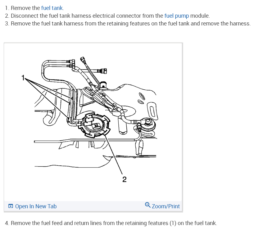

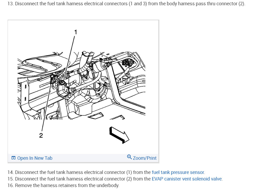

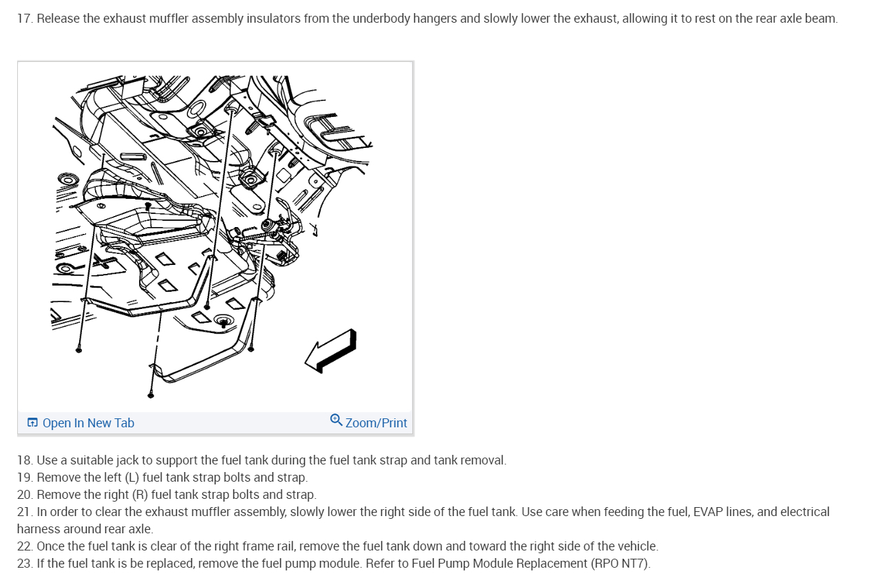

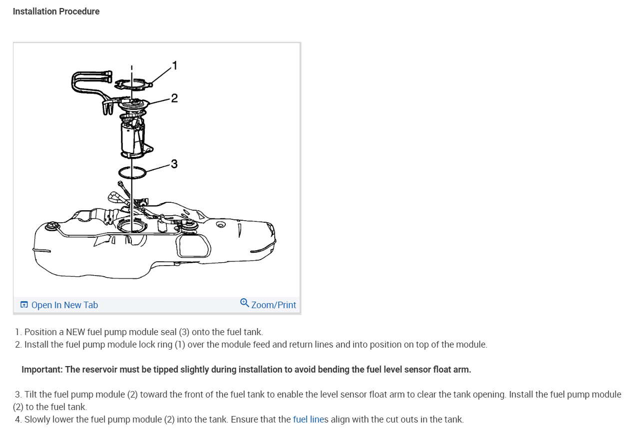

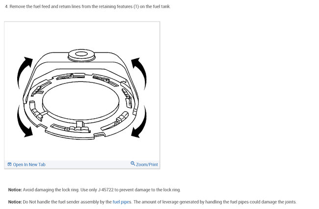

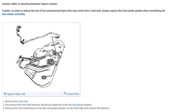

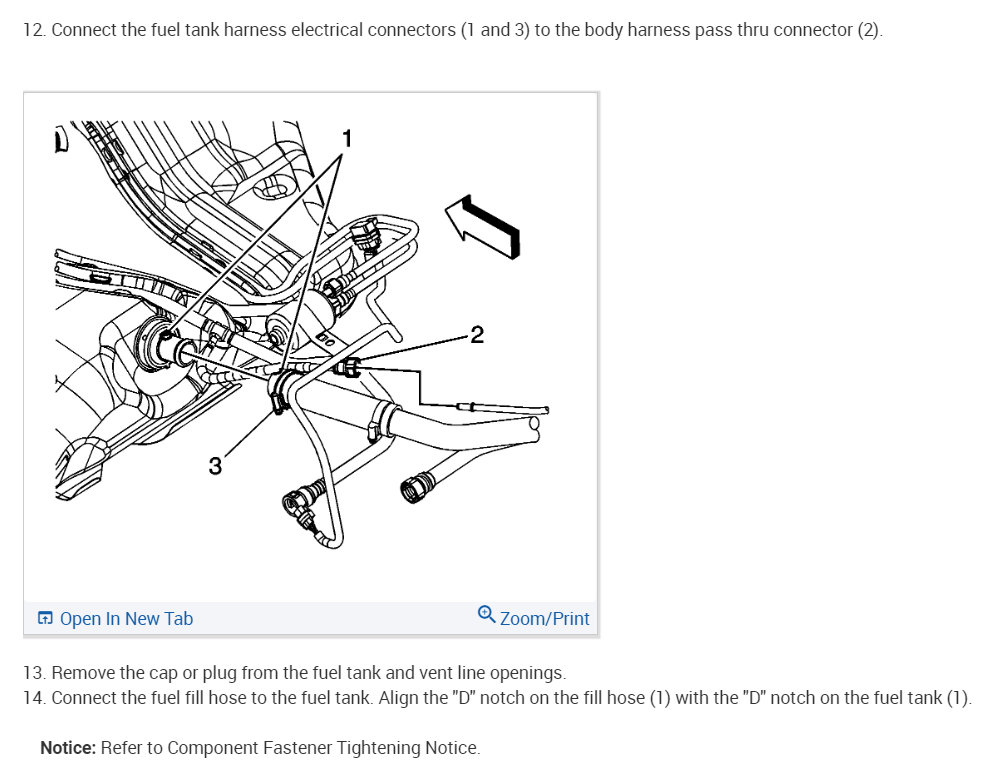

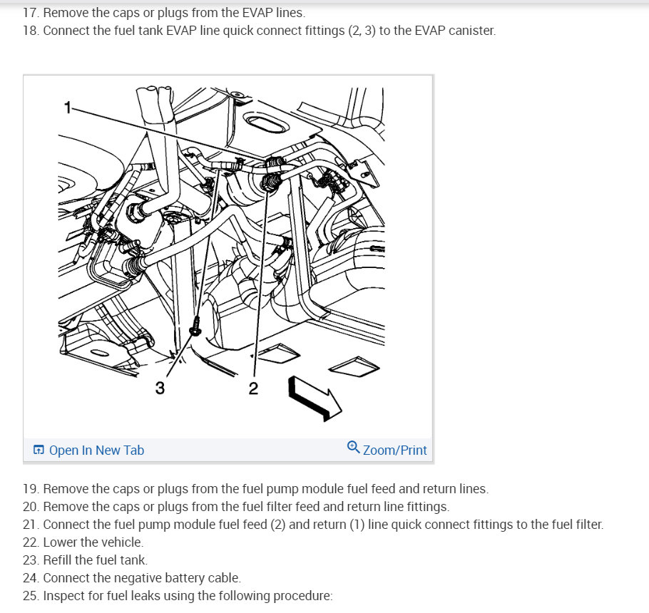

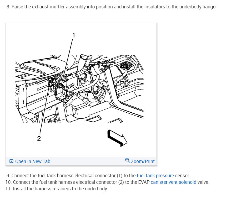

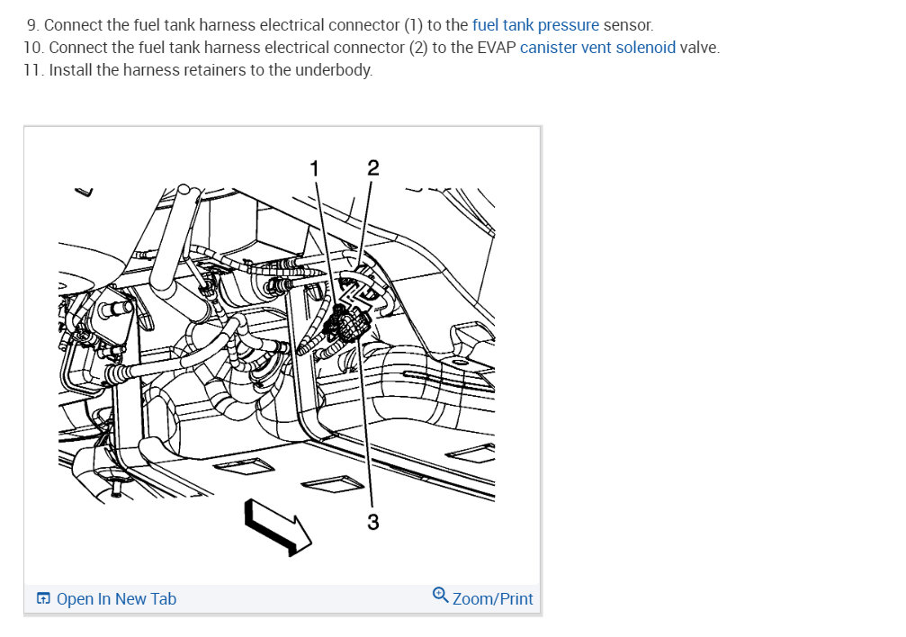

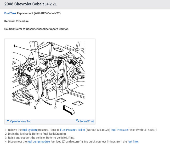

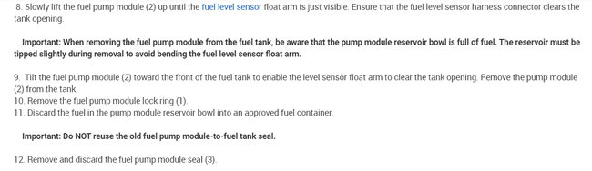

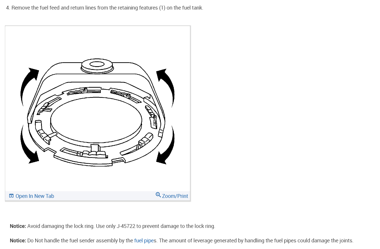

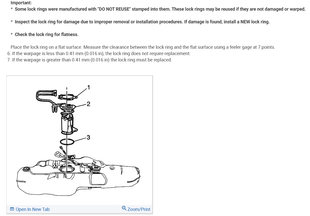

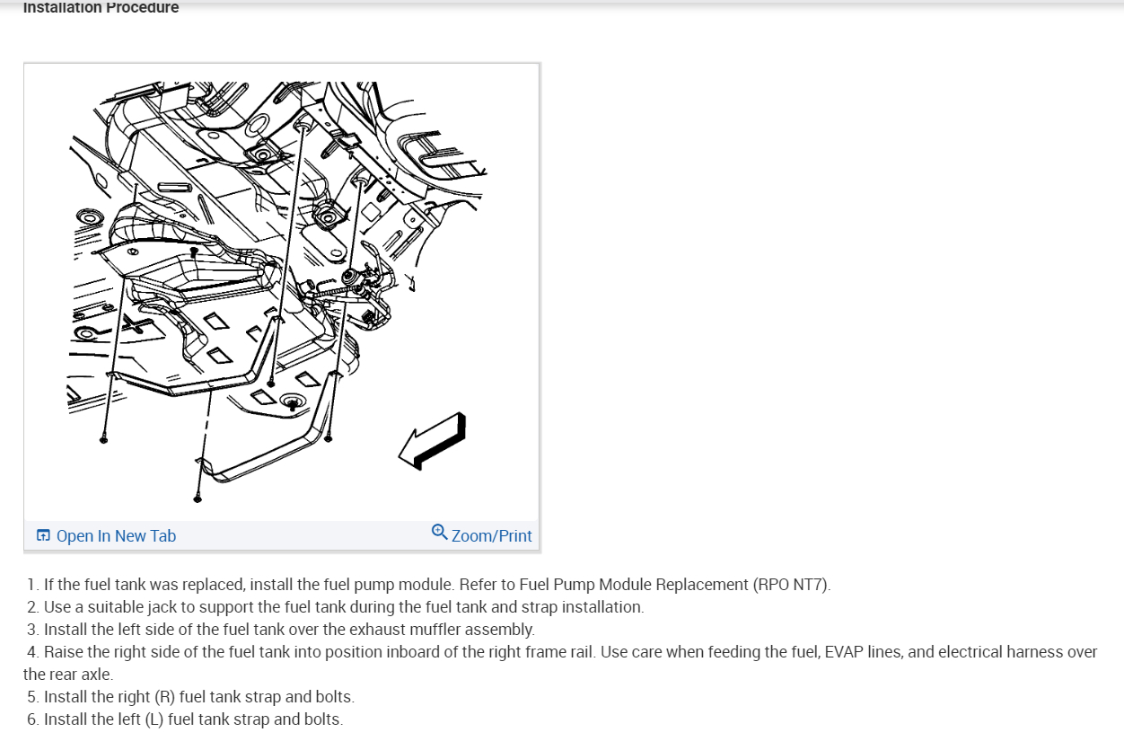

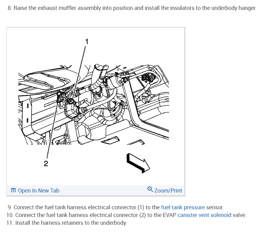

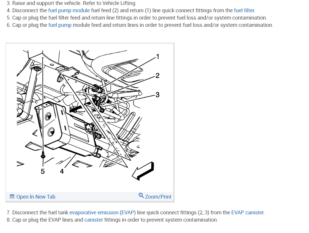

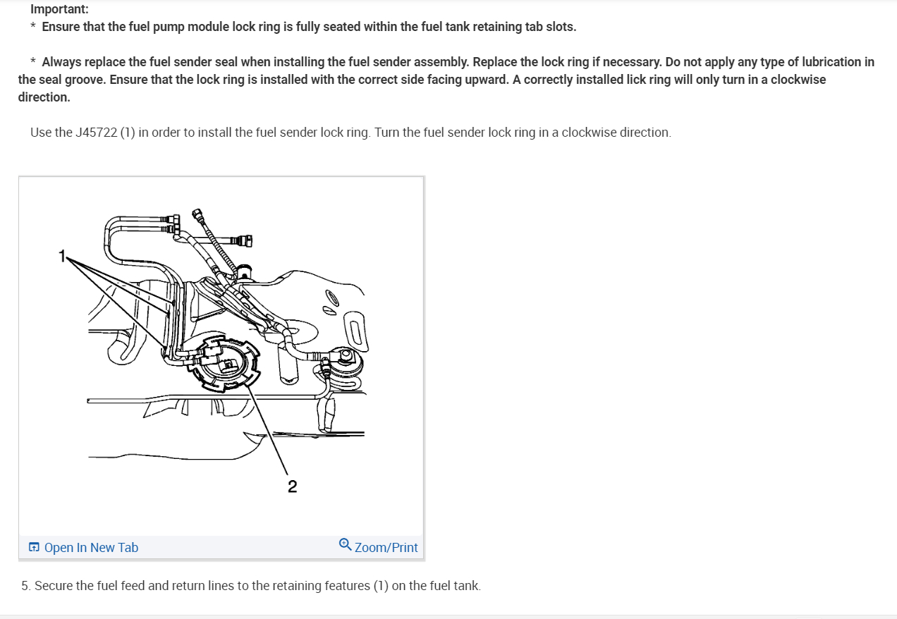

It has gas but you can hear air coming out of the fuel rail, this means something in the tank is not working right like a faulty pump or pickup. I would lower the tank and remove the pump for inspection. Also, when you replaced the pump was it an AC Delco unit? Here are the instructions in the diagrams below. Make sure the fuel lines are connected properly and that they are not smashed between the body and tank. Check out the diagrams (below). Let us know what happens and please upload pictures or videos of the problem.
Jun 14, 2022 at 3:25 AM

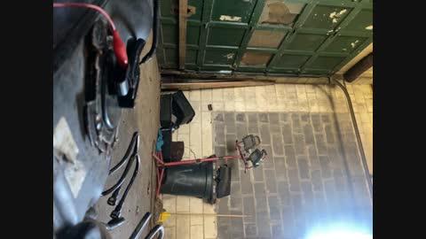

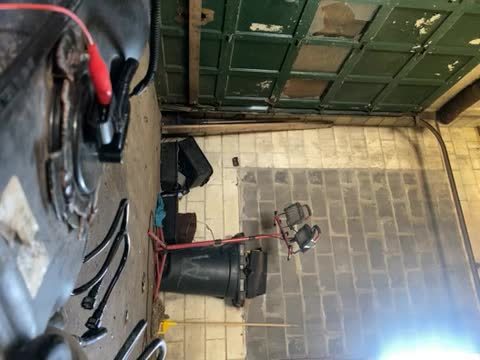

Re-dropped the tank manually powered fuel pump and it’s supplying fuel but once hooked up vehicle cranks, but won’t start.

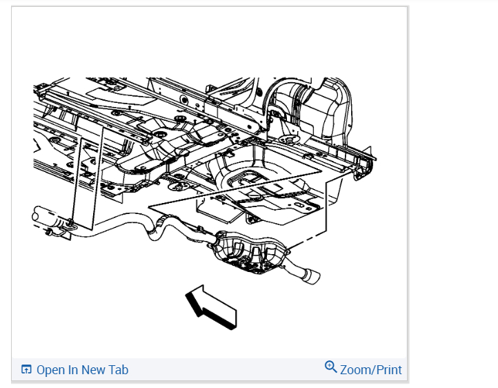

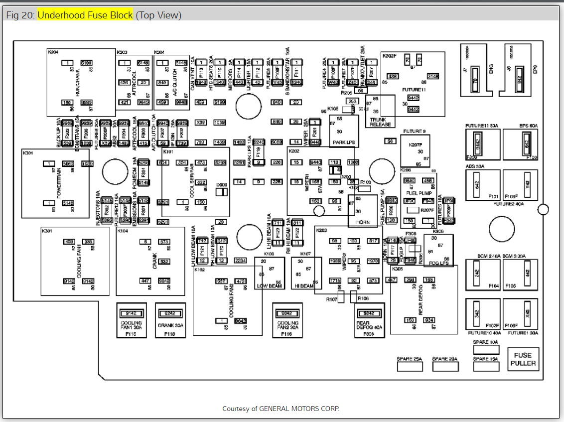

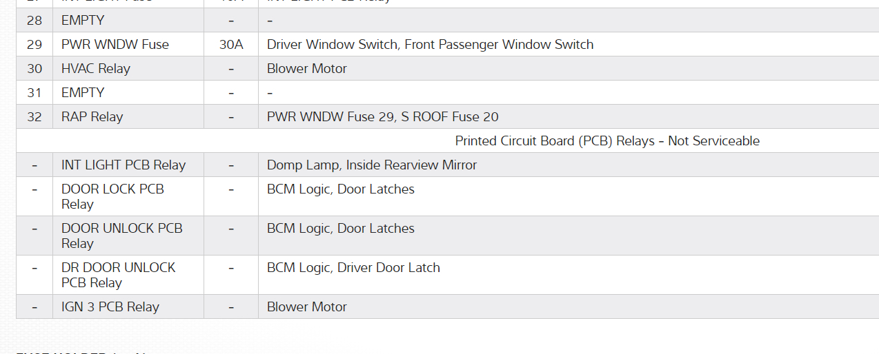

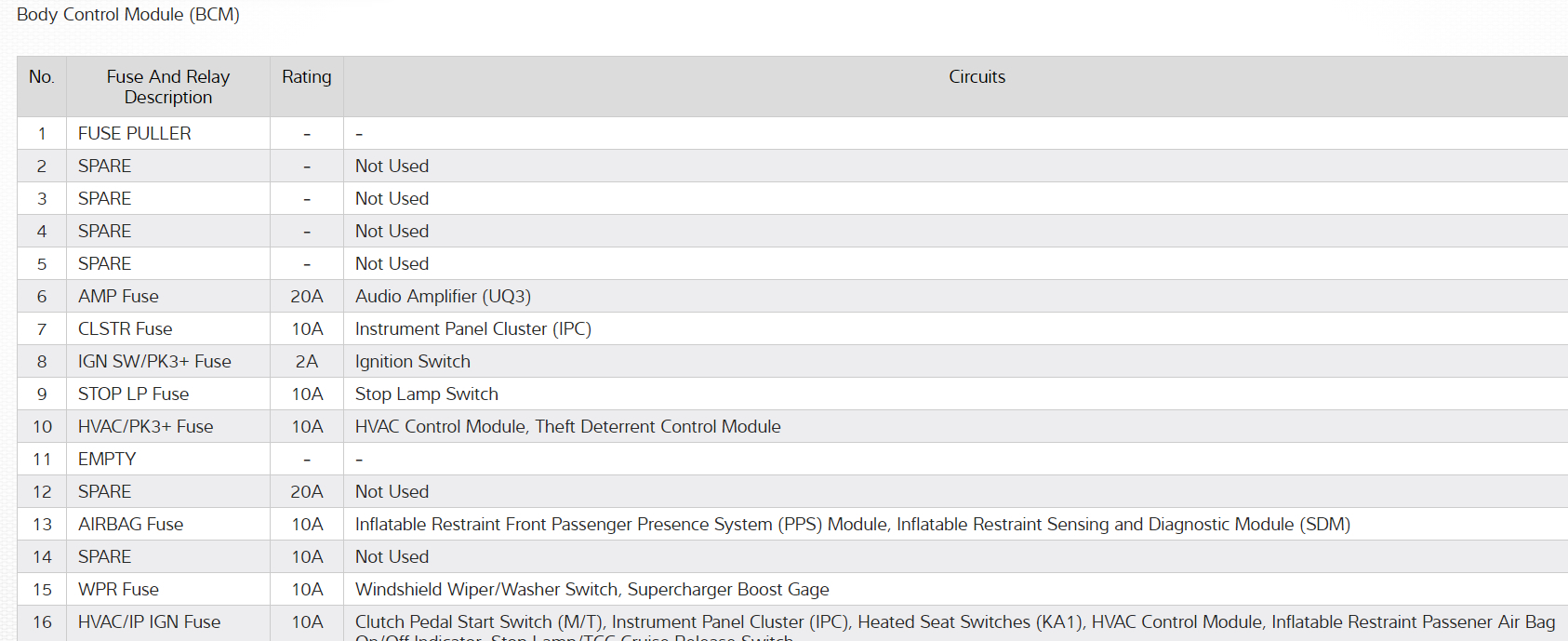

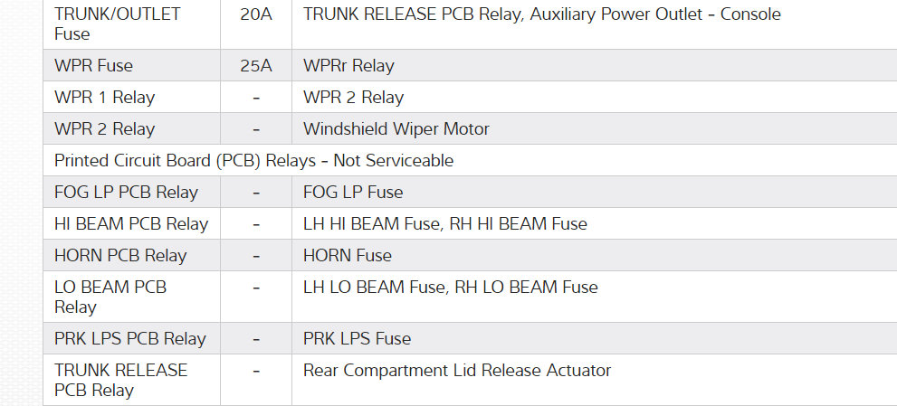

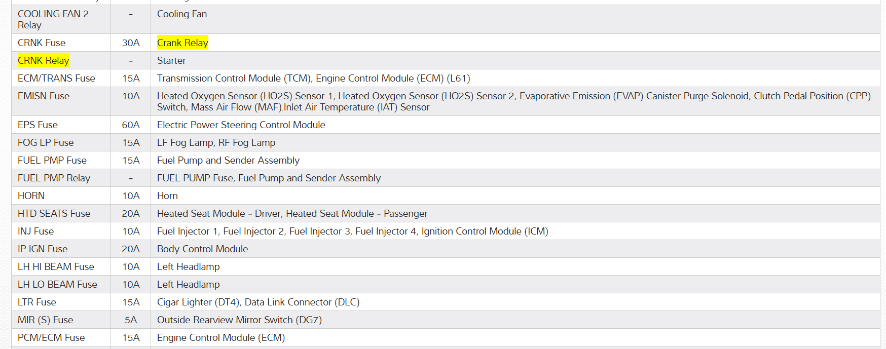

It sounds like the fuel pump relay is out but to be sure this guide can help; I have included the fuel pump relay location in the diagrams below. Check out the diagrams (below). Please let us know what happens.
Jun 20, 2022 at 6:24 AM
