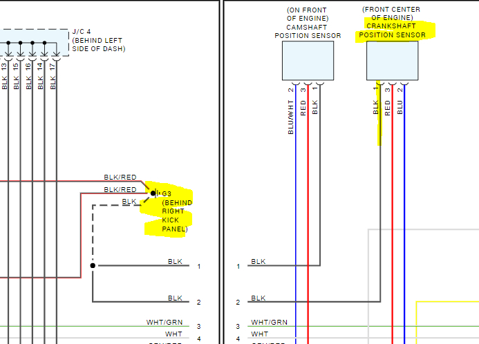

I had a scanner hooked up and was driving collecting wheel speed info on an ABS sensor. The car just suddenly stopped. I took the whole front of the engine off to get to and replace the Cranks position sensor. Once replaced and before putting all the accessories back in I tried to start. Cranks well but no start. Also, the tachometer does not move. I checked the power supply at the sensor, and it has 12v. I also tested continuity on the ground wire, and it was good. The signal wire I didn’t know how to test.
Any ideas? I assume not having the alternator power steering pump off would not make a difference.

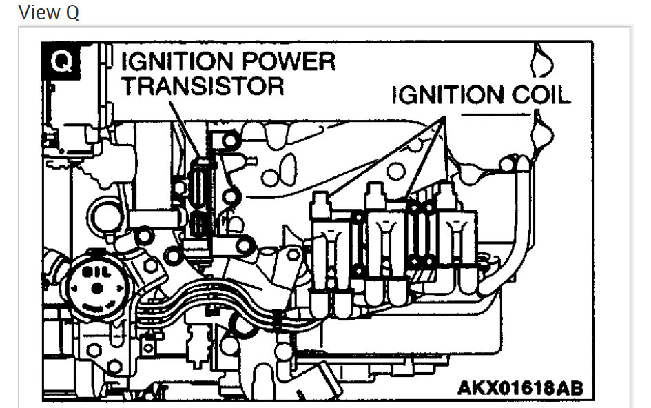

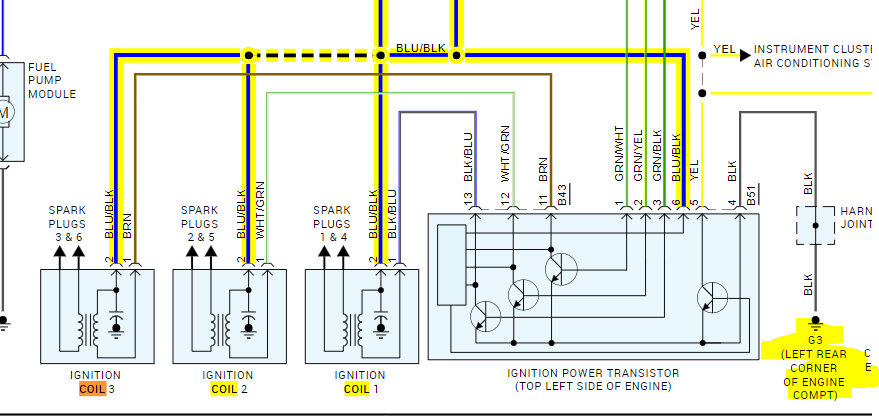

I assume there is no spark at the plugs. So, first, we need to check the ignition coils to confirm they are getting power as well as the ignition power transistor.
If you look below, I attached a couple pictures to help orient you. At each coil there should be a blue wire with a black tracer. With the ignition switch in the run position, check that wire for power. Do the same at the transistor.

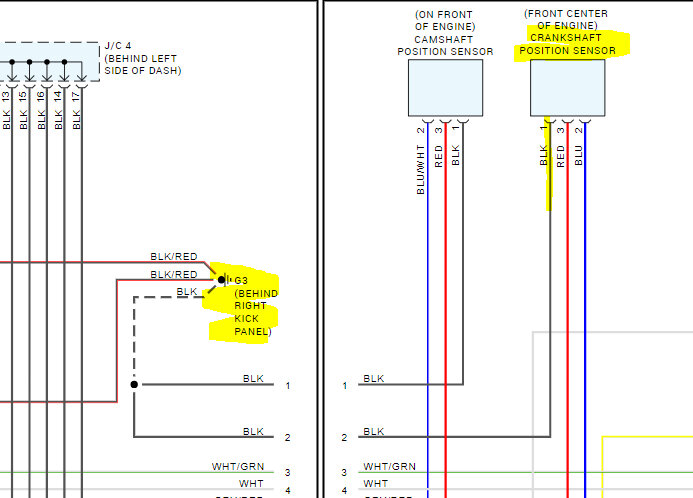

As far as testing the signal wire from the CKP, you need an oscilloscope to identify standard wave form from the signal wire.

Back probed and got 12 V to all coils and the transistor.
I pulled off a plug wire at the coil and had my wife crank and saw no spark.

I suspect something is happening at the crankshaft position sensor. If it isn't sending a signal, there won't be an RPM signal.
At this point, we need to check the CKP signal using an oscilloscope. Since we likely don't have one, we need to recheck the work that was done. Since there is no signal (based on RPM) either the sensor is faulty, it is not close enough to the sensor disc, or we have a broken signal wire.

  • 110,244 POSTS
The two aren't related. Checking the ABS system wouldn't have caused the vehicle to lose spark.

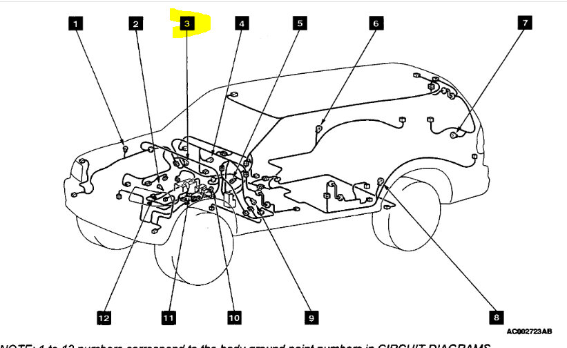

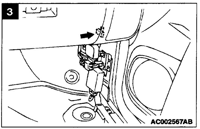

Do me a favor. If you haven't already, check the ground. I realize you have continuity to ground, but the G3 ground is for a few different components. It could be failing under a load.
It is located under the right side of the dash and behind the kick panel. I attached a few pics below to help you locate it.
If the ground is good, we need to confirm continuity via the signal wire. If that wire is good, there is power to the CKP, and there is ground, there is a chance the PCM has failed.

It was the ignition coil transistor not being plugged in completely. I heard a buzzing noise while I had the ignition switch on. I chased it down and it was that transistor being half plugged. Thank you so much for your great help.
